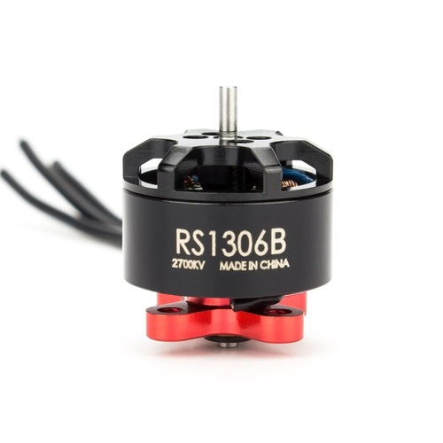

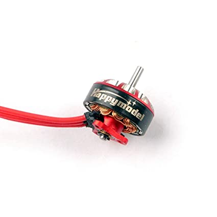

Sure, I would love to dabble in brushless but find me an eESC that doesn't cost 60+ bucks and has availability... it's a tough find. I heard of latency (slowness on trigger pull) with the Talon Castle ESC which makes me not want to dive into one of those..
