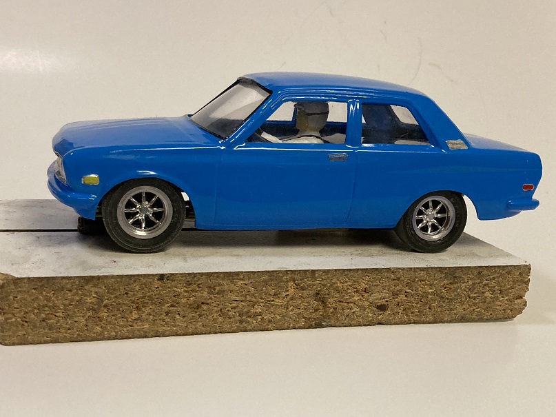

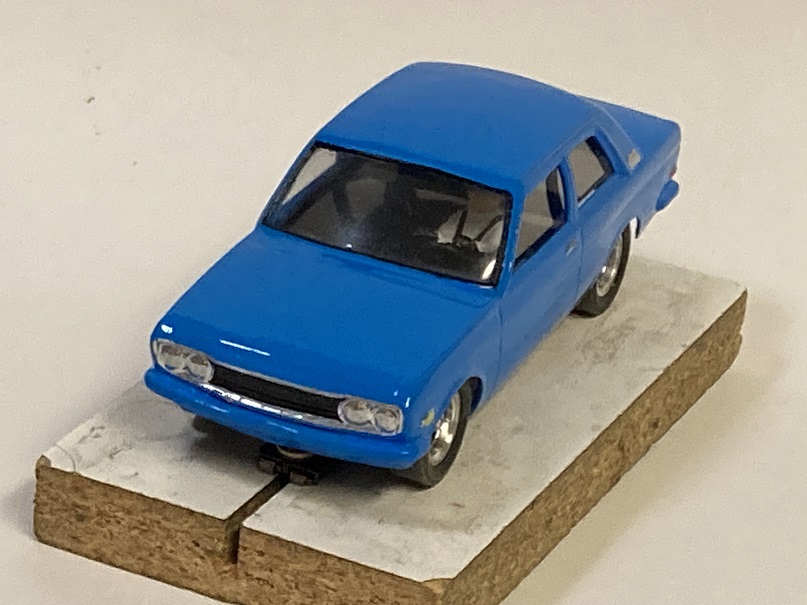

Ernie had a few Datsun 510 bodies 3D printed and was kind enough to give me one.  I made the 1/24 scale body into a slot car.  Thanks, Ernie.
The body is a no fender flare version of the Datsun 510, so I decided to make a neat street car version.

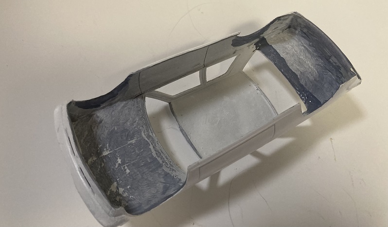

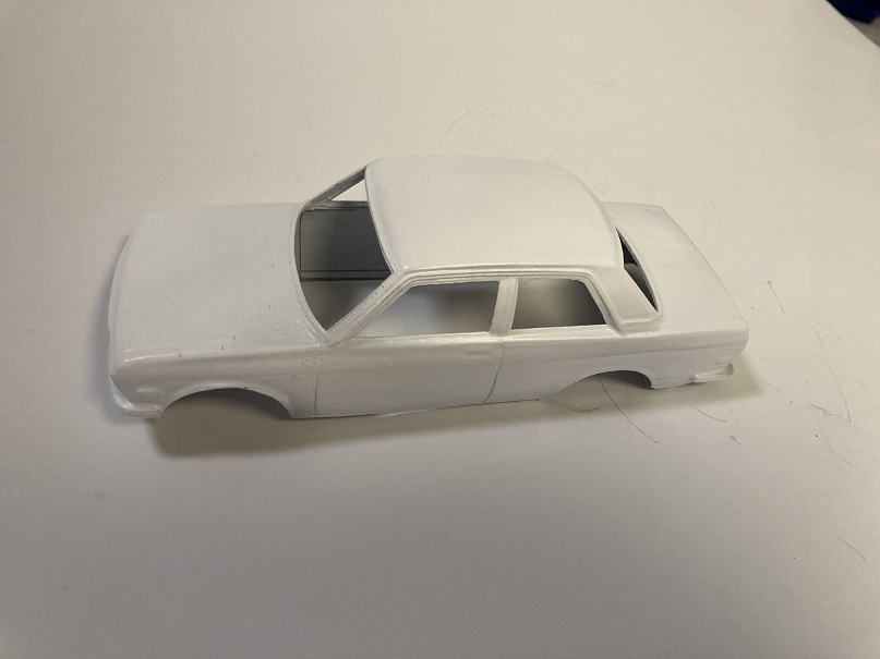

After excess material was sanded off the body, it was covered with about 40 coats of filler primer (let dry between coats) to fill in the fine lines that were on the body.  The body was then sanded smooth.  It is still a little wavy but looks much better.
The body was thinned out.  The trunk area was solid material!
The windows are from junk Lexan stock car bodies.  The driver figure is Champion.  Set screw wheels and wheel inserts are Russkit.
Tires are urethane.
The chassis is a modified Pactra "1/24th COMPETITION".  A home rewound 26D motor is used along with a Cox "reverse guide".

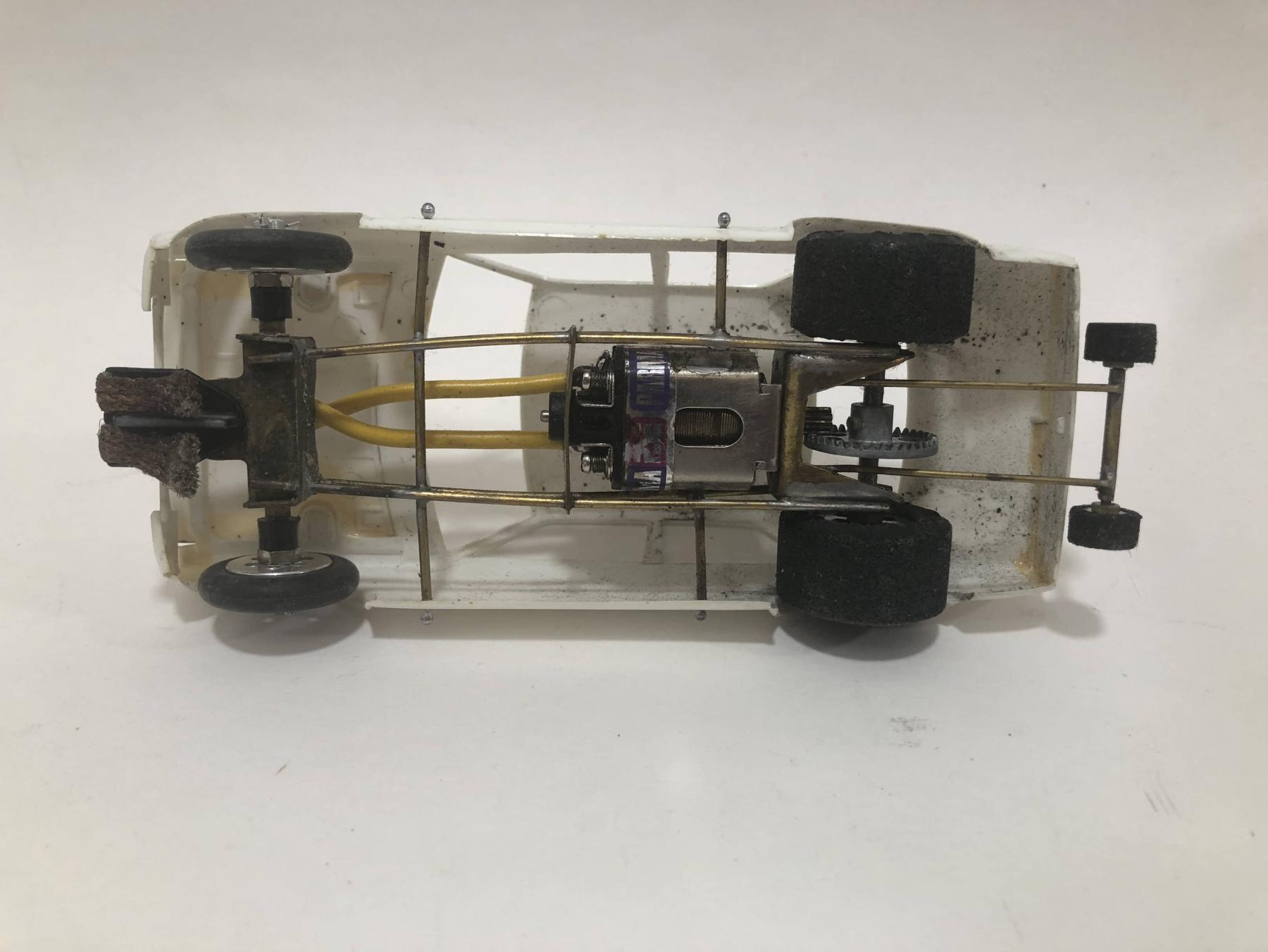

Hmmm, a Datsun 510 on a  Pactra chassis?
I've seen that somewhere before.

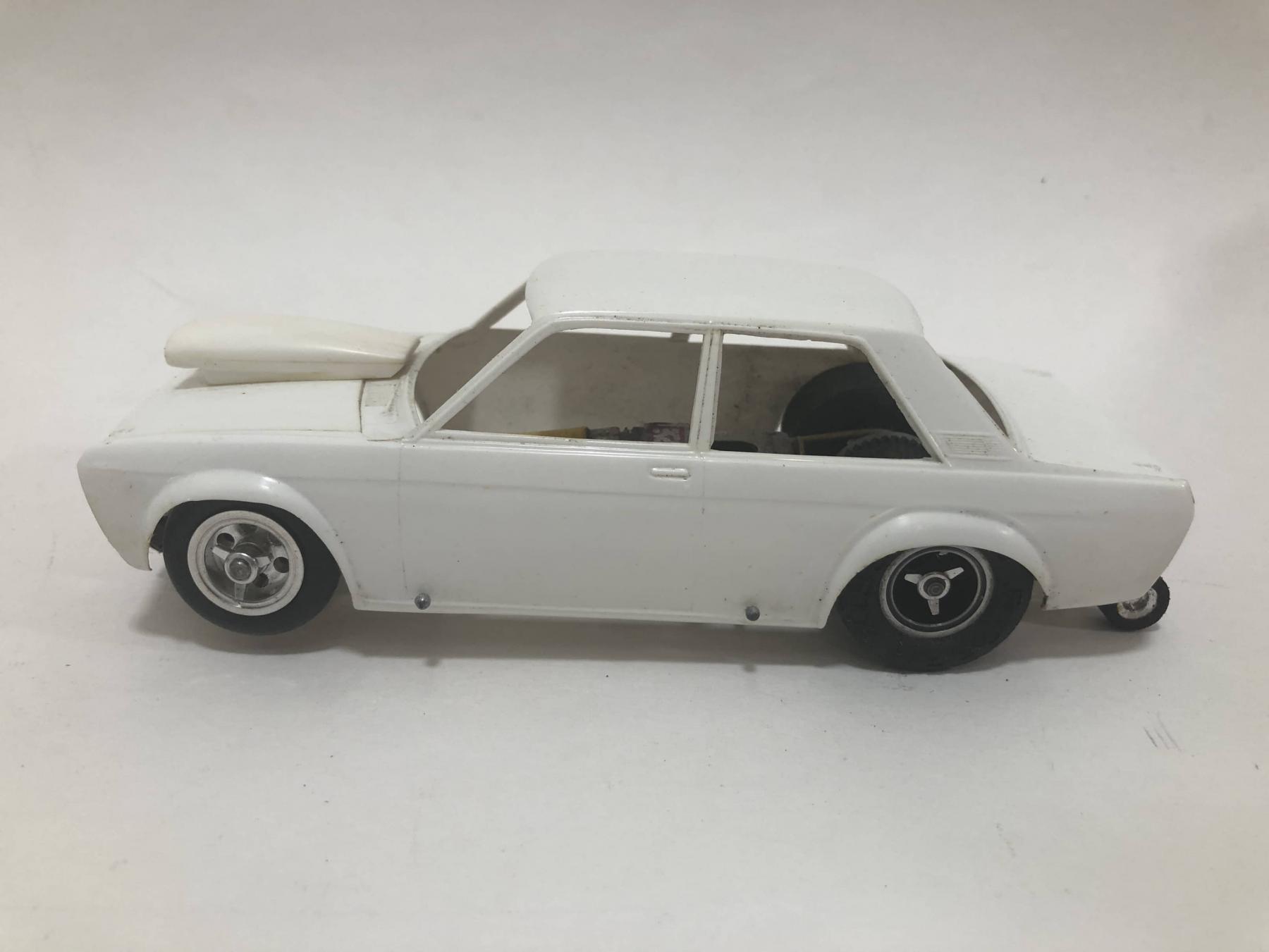

Actually not full Pactra chassis but uses some Pactra/Competition Bits.
Another unfinished project from the vault.
This is a vintage Revell BRE 510 body.
The body is 1/25 and it's pretty tiny.
This thing flies down the track but holds the track like crap.
Wheelie wheels are Cobramite HO wheels.
Suppose I'll finish it someday.
