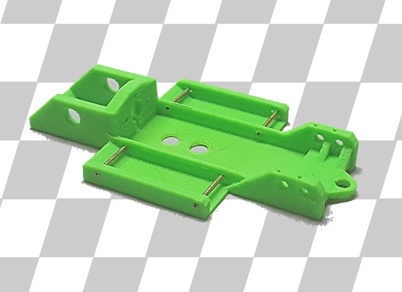

Our 1/32 womp style chassis is 3d printed using filament as opposed to resin. There has been some success with them. Usually with home or club tracks. The obvious weak point is the guide tongue. 1/16 tubing allows for mounting the body.

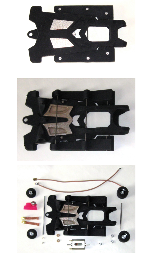

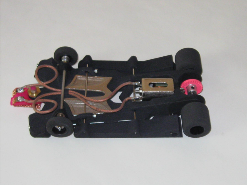

About ten years ago Rapid Slot offered this 1/24th scale printed chassis. The full report can be found in the General Technical forum under Rapid Slot 3-D chassis.

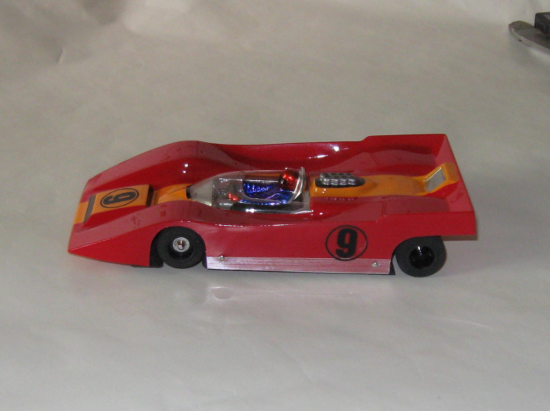

I used a Parma 1043 Ti-22 body, and ran it with the retro Can-Ams.

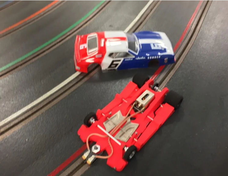

I have another Rapidslot chassis I intended to raise the rear axle bushing holes so that the chassis could use the 5/8ths inch diameter hub wheels and tires from H & R or Pro-Tracks. Wouldn't be difficult at all. The designer of the chassis, Steve Grider ( Mr. Horsepower here ) built one with a trans-am body, and it looked pretty good.
He also designed a chassis to use with the Chicagoland Raceway hot rod class we had so much fun with. It wasn't quite up to running with the scratch built wire and brass chassis we had been using, but fun
none-the-less.
The problem is Shapeways filed for bankruptcy and are going through a re-organization. I'm not sure if they are filling orders right now.
