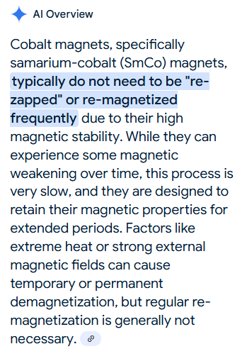

I found this information about how well Cobolt magnets retain magnetism
