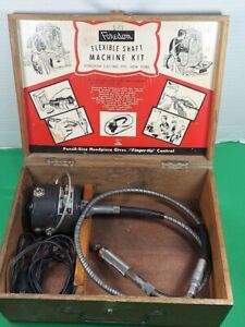

This tool was used by a friend of mine who is a jeweler.
Rotary tool with hand piece. It is one speed.
I am asking $60 for what you see here in the pic.(D)
5% going to slotblog.
P.M. if you have questions, thanks for looking.

They make retrofit speed controls for these.

Foredom makes superb foot speed controllers;
And I highly recommend getting a profiler to go with it. Makes all the hand filing and polishing a breeze;
I used this model from Artco;
This model from NSK is cheaper, but is slower to work with. But it is lighter and easier to manipulate;
In any event, I recommend getting a spare flex shaft. They have a habit of kinking if you overload the stone or burr. Saves the aggravation of having to wait for a replacement to be shipped. They are around $ 30-40 for the shaft and sheath.

any idea what a close to mint condition one of these in it's original case with all the paperwork and accessories would be worth?
#8 Dave Crevie
  • 4,698 posts
Posted Yesterday, 08:53 AM
The prices are all over the map;
From about $100 for a well used one, (this one has no shaft);
To $200+ for a new one;
Incedently, the new Fordoms are made in China. The best thing is to go to some machinery auctions where you can look the unit over.
