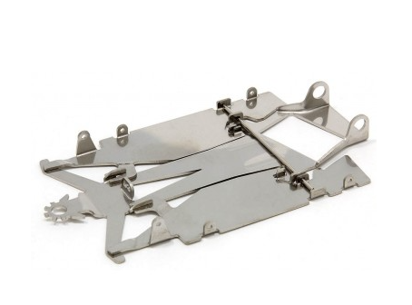

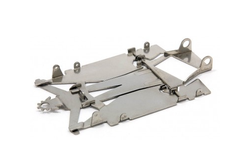

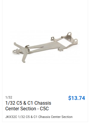

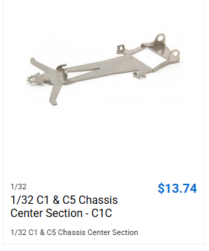

The C-1C and C-5C center sections are not the same.
Since there is no difference visually, my guess is that the material thickness is different. The JKX32C is the original center section used in the RTR cars and the chassis kits, and should be 1mm thick.. JK could have done a better job of describing the differences in their catalogue.
The front axle mounts to the pans, so that doesn't effect the choice of center section.

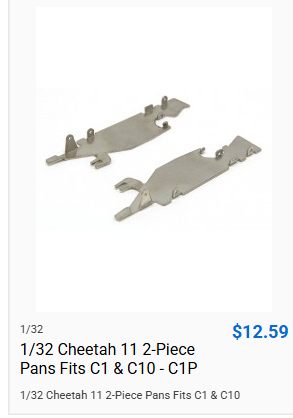

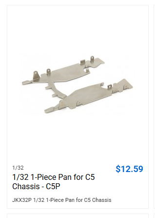

One piece pans;
Two piece pans;
