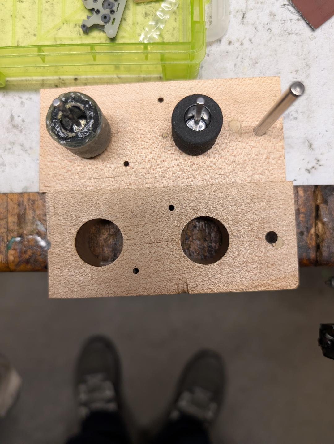

Our good friend Billy G. Patterson even went as far as crafting his own mold out of wood to try and coat the tires. He used some sort of wood wax as a mold release argent. He got darn close to making it work and given a few more tries I think he could have. Billy G. Is one of those people you meet and you feel like you wished you’d have known him all your life. He is a competitive gearhead from go. He will be 90 in September and is still playing table tennis.
Along with not allowing glue on the track, I think another mistake we made as hobbyists was not limiting the weight of the cars to 45 grams. It would have been so much easier on the tracks and and along with no glue the horsepower requirements would have been greatly reduced. Eventually I think we would still have hit 2.0 second laps as well for air control would have been a more obvious advancement. I remember discussing with Jon Laster that if you are going to use air control, the mass has to come out of the cars. He didn’t buy it then.
I wonder how "silongies" would work with magnetic braid, car magnets and a clean track? Jim seems to know.

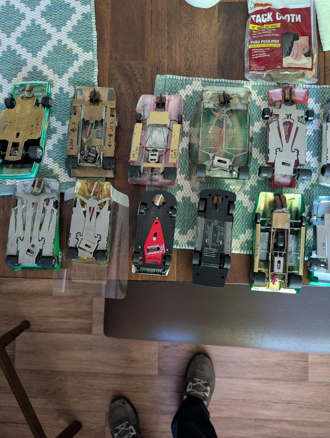

Some pics of the experiments.
Bill G's mold.
