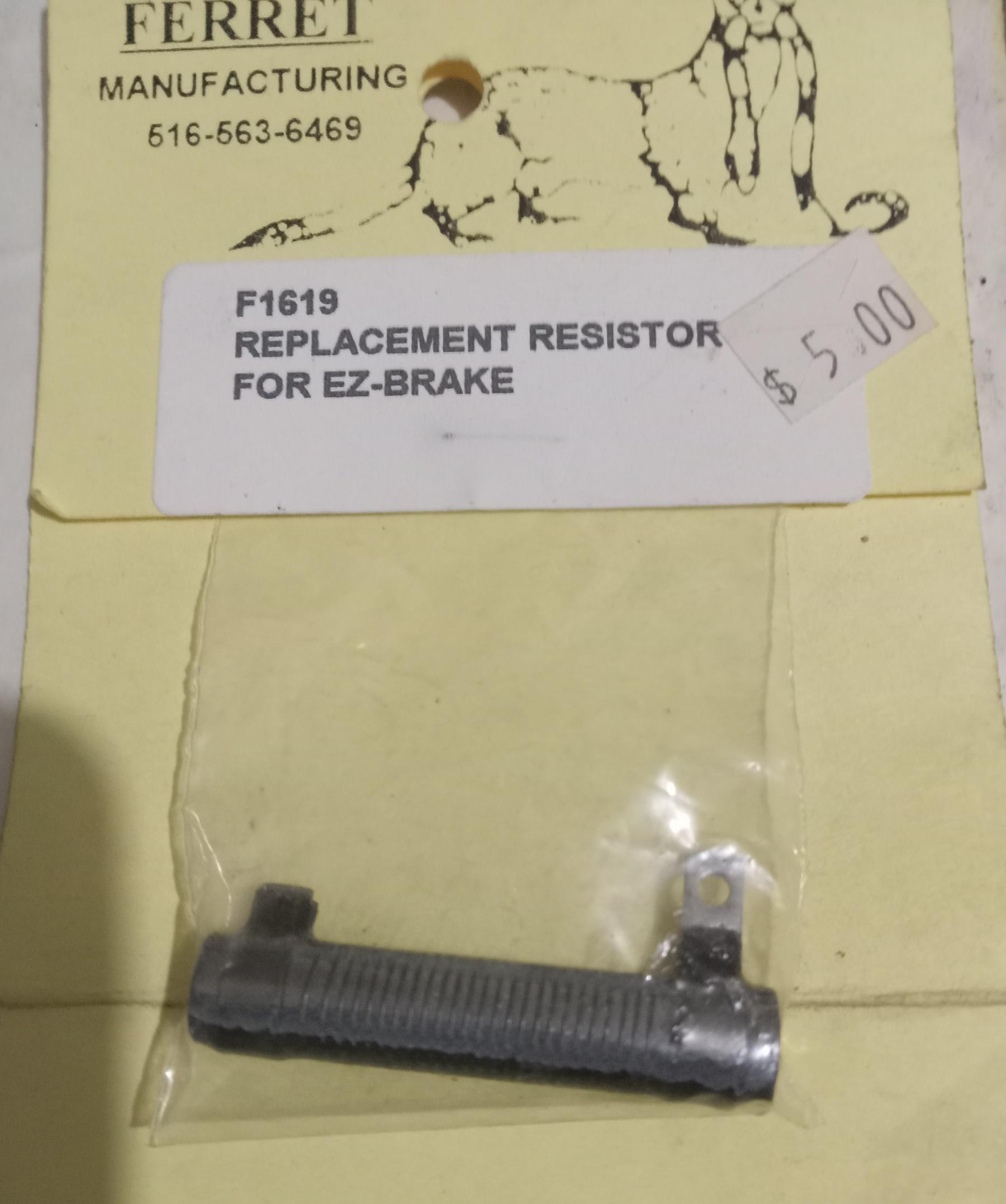

I found this in the bottom of a box of neat stuff. No idea how it is attached or how it works. It would make a great external resistor controller although I doubt it would work.
Anyone?

On non-electronic controllers using resistor or diodes for dropping the voltage, you insert a brake resistor between the red post and red alligator clip. The resistor can be variable to adjust braking. Not sure how this one was implemented, but that is the concept.
Chris McCarty

That looks to be a version of my idea decades ago to add adjustable brakes to a Parma resistor controller. Mine was a circuit board with resistance wire wrapped around it and a slide to change brake resistance. Mine was mounted to the top barrel of a Parma resistor.
Ferret even ripped off the name of my product, EZ brake.

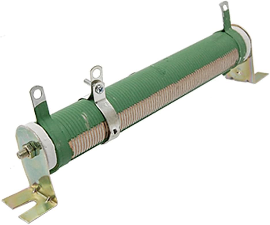

This image is of a variable resistor.
So you see the metal ring around the resistor? Attach one wire there, and the other to one end. Move the ring, and you vary the resistance.
I don't think you can use your pictured resistor effectively as an external resistor in a controller as we used to use 100W resistors for that, and the one pictured doesn't look to be that large. I mean, you could use it, but if it's only like 25w you'll smoke it with most any modern motor.

The Ferret resistor kits were used a lot locally on Parma controllers in the mid-90s. Most
external resistor controllers I saw were for wing car racing, thus the need for 100W
resistors.

That resistor looks to be the size of a commercial 12-watt adjustable wire-wound resistor. As mentioned already, external throttle resistors were at least 100-watt, so that wouldn't be good for that.

It was just a thought, but a 100wat that size would be something.
So, one Wire to the post,the other on a slider ?

Mark, correct. A slider to vary the ohms. Is the resistor marked with an ohm value? My guess would be 10 ohms.

That would be no good for an external resistor controller. Those resistors were huge. I searched Ferret ez-brake and got something entirely different from slot racing.

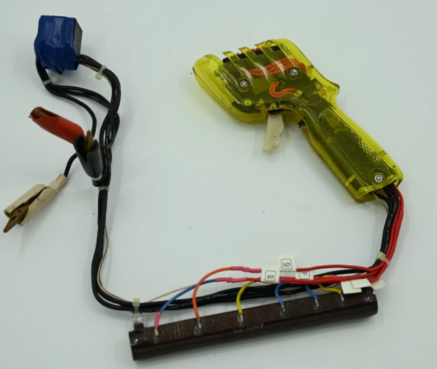

This was a typical external resistor controller;
They used a switch block in conjunction with the trigger wiper.
#11 Bill from NH
  • 14,992 posts
Posted 10 July 2025 - 02:31 PM
I have a controller similar to that in the post #11 that I used in the '70s to run open class wing cars on a battery-powered original King. It uses a contact block with the Parma trigger assembly. Mine has a nichrome wire 1 ohm resistor wound on a Parma double tube ceramic core. I think it has 6 taps. This resistor is mounted in a small metal work box attached to the controller cables about 30" down from the handle. The parts & wiring were sold as a kit by Maury Bodeau, a CT semi-pro racer.
#12 Mark Onofri
  • 2,633 posts
Posted 10 July 2025 - 07:10 PM
Dave, I've got a few like that and, a newer Parma version with a much smaller resistor. That's why it would be nice if the Ferret would work. It's even smaller than the Parma but, I know it won't.

Posted 10 July 2025 - 10:02 PM
I had one of those controllers in the mid 70's. It was branded as an "Ice Box". I bought it used, and it was as you describe but the resistor was .6 ohm.

#15 Dave Crevie
  • 4,879 posts
Posted 11 July 2025 - 08:25 AM
I had three. One with the six segment contact block. Then Jerry Kulich came out with a ten segment block, and I built two more. One for wings, and one for Eurosport. I was never much for wing cars, so guys were forever borrowing that controller for their wing car races. Did well with it. I was going to build one with a relay, but got deeper into vintage big car racing and dropped out of slot cars.
The trouble with these controllers was that you had to continuously clean the contacts.

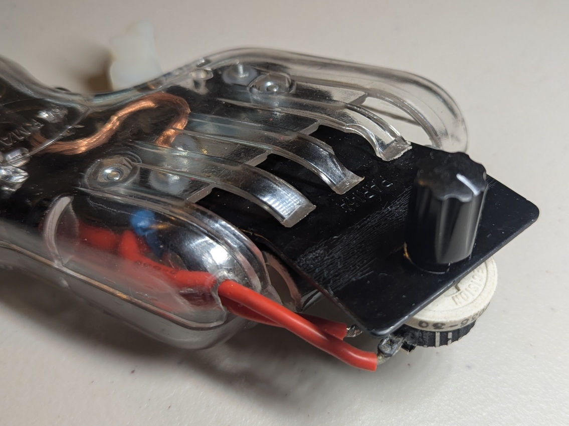

I just bend the resistor cover up, drill a hole, and add a 5 ohm 25 watt variable to the brake lead.  Works great.

Jim, I just read the fine print in your reply. I'll check the ohm resistance later today.
