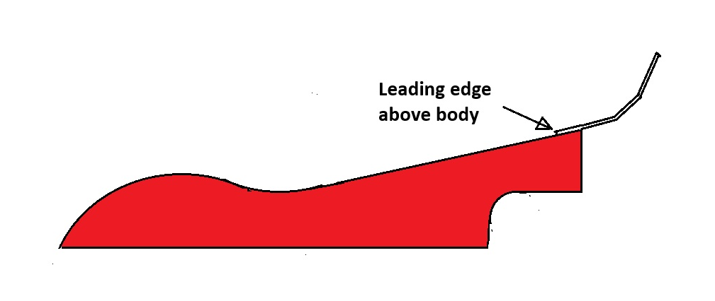

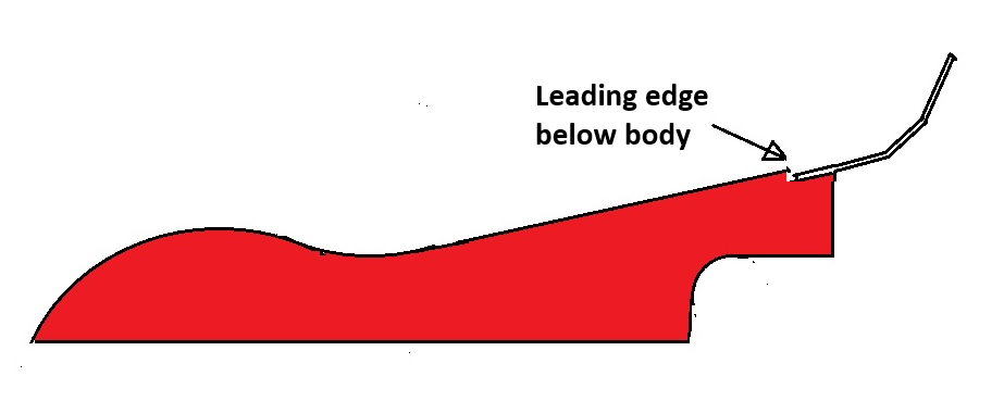

From an aerodynamics standpoint, it should be better to mount the spoiler inside the body. This puts the leading edge of the spoiler out of the airstream, where it could create eddies or other disruptions to the airflow.
Mounting the spoiler inside the body takes the leading edge out of the airflow.
If you mount the spoiler inside, you loose some of the support the body supplies. So you have to use good double-sticky tape along with the staples.
In the real world, I doubt that it makes any real difference. I always mounted the spoilers inside with 3-M carpet tape. Worked best for me, but I am not a serious wing car racer.

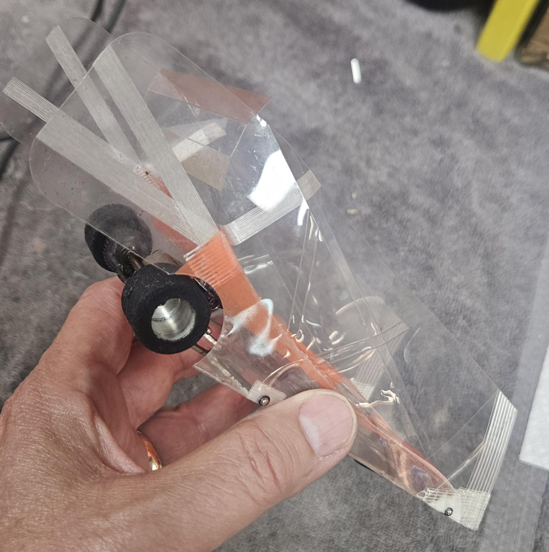

Here's a state of the art wing body kitted by Michael Iga.
The spoiler is on the bottom.
  • NSwanberg, Roy Lievanos and Dave_12 like this
Really does not look very much different than the bodies we were doing in the mid '90's. Except for the dimples of course.
  • Dave_12 likes this

Look at the creases in the side dams.
#9 grooverunner
grooverunner
  • 156 posts
  • Joined: 10-December 15
Posted 22 July 2025 - 08:42 PM
Mike,I noticed the creases on the side dams. What is the reason for them?
Ken  Hill
#10 Dominator
Dominator
  • 3,000 posts
  • Joined: 19-September 07
Posted 22 July 2025 - 09:25 PM
The creases add rigidity to the side dams which allows a thinner dam to be used. I think some are using .003 or .004? After talking to a few guys at the world's i think the bodies weigh in around 6.5 grams.
