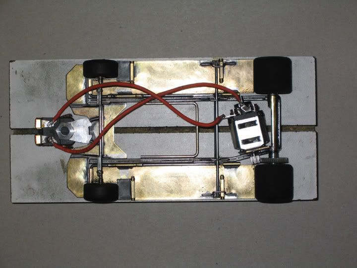

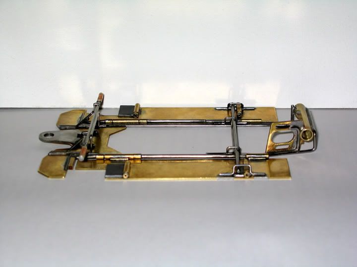

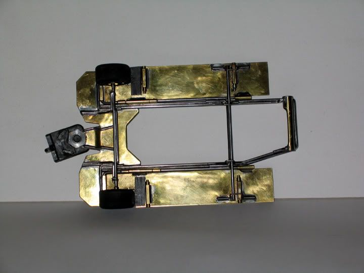

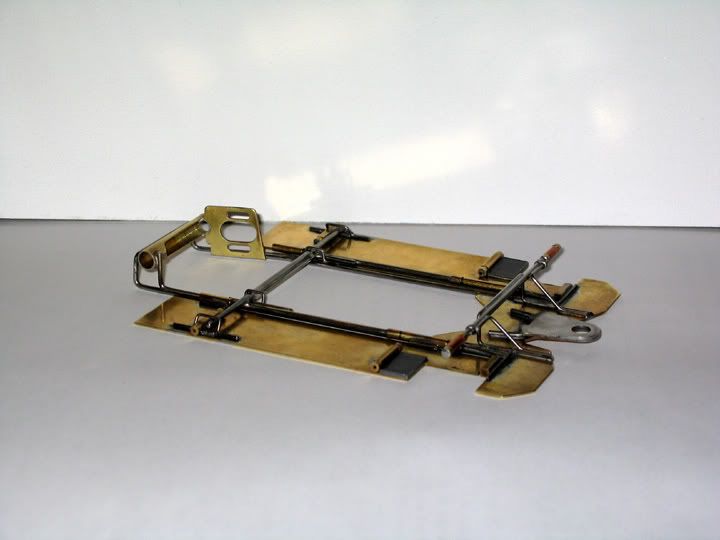

#5 KenMiles
KenMiles
  • 1,057 posts
  • Joined: 28-May 06
  • Location:Desert Hot Springs, CA
Posted 03 November 2006 - 09:26 PM
Hi, Racers,
I missed racing in Tore's enduro Saturday, October 28, but was there to witness the race. For those of you who haven't heard, Tore won. But the bigger story was the high attrition rate of the new Pro Slot Euro Mk1 (#4002). These motors were specially prepared for the enduro by Pro Slot, re-trued and re-balanced but otherwise identical to Pro Slot's #4002. I believe there were altogether eight failures within four teams, four burnt in practice and four during the race. Philippe de Lespinay will have one of his exemplary race reports ready soon.
I received two Euro Mk1s myself, identical to the motors sent for the enduro. I'd probably have bought a couple from BPR except that I never saw them on BPR's shelves. The size is identical to the FK, but otherwise resembles a miniature 'C' can. I did notice one motor became really hot as I spun it to dress the cut down shafts. Worrysome. :| Note the ears on the mount plate.
A top view illustrates a motor fit problem. If I cut the tube so that the face of the plate may extend rearward, too little surface of the tube remains to get a sound solder joint. I hadn't anticipated the ears as I built two chassis using a traditional axle tube. Pillow blocks would be nice, but remember, these are 13/16" rear tires. No pillow blocks are readily available for 13/16" diameter tires.
The solution was adding a bracket, this one cannabalized from a Parma International 32 brass chassis. The bracket provides a structural tie from the post to the axle tube.
A view from the inside face of the motor bracket shows where the motor ear would extend.
Of the conditions I hope make a difference (from the enduro) is break-in. I will seat the brushes at least 20 minutes at 3.5 volts in air, conventional. Then I will check the track conditions for the state of glue, as this has proven important with the FK motors.
One thing that will help. The chassis as shown weighed in at 96 grams with a 'C' can motor. It will certainly weigh in lighter with the Mk1. Earlier testing with a G12 motor was a handful except on the Gerding King. The speed of the Pro Slot motor is very similar to the S 7, even the gearing - so handling should be a blast!

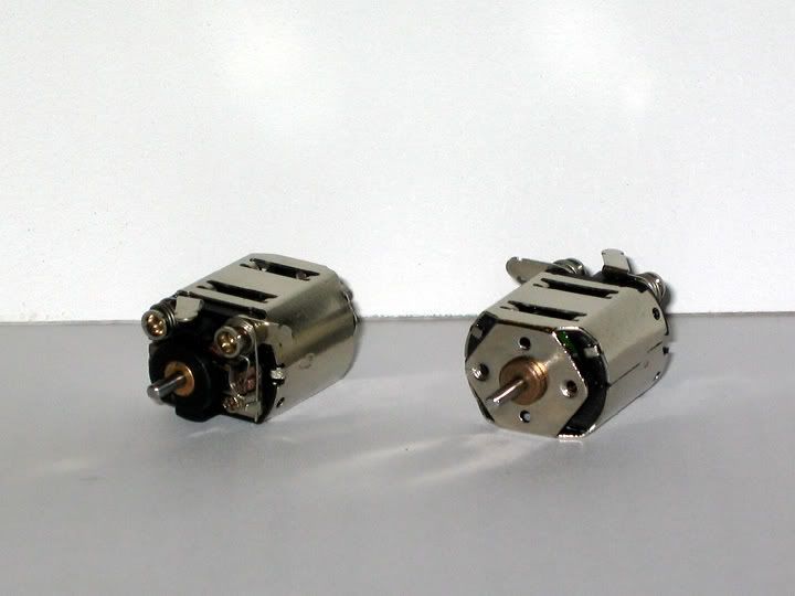

#6 Slotgeezer
Slotgeezer
  • 2,090 posts
  • Joined: 09-June 06
  • Location:Fullerton, CA
Posted 04 November 2006 - 12:42 AM
I wasn't too happy about the location of the "ears" with the 2mm mounting screw holes, either, Allen . . . :roll:
They were rapidly dispatched courtesty of my Dremel tool . . . :mrgreen:
Oh, no can cutting, you say?. . . I say hogwash . . . why carry extra weight when it's unnecessary. . . we hack-up our chassis to lighten them, and it was common-place to "notch" the "A", "B", & "C"-can motors to clear the rear axle, so removing the 2mm mountings tabs can't bother the overall motor performance, at least if you remember to blow the chips out of the motor, before you run it! :lol: . . . removing the tabs won't alter performance, just make it easier to get the motor close to the axle tube . . .
I opened my motor up, so I could look at the "innards". . . . I drilled and tapped the endbell for 0-80 hardware, to hold everything together . . . Then I aligned the brush hoods, re-set the end-play, put it in my Toytech Lola GT, and began experimenting with gearing . . . it ran good geared 13-43, and 12-40, 64-pitch, but I'm still looking for a little LESS heat, on the King track . . . next ratio to try is 14-50, 80-pitch . . . total weight of car is 108 grams, so it's not a boat-anchor, by any means . . . runs cooler, on the Hillclimb . . . fun to drive . . .
I like this motor. . . it's quick, has good top-end, and excellent "punch" . . . I feel it'll make a great motor for our new GT Retro-winder class, coming in '07 . . . Take care, Allen! . . . My 2 cents worth . . . your mileage may vary . . . ;) . . . Good racing! :)

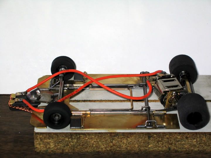

#17 KenMiles
KenMiles
  • 1,057 posts
  • Joined: 28-May 06
Posted 27 November 2006 - 05:38 PM
Tested my GT coupe Retro-winder with 80-pitch gearing this afternoon at BP Raceway . . . King track . . . battery power . . . no charger or power supplies on-line . . .
Geared 14-49, 80-pitch, the car ran great . . . great accelleration . . . good brakes, so much so I had to switch-in a 1 ohm, 1 watt resistor into the brake lead to get the car to "roll" into the corners, and shaved .2 of a second off my lap times . . . motor ran cool, and when pushed HARD! for about 2 minutes, it was warm, but still not excessively hot, IMHO . . . so far, best ratio I've tried yet . . . I have room to run a smaller axle gear, but I'm happy with this set-up . . . with .820" dia. JK plastic rim tires, it's a jet . . .
Thanks, everyone! :wave: . . . Good racing! :crazy:
Hi Jeff, racers.
I have now also tested the Pro Slot Euro 1 (PS #4002) in my scratchbuilt anglewinder chassis. Its overall performance is very slightly faster than the fastest of inline Can-Am, but runs far cooler and longer without worry of the motor suddenly dumping. The torque and brakes are very good, mine is geared 12/38 in 64 pitch (Sonic 12T pinion, JK 38T polymer spur).
JK 0.820" treated rears (JK8713PT), JK Indy fronts (JK8742PF), 3-1/8" width, employing an 'Electric Dreams' Porsche 917-10 body. (105 grams in racing trim.)
Electric Dreams' Porsche 917-10 (not legal for D3 Can-Am).
This slotcar's speed and handling is friendly and is a real pleasure to drive, the motor's diminutive mass aiding handling. The car is a great driver training car, as its speed is close to Can-Am, and its handling allows confidence building - that plus being able to lay down lap after lap without fear of the motor overheating. Its torque is sufficient that it can be driven on the shorter Kingleman without need of gear change.
Between the two Pro Slot 4002s I have, one proved good while the other runs poorly and hot. These motors in particular are Can-Am prototype special edition PS #4002 - Pro Slot having re-trued and re-balanced the armatures. Pro Slot has just notified me it will replace the faulty prototype unit, backing up their product. Once the bugs are worked out of the newly-released 4002, this motor should prove excellent for scale applications.
ThanX ;) :) :mrgreen: :o 8) :lol:
Ken Miles' court jester,
Allen Low
