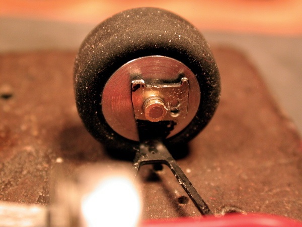

I know 1/32 kit building is'nt scratch building but I know this is were the builders are.
The kit is OSTORERO Lotus 79 John Player Special.
This kit is well designed and has been a blast to build except front the front suspension.
The chassis is pretty straight forward bend and solder type with separate front suspension.
Special care was taken soldering all the bend joints in the hope of strengthening the chassis for racing.
Axle stubs (.0625) are held in place by resin parts resembling air duct coolers for the brakes.
The stubs have a lot of play. Both up and down and side to side. The front wheels are held on with set screws.
The result is front tires that shudder like mad on the track.
I did reduce the most of the side play using six HO arm spacers left over from my 80's HOPRA days, but the axle stubs still move too much. The hole in the suspension is a bit oversize @.0635.
I'm thinking the only way to fix this is to modify the front suspension parts and use a solid axle.
Maybe this kit was to be a shelf queen and not a racer.
I'll try to post some photo's later.
Any ideas are most welcome.
My other question would be regarding the gears. Crown gear looks like brass and the pinion is metal.
The crown gear is eating the pinion. If the crown gear isn't brass is it bronze?
All the best, build on!
Robert

I just added some photos. The pictures should help clarify my description of the design issues.
There may be enough room, the tricky part will be removing the cast resin brake cooling ducts.
The suspension is @.025 thick or the same thickness as a 60's Monogram slot car kit brass chassis.
Ducts are attached with 5 min. epoxy.
The suspension is quite thin, so great care will have to be used no matter how the problem is solved.

#7 Robert Blaschke
Robert Blaschke
  • 94 posts
  • Joined: 06-May 08
  • Location:CT, USA
Posted 15 October 2009 - 02:13 PM
Thank you for the sound advice.
Slot cars like real cars are made to have fun with.
I put my restored COX 2E on the track when the track is clear.
This morning I did pop off the brake air ducts and decided to try a solid straight axle using 1/16" dia brass rod.
If all worked well I would use piano wire or a drill blank.
The front wheels worked great. Cool! Problem solved yes! Problem solved? NO.
The upper suspension attached to the underside of the body is in the way.
Even with out the upper suspension I'm not really sure there is enough room to make a cut out with enough space for the axle to rotate freely with out cutting the body in two. It would be real close.
If I were at least 85% sure there was enough room for the straight axle, I would put on the safety glasses and power up the Dremel.
One thing about slot car racers is that we usually find a solution to these kind of things.

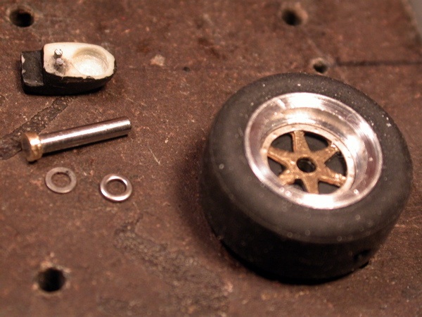

#9 Robert Blaschke
Robert Blaschke
  • 94 posts
  • Joined: 06-May 08
  • Location:CT, USA
Posted 21 October 2009 - 10:15 PM

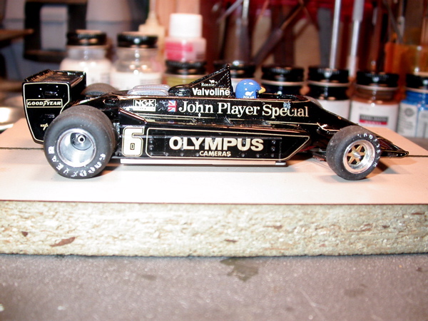

JPS Lotus 79 front axle stub modification complete.
I decided to make new axle stubs from 1/16" piano wire and 3/32" brass tubing.
The brake duct mounting tabs broke off when I disassembled the suspension so I added new ones with piano wire.
The holes in the front wheels was easily enlarged by inserting the piano into the wheel hole and rotating the wheel until it spun freely.
One .010 washer was used between the stub and suspension upright and one between the upright and the front wheel.
With very little side play the front wheels turn perfectly and the car now handles well.
The JPS Lotus 79 is nearly finished, all thats left is touching up the paint and a few more decals.
I will post pictures of the completed car as soon as the project is finished.
Thanks again for the great ideas.

Just a thought... but if you were able to loosen up the tight fitting piano wire stubs just by spinning the wheel a little, might there not be a tendency for the process to continue and leave you with sloppy wheels again after a bit of running?
Lining the wheels with a bit of 1/16" i.d. tube might be an idea, perhaps?
John Dilworth
#12 Robert Blaschke
Robert Blaschke
  • 94 posts
  • Joined: 06-May 08
  • Location:CT, USA
Posted 22 October 2009 - 08:23 AM
I here you man.
A set screw secures the wheel to the stub, so there is no movement.
I probably would have made the stubs a bit longer and made the front wheels independent but the front wheel track got too
wide with the wheel retainer between the suspension upright and wheel. The retainer holding the wheel on looked huge.
The original stub was real loose in the 1/16"i.d. tube.
The place where I could see a potential problem was in the suspension upright itself. As far as I could tell there was not enough metal there to add a 3/16"o.d.-1/16"i.d. brass sleeve.
I may try to sleeve the suspension upright on the next one, before I solder it to the chassis and bend the suspension upright into place.
