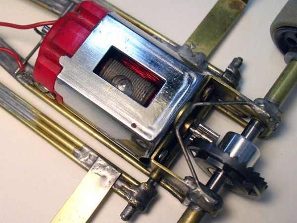

Gentlemen
here is a Princess, the lovely lovely Frogette:
Did'nt think She would be fast, but, oh boy, the Frogette can defend herself!
What motor is that, anyway?
Is'nt She delicately made up?
And sophisticatedly dressed?
More?

Edo -
The motor in the Lotus might be a Globe or Wilson. I remember an article in the old Car Model magazine written by Ben Millspaugh illustrating how to modify that type of motor. The main trick was installing the brush assembly from an Atlas frame motor.

Posted 28 October 2009 - 10:47 AM
With that HUGE pinion and relatively small crown gear, I bet it's got beaucoups top end but no brakes. The ball bearings are a nice touch as are the spoilers. :)
Also, might not that motor be an Atlas or Revell?

Posted 28 October 2009 - 11:06 AM
Hi
Actually, it is the RAM copy of the Pittman 196/Strombecker Scuttler...but the arm is from something else. The ram stacks were better than that, the blue or green wire is probably a 30s wind which is kinda the upper limit on that layout.
Can you do a reading on the arm?
That is a very cool car, though! I never did one like that. I didn't use any open frame motors in the day on commercial tracks. Lots on 1/32 club tracks but not like this!
Thanks for these.

Posted 28 October 2009 - 01:11 PM
Edo -
Hi Jim
here's the article you're mentioning:
Looks like the Atlas brush system mod is the same! But is the red Lotus's motor a Wilson, a Globe or something else?
With that HUGE pinion and relatively small crown gear, I bet it's got beaucoups top end but no brakes...
That's exactly what I thought before I restored the tires and put the Frogette on the track!
I thought I would give it a blip and see it jump the track at the first curve not being able to stop it!
Instead it's all the way around: absolutely not "tall" geared: great acceleration and great brakes!
It has a 14T pinion with a 25T crown but the wheels are tiny and the motor has plenty of torque down low!
...Can you do a reading on the arm?...
Thanks Rocky,
but to take a reading on that arm with my Kopriwa arm tester I'll have to take the motor apart, which is something I'm not ready to do right now.

Hi
All you do, edo my e friend, is put a alligator clip on the ends of the brushes to hold them off the com, and do it!

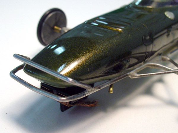

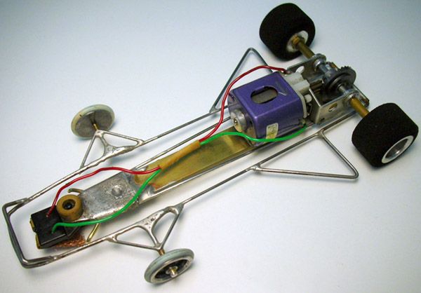

Gentlemen,
to continue our thread with more beloved toys, here is a (Dynamic ?) Alfa:

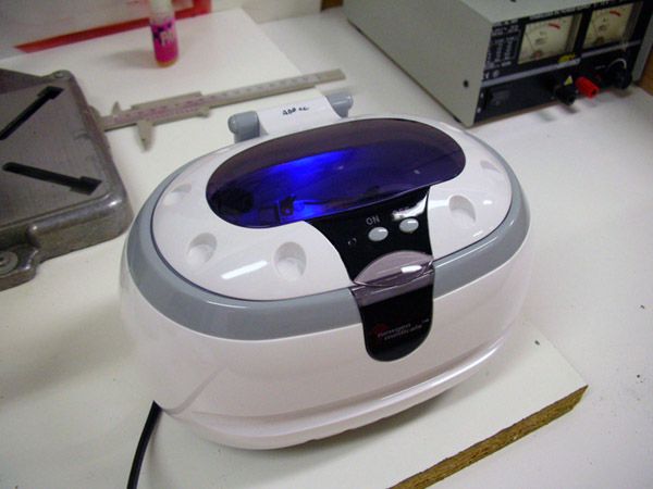

A little ultrasound cleaning:
and here the cleaned ISO chassis with what it came with:
Stardom and Glory to Jim:
More to come...

#36 Bill from NH
  • 11,138 posts
Posted 02 November 2009 - 07:07 AM
Nice handbuilt iso chassis Edo! With two sets of screw holes in the body mounts could it have been intended for use on another body as well? What's the rear wheel spacing? In the photo, it looks to be more than 3.25". :)
#37 don.siegel
  • 4,698 posts
Posted 02 November 2009 - 08:25 AM
The motor in the Frogette is a KTM DH13M - probably the new improved 6V version! Similar layout to the Ram, but that fiberboard brush holder on the side is a giveaway...

Posted 04 November 2009 - 07:54 AM
It is! It's an illegal spacing on all tracks except MINE! :laugh2:
