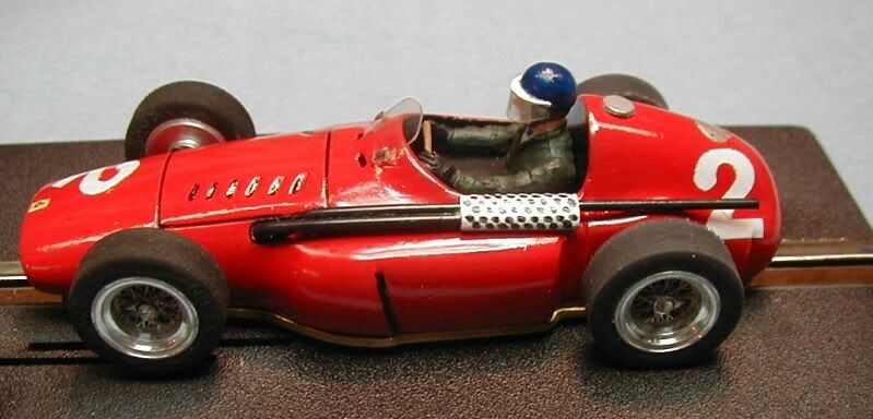

Back in 2005, I built a car for a Proxy race in the UK, and the guy who organized my entry there bought it off me and displays it in his slot car display case in the Brooklands Museum. Top left in this photo:
It was a 1955 Ferrari 555, also known as the Super Squalo.
I started about a year later building a replacement, but got sidetracked by other projects. With being on vacation for a few days, I managed to get the new version done:
The original used a Resilient Resins body, the new one uses a Pre-Add body, made by Mac Pinches in the UK. I doubt either of them are available nowadays, since Douglas Haynes of Resilient Resins passed away a few months back, and Mac Pinches has long since stopped producing his range of resin bodies.

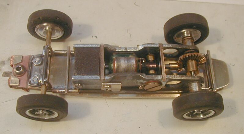

Underneath:
That's an Atlas 206, with Tradeship 3:1 bevel gears. The wheels front and rear are BWA as are the inserts, the front tires are Ortmanns and the rears are Ultrathanes from ABSlotSport in the UK. I have since replaced the magnet in the motor with a Neo magnet to get some punch and brakes back as the old iron lump had not much left in it.
Oh, and this one has a pin guide, like the original, made from a machined-down 3mm button head screw.
A couple more shots:
Thanks for looking!

Don, the Atlas magnet was still enogugh for the car to run, but it suffered from having little to no brakes, and there is not enough roon to be sticking neo magnets onto the outside of the motor as I have done on other Atlas motors, so I replaced the whole magnet with one of the South Pole Neo replacements. Now I have the brakes back and perhaps a little too much torque for the tires, so the handling is "interesting" It will be fun to see what it does on the BPR flat track. BTW, has your shim stock arrived yet?

Thanks for info on magnet; I know some of the British series allow these magnets, but we generally try to keep it stock (with an "excursion" or two by some competitors) and motor performance has been decent, especially by most of the open-frame motors. The 36Ds are definitely a "no-brake" option, except for the rare exception....
