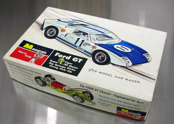

I got reasonably lucky on eBay last week and picked up a pretty good Series 2 Monogram Ford GT for not too much money, and am now in the process of collecting the parts to restore it. All it really needs is tires and decals. Tires are easy, and already in my stash of Ortmann reprodutions, so that's settled, but does anyone know where I can get a reproduction decal sheet for this car? As I recall, there was not much on it, just the tri-stripe for the sides with the Ford lettering, and the side numbers (#11).
There's nothing on the ED site, and I can't find anything on the Prof Motor site either, so any help would be appreciated.

In the meantime, some shots of the car:
This is the only serious crack in the body:
The LH headlight cover is OK, the RH one is questionable:
I have started the restoration, removing all the paint from the interior (it was layered on miles thick!) and cleaning up the body. The headlight covers did not survive being removed, but I will make new ones from PETG sheet. I have a set of replacement Ortmanns, and I will use BWA wire wheel inserts. The motor sounds good, the magnets feel strong and the gears are perfect, so I'm optimistic for a nice car once I'm done.
