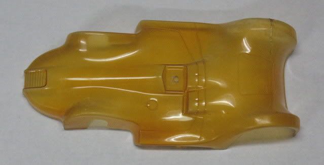

I was recently very surprized when I "stripped" the paint off of a gold metallic Monogram Snake body and found that the body was not clear but rather "tinted" goldish yellow. The body was simply painted silver underneath to create a cool "candy" effect as Noose eluded to. I wonder how many other factory bodys were done this way that we are unaware of?
Z
That is a standard DuBro thing, ie: Tinted plastic painted silver underneath. I have had a number of Dubro bodies that I built chassis for that were pre-painted with colored windows, and that is the key to look for. Tinted windows.... ;)
yes, that's pretty obvious but, a Monogram Snake hasn't got windows...
The color:
...after I stripped the beat up one I had:
Z
I do believe that was probably a clear body that was etched by the gold. Your stripper did not remove what had bonded with the plastic. I have stripped clear bodies before that retained some painted color.
Jairus, Here is the "magic" paint that Bob must have seen. All of these are Candy colors that look silver in the jar. I believe Ulrich paints were the best for clear bodies. When you painted with these colors they went on silver and dried Candy. It says you can brush them but they did not work for me. Either they are old and won't work or they have to be airbrushed. Haven't got to it yet.

Jairus,Rob I will send you a bottle on one condition. You experiment with it to try to get it to work and post your results here on the Blog. PM you address for a bottle. Joe
OK, I had time to try the bottle Joe sent me.
Photo 1) shows a body I airbrushed. The bottle said "Brown" but the results were just silver. Note: I added a little thinner to the paint and sprayed as I normally would.
Photo 2) I noticed where my airbrush "spit" I had a couple dark colored spots
Photo 3) I then airbrushed some paint straight at the point that it would run. It shows a halo of a pinkish color
Photo 4) I then just blobed some on with a brush to see what would happen. Just shows a darkish red / maroonish color
I'm not sure how it was orginally supposed to work, but it didn't seem to have any special effect for me? My paint also seemed very thin?
Hopefully Jairus has better results?
It is a KILLER ultra fine silver that's cool and I will use up:good:
Thanks Joe
