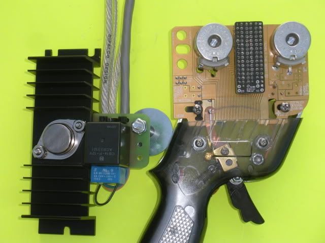

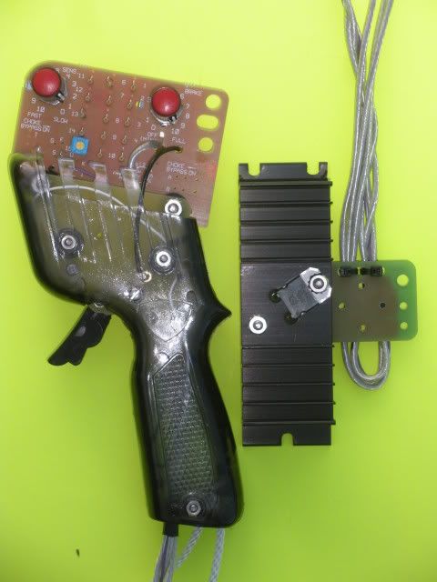

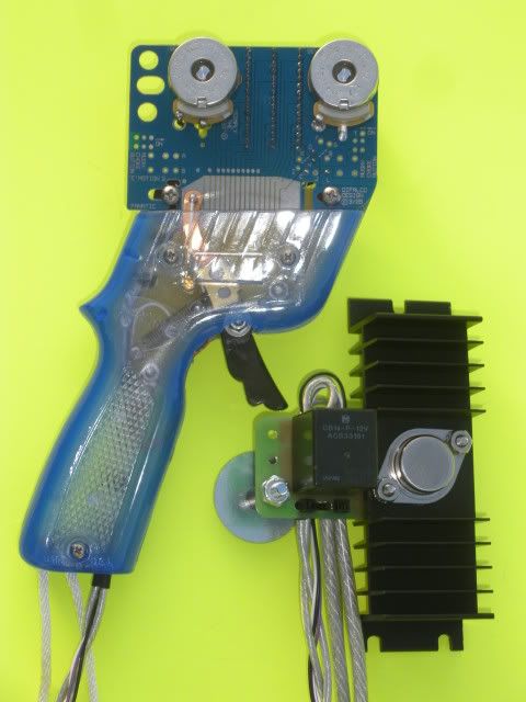

As you can see by the pictures the first 60 Genesis controllers come with custom painted handles by Race Pace's Bill Pinch. Some models have a single fogged color and the more expensive controllers have a silver inlay. We also brought back the all gold finish on some of the HD30 controllers, and at the price of gold today this may be the last time we ever do this.
Racers going to Tom Thumb to race this weekend can win a DD270 in a drawing.
The first picture shows the DD270, the second is the DD268 and the bottom picture is the DD267

DD267: Our new low priced controller retains our 15 band controller design with a new multi range adjustment pot. The sensitivity range has been slowed down to better match Falcon,16d up to G20 type motors compared to our "E"motion DD238 model. An adjustable Fanatic type pot on band 15 allows the racer to shift the band sensitivity up to 165 ohms or down to 115 ohms to match their type motor. The controller features the Genesis design with 14 ga wires. Replaces the DD238 model. $194

DD268: Our most versatile controller, especially if you race multiple scales or wing cars! Installed with our 20 ohm Fanatic pots this controller can run any car from homeset 1/32, H.O. up to the fastest G7 motors by adjusting the Fanatic pots with a twist of a screwdriver. This model features an economy brake rheostat and Blast relay. Replaces the DD238FAN15 model. $222
DD269: All the features of our DD268 model but with the upgraded heavy duty Pro brake rheostat. 20 ohm Fanatic pots. Replaces

DD270: 30 band controller with economy brake rheostat. Optional plug in networks let the racer tune their controller for any car from 1/32 homeset to the fastest G7 motor. E.S.P. brake and Blast relay. Replaces the DD250 model. $258
DD271: 30 band controller with upgraded Pro brake rheostat. Optional plug in networks available. E.S.P. brake and Blast relay. Replaces the DD251 model. $318
