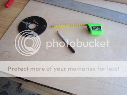

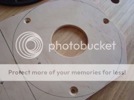

I knew I was a goner the minute I stepped into the stained-glass shop!
Having raced on club tracks, home tracks and a couple commercial tracks, one of the big building questions I had is how well the quite popular copper tape would hold up in construction and in regular use. Since I have no experience with the copper personally, I decided the only way to answer my questions was to see for myself. I love the commercial braid, but for my first couple of ventures, the economy and ease of copper tape might just be what the doctor ordered.
When I saw a big wall display with all the various copper tape, my curiosity was instantly converted to MISSION. "HERE WE GO!" $7 bucks worth of Venture tape and I'm all in! The shop even gave me an old roll they had laying in the back so I could experiment. Next stop: grab a sheet of 1/2" mdf, a quart of paint, a 1/8" router bit, and head for home!
So now what? Guess I better make a couple jigs. The goal is not to spend a small fortune on stuff, so let's use as many items we already have laying around in the garage as possible. I'm into it about $60 bucks, so if that's all I spend on this test track, then great. Plus, if I do another, I'll have the jigs and bit, and everything I've learned.

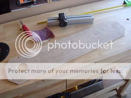

My mdf sheet is cut down to 3' x 6' for ease of transportation and storage. Why not have them do that for you at the lumber store. I want to use the outside edge as a guide to route my lane, so instead of a jig saw, I'll use my router to round the two ends. To do that, I'll cut a long slice out of a sheet of leftover 1/4" plywood to use as a large radius arm. Take the plate off your router, and use it to mark the plywood. We'll attach the plywood arm directly to the router with 3 screws instead of the router base plate.
The arm needs to be roughly 24" inches long to swing the 18" radius I need. When working with thin plywood, you must sand all the edges before running your hands over the wood. The thin pieces that splinter off will cut quite deeply into your fingers. I used a hole saw on the drill press to cut out the center hole of the jig.
As long as we're into the plywood, lets make another smaller jig that will help us in routing a slot later.
This one has an end just like the other jig, but only needs to be 8" or 9" long. Note that I marked out lines of 1" increments from the center of the hole.

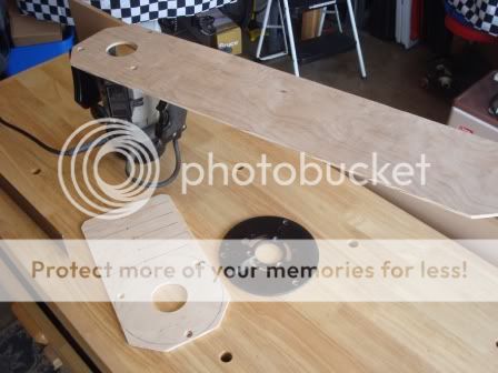

Here are both plywood jigs...
The long one is already attached to the router using 3 10-32 flat head screws.

Some of us can't ever leave well enough alone! I just had to do a couple tweeks to my jigs.
First, I added a small plastic drawer handle to the taping tool that will smooth the path of the tape...
And then, I added some bathroom door rollers to my routing jig instead of the two nails... it should work much smoother next time!
