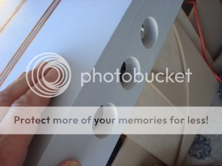

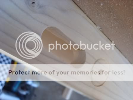

Mounting the walls on the outside will require some hardwood tabs, which I ripped and cut on the table saw.
See how the back will receive the wallboard?
Another shot of it...
I love this sanding attachment for my drill press! Man does it save time! I'll hit all the rough edges.
Here's how it looks on the track...
I'm leaving these plain wood. They'll act as bumpers as well as wall holders as the students move the track pieces around.

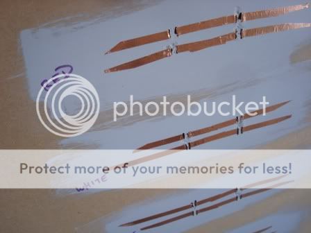

Now for the ends... my hypothesis is that if I add just a tiny bit of copper thickness, then the compression of the two track halves will ensure electrical conductivity.
So I'm going to try copper tacks, and I think I'll only put them on one of the track halves to start.
I am pre-drilling with a 1/16" bit.
And now for some paint before I start on the other half.
Now the swerves won't look so out of place.
To be honest, I wasn't all that careful or exacting on the colors, just enough for effect. After all, I don't expect this track to be treated with gentleness.
Looking more and more like a track! Now to start on the other half. Cheers!

Here is the section for the Trackmate dead-strip. I taped it off and laid down some copper to get the spacing. Then drilled out some tiny slots.
Some clean up...
And paint touch up...
Then some copper.
When I painted the top, I also hit the bottom with some patches under this area for the copper tape to grip on...
And here's the pick-up area...
I finished up with some paint. This section will be all business.... a pit area, and all the control stations. Not much grass for bystanders to have a picnic!

The day started with the drill, making some holes for the controller stations.
I'm adding two track call buttons, one between red and white, and another between blue and yellow.
It's still early in the morning, so I'll touch up the holes with some paint...

OK. One more sawdusty task... drilling a few access holes in the framework.
Try to remember where you put the screws into the framing from the mdf. I caught myself here almost wanting to drill in the wrong place.

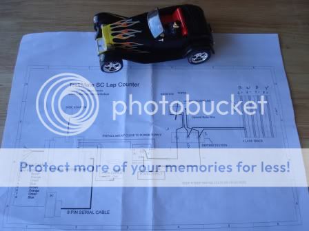

Time to consult the plans...
...and call in an expert for some advice.

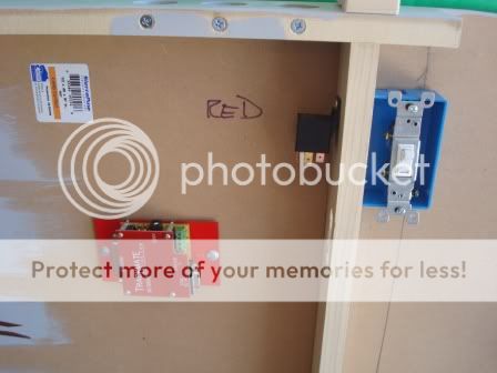

I am not ashamed to label everything. It cuts down on mistakes.
In fact, why not put everything you need right in front of your face!

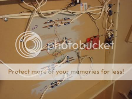

Our AZGR club uses Trackmate on all our tracks, and I think a relay override is so convenient that I will always put one in from now on.
Here I'm just using a standard wall switch in the blue shallow box.
If you're not sure what I'm talking about, when running practice laps, you lose power to the rails in Trackmate when you set up a race in the software. So the switch will bypass the relay, and allow for cars to be run while you mess with entering drivers, etc. Very handy... especially with impatient students!
Now, if you haven't done a multi-lane track like this, don't let this picture scare you...
Just complete one part of your circuit at a time, and it will make sense as you go. Take a multi-meter (I like the cheap analog ones with a "beep" function) and test yourself as you go.
My biggest fear is put to rest for at least now...
Good transfer of current from one half to the other!!!!! We're gettin' a track!

So, obviously, young kids are going to be much harder on the track than adults would be. Anticipating problems, I decided to do a small test block where I repaired the copper tape.
Here's a simulated break or gap in the copper tape...
If my tape gets mangled, I'd want to trim it back to get two straight edges.
Next, take a new piece that is wider than the gap, and lay it down...
Notice the valley between the two original pieces...
My plan is to not have a double thickness of copper after my fix. I carefully took a razor blade, and positioned it right on the rims of the valley.
Then just tear up and off the extra copper.
The patching piece must exactly touch the two original ends. No gaps, no overlaps...
Let's heat up a standard electronic soldering iron. See you next post.

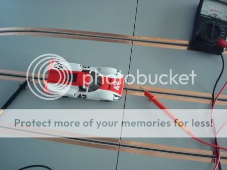

Here I am checking continuity of the finished patch with a multi-meter...
Electron flow!
Checking the profile...
OK. But we're not done with our test. Let's see if the patch holds mechanically as well. I say we peel off the whole strip and check it out!
All in one piece! After tugging on it a bit, I stuck it back down on the board...
Might as well keep playing around with it! I"ll sweep the soldering iron over it again a couple times, and stick it back down on the board...
...And pulled off one more time to check strength...
Dude... this might work! For now, this will be my technique of choice for doing any patching on the track's copper.
