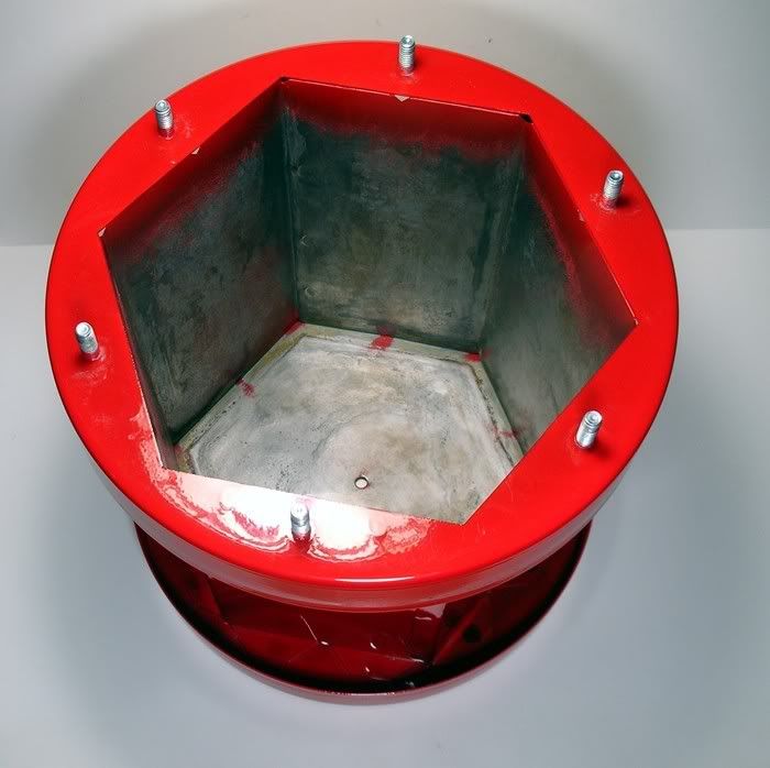

I had a bad feeling the other day. I get lots of foam seeping out when I first loosen up the tumbler lid. The tumbler drum is steel with a rubber liner. Moisture must be getting between the liner and the drum. What does it look like in there? My bad feeling was that it would be a rust bucket :unsure: .
Sure enough, when I tried to remove the rubber liner it was glued to the drum with rust :shok: . I forgot to take pictures as I was panicking to get it cleaned up. What a mess! I used Naval Jelly and a wire brush on the steel and an SOS pad on the rubber liner. After a few hours of work they look like this again:
I decided to prime and paint the inside of the drum with Rustoleum in the hopes slowing down the corrosion problem:
We'll see how this works and I'll report back. In the meantime, you Thumblers tumblers guys have been warned... BEWARE. :o

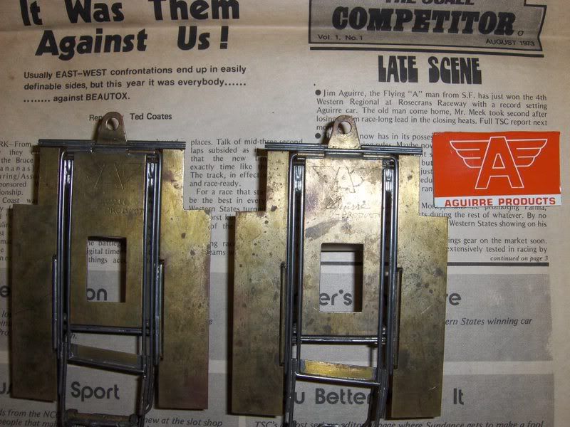

I was looking at your "Dave Fortner "steel" chassis". Does it have the same logo as this chassis I showed at the beginning of this post?
We have several chassis with this logo from the Oakland Speedway collection and we aren't familiar with the builder. Can you help :unsure: ?

You bet it does, Rick!
I took a little wool to it and cleaned it up a bit for you to see...

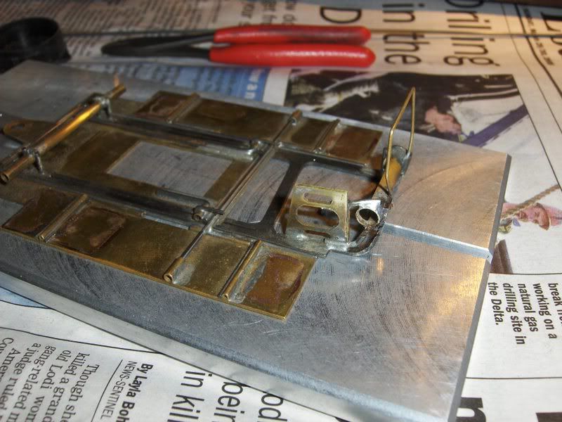

Rick, speaking of Oakland Speedway :yahoo: (a little off topic) here's a race report from back in the day, the "pros" ...
... The "amateurs"...
I have no idea what happened to me at this race. :scratch_one-s_head: I could have been still at the HO track :yahoo: or I could have been at the counter getting a "REL'S" sandwhich from Les, which were the :bomb: to grub on at the track! Great times and memories for me thats for sure!
I was given a "time capsule" by Dan DeBella and this report was in there. :wub:
As far as Dave Fortner goes, he was a racer and chassis builder from Arizona and was a great chassis innovator, as his "steel" chassis made for Dan back in 1969 shows. Thanks for the "heads up" on the rust propblem, I will get my drum powder-coated and this will put a end to the problem before it starts. I will still just dump the media solution in a container until I need to use it. :wink3:
As always, Rick,
Regards,
Dave Posted Image

Powder coating is probably the ultimate solution. A stainless steel drum sure would be ;) . I've already done the RustOleum primer and paint so I just going to let her go for a month or so and see what happens. A RustOleum torture test!

Why this one is made of rustable steel and most of the smaller tumblers are made of rubber is beyond me. The rubber drums are much quieter, too.

The steel drum has a rubber liner, so it is pretty quiet.
I'm sure with a bit of care, i.e. dry the drum after use, it will last long enough to pass it down to the next generation of builders.

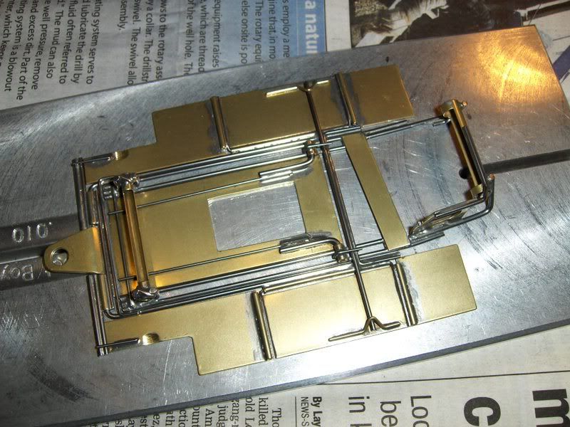

Shoot, Rick!!! You didn't tell me I had to put the thing together :dash2: ...
.... Just joking around with you, Rick. :wink3: I got the "B" model, I found they made a "H/S" model (Hi-speed) and bought it. I was told that the motor had a little bit more grunt :bb: for extended periods of use. A few things that I have done with this machine when using it: I have marked the top and its rubber gasket so it goes back in the same place every time. :wink3: I tighten the cover nuts as you would do when you tighten up a 1:1 wheel, in a star pattern. :good: ...
Well, Rick, after four hours of tumbling... out comes the Flying "A" chassis. :sun_bespectacled:
:shout: VANTASTIC!!! :sun_bespectacled: is the only word that comes to my mind, Rick! :wink3: Next up will be Dan DeBella's car (Fortner chassis) that he won his first "Pro" race with at Finish Line in '69, against California's best of the time. :victory:
There was a little repair work that had to be done to the back of the chassis. With that being done...
I'm going to bring this car back to its glory :victory: for Dan. Rick, I won't do it here on your thread, I will find some place to post it :scratch_one-s_head: But... I will post pictures of the finished chassis here. :wink2:
Again, Rick and Mr. Steube, :big_boss: thanks for all the great info here. :ok:
