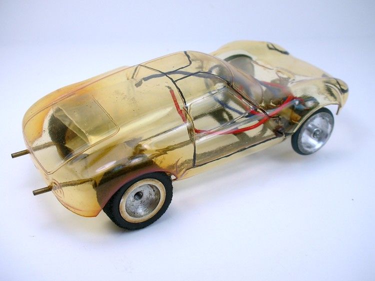

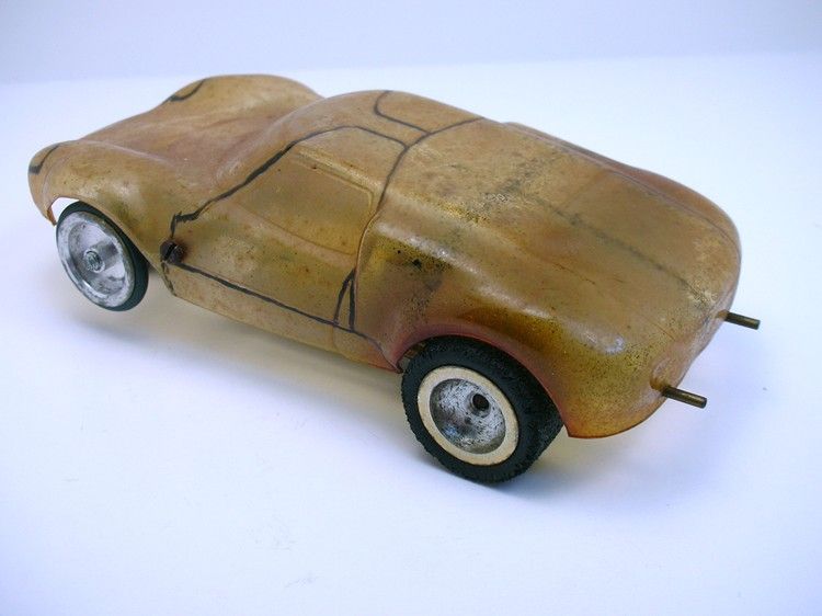

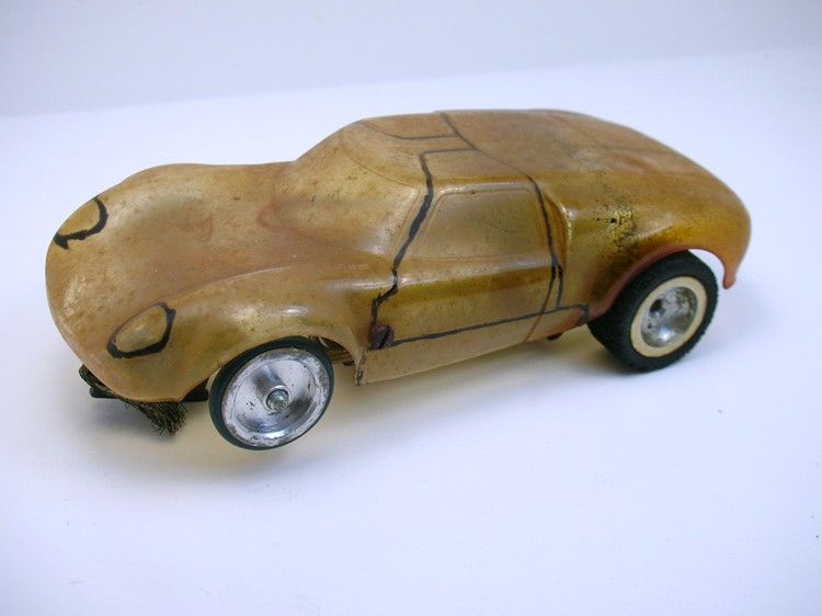

I won this sorry looking sod on eBay: :shok:
It's supposed to be a 1/32 scale Mecom Lola GT:
I'm not working with 1/32 much currently so why did I go for this thing? Lookie underneath: :D

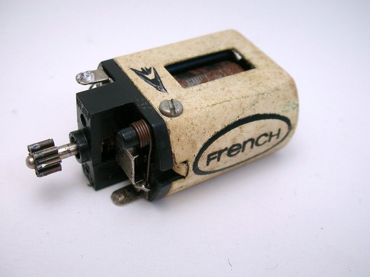

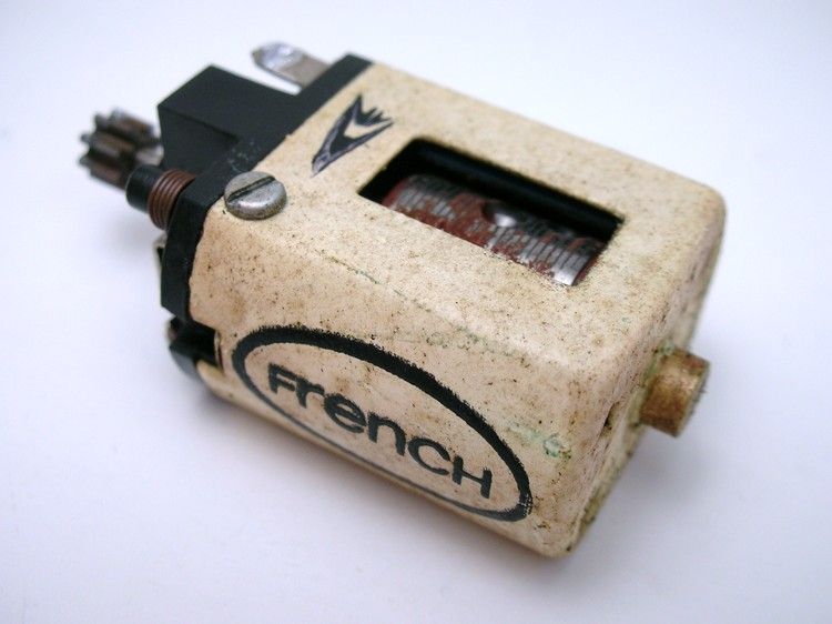

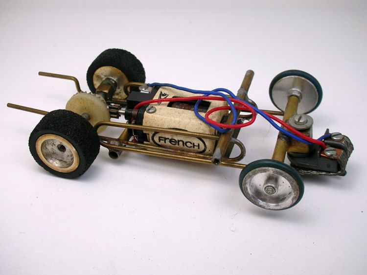

That arrow stamped on the white can means it's a French rewind and an early one at that. I planned on pulling the motor and junking the rest of the car but when I took the body off...

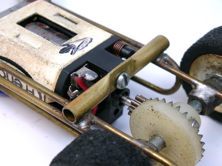

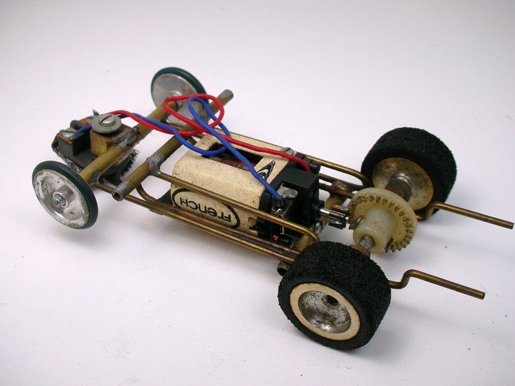

... the chassis design and construction got my attention:

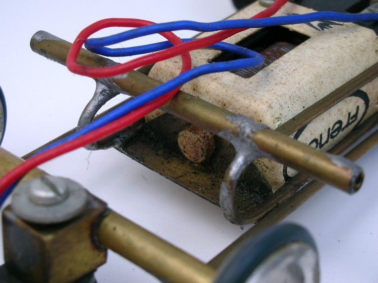

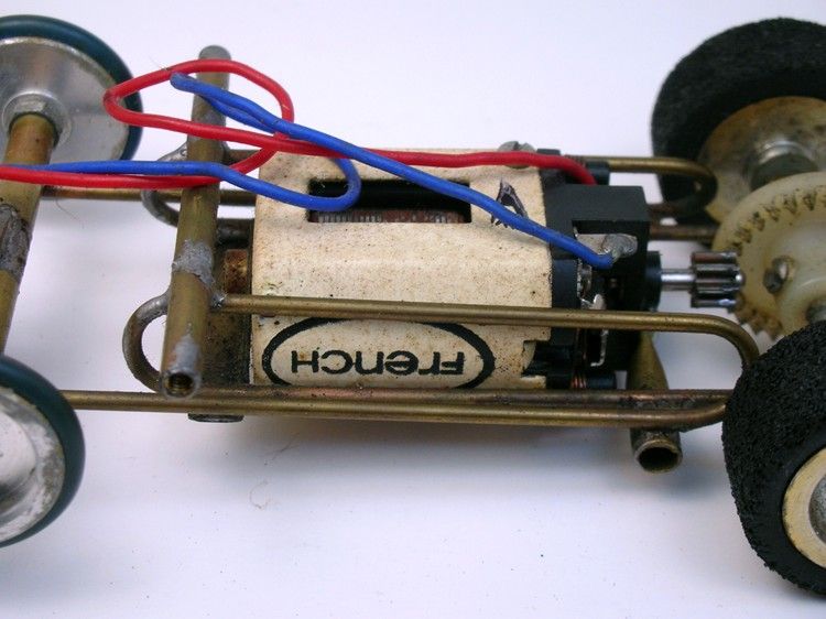

The "main rails" are a single piece of 1/16" brass tube. Starting at the rear where it protrudes through the body acting as a body mount and an exhaust pipe. Then it goes forward anchoring the rear bearing block, rear motor mount.....
... and forms the distinctive "paper clip" shape:
Then it goes forward to catch the front motor mount...

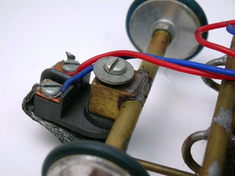

... and finally the front axle tube and guide block:

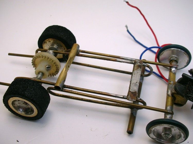

Here it is with the motor out for a better view of its construction:
That front body mount tube has been threaded for a 2-56 machine screw with a tap. I don't think this is just some young kid's car. There is some real fabrication here. The design also causes the front axle to have a "suspension movement":

I think it's an interesting design and perhaps something that could be restored and running chassis added to the LASCM?
I would think it would be a good representative of design experiments in the pre-pan era.

Rick, I think I'm in love... seriously, this is a great find, and really a very imaginative design. It also reflects something I've seen in a lot of cars from the time: very creative, even sophisticated features, combined with some pretty naive construction.

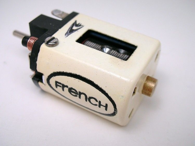

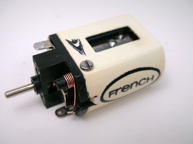

Here's the French motor. It is an early example with the "pre-brush tube" end bell. It's built from a Cox chrome can motor using stock Mabuchi magnets.

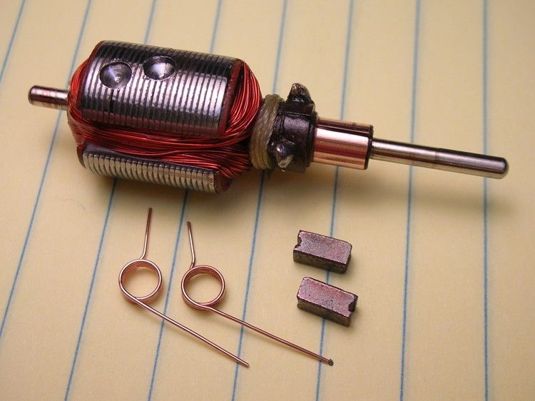

Here are some before and after restoration pics:

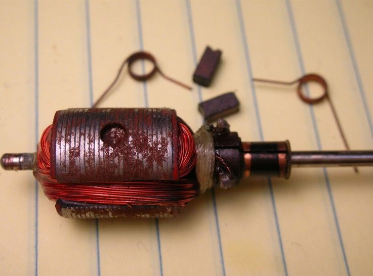

Most of the Crap-O-La on the can's paint was mold. Some Windex kitchen spray cleaner with bleach took care of it.
A VERY light buff with fine polish brought out the paints shine nicely:
A Dremel wire wheel got the rust off the arm. A Cratex burr cleaned out the balance holes. The brush springs got a soak in Tarnex and a wire wheel polish:
The arm reads 1.7 ohms and has just a tiny bit of CW timing of the comm.
#11 TSR
Posted 26 December 2011 - 06:13 PM

Posted 26 December 2011 - 06:22 PM
WOW that motor looks brand new great job!

A good chance that the 1.7 ohm arm is 90 of 32 that was considered to be be a six volt wind. 80 of 32 is 1.2 and my favorite wind till the Arco days. With the weak Mabuchi or French magnets that wind would live, have decent brakes, and lots of RPM. Well, for a 1965 motor anyway! :)
Very nice little frame! I've never seen a peice of round tubing used as a motor mount or square used for the guide mount.

If one thinks of it, it was certainly not stupid, for both the flex in the frame and the guide mount.
I think so too. That's why it didn't get thrown in the junk box. Don will give it new life :good:
