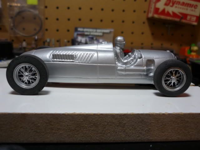

I often resort to turning the original plastic hub into an insert for an alloy rim but do it slightly differently than shown above.
I use an exacto saw and slice the plastic rim first, then holding the insert in one hand and a dremel with sanding drum in the other lightly sand and turn,sand and turn the circumference until I get a nice fit.
These two 1/32 cars have had the plastic hub sanded to fit an alloy rim...The auto Union uses Ninco alloys and Ninco plastic wire wheels as inserts and the Lotus has BWA rims and original sixties hubs sanded as inserts.
