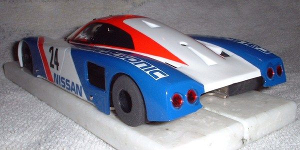

...is this more like it?
[Posted Image
This one features a JK Indy chassis with the wheels jacked-up and Overdrive lighting system. It handles great, but I don't dare to race with the other guys. :shock: All of my other hardbodies are beat up, including the Nissan GTP. :lol:
Russ Toy (not Troy)
#9 TSR
Posted 13 June 2007 - 10:24 PM
Better. Now put the rear wheels under the fenders where they belong, remove the white markings on the tires and fit some decent BWA mag inserts, and remove the cheese bell off the top of the driver's head and give him a real helmet. A Cox driver's head would be perfect actually. 8)

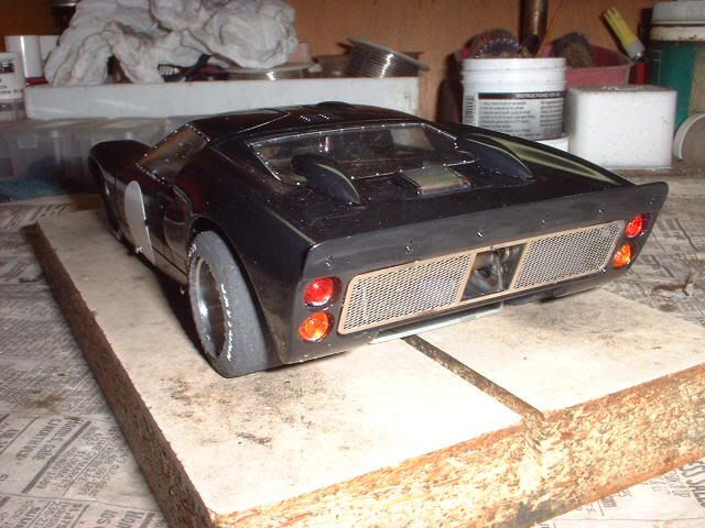

(Alan Mann GT40, Le Mans 1969, F. Gardner, M Guthrie, driving)

Oregonians been building and racing1/24th scale appearing model hard body race cars for 20+ years now. With 7 active club tracks scale racing is thriving, unmatched anywhere else in the US- and there’s not any commercial tracks around- Oregonians don’t want ‘em and the nonsense, including speed crazed morons, that goes along with them.
Oregon tracks are not copies of the usual 8 lane punchbowl monstrosities. Competition is the key and remains the enduring object of Oregon racers. No where else are groups racing different kinds of model cars that in miniature capture the essence of motor sports history from the 1950’s to the present. Gives slot car racing a variety unmatched.
Your comment is a widely repeated lament, uttered for a generation now. Yet few seek to return to scale racing which is proving, in one state, to be the key to 1/24th slot racing durability.
