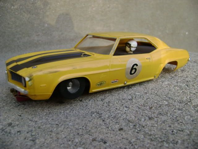

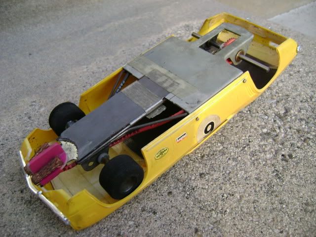

Here are some pics of a womp I "wall proofed". I used .047 to protect against most normal-heavy hits. If one feels they test the walls more often .055 will be a better choice. The motor/rear braces really solidifies that area with the "L" braces added to the motor. Making the rear end strong is critical to Womps or another inline. The area circled on the rear brace is where the two ends of the wire meet. usually I make two "C" braces as this is usually easier to make than one continueous peice with 6 bends. I just happen to get lucky when doing this one.
Nice looking brace,thanks for posting off to try it now.

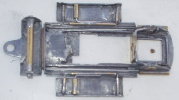

Here's a pic of one of my survivors from the late seventies.
We used to run them in period with Group 12 C can motors with all the bits like elephant ears heat sinks, buss bars and shunted brushes.
The chassis got to this stage of modification because we gradually developed them through changes in the motor spec for the class.
When a new track was built with acouple of long straights the standard Johnson 222's were not lasting long especially with the gearing we were running to take advantage of the straights so most race night there were a number that would let the magic smoke out and stop. The decision was taken to upgrade to another motor. At the time the closest motor in performance that would be reliable enough and readily available was the Mura group 12. After a while the chassis was found to be wanting with the more powerful motor so a further rule change allowed chassis mods but retaining the inline cinfiguration. this was where we got to as diepicted in the picture above. Bodies were fairly free in what was allowed but no wings were allowed. My personal favourite was the Parma Chev Monza but towards the end a few guys were starting to use the 1/32 scale sized wing car bodies that were just becoming available. Therewas a push to ban the wedge shaped bodies and retain the more traditional womp type bodies but alas the raceway closed and we had nowhere to race.
I've since restored the chassis and had it running but with more contemporary running gear in it like a Plafit Fox motor as it's more suitable for the shorter home tracks that I race on now.

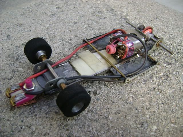

Posted 09 May 2012 - 12:24 AM

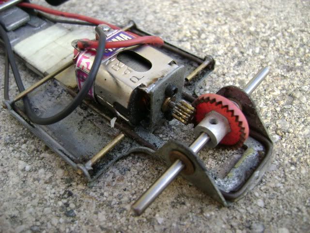

The first pic shows the mods I did. Braced the frame around the rear axle box all the way up through the front axle area. Then another around the motor and rear bushings down to the rear of the car. It stiffened the chassis a lot--of course--FIRST--I used a flat plate and made sure the chassis was nice and flat to the block. Then a shot of the Hot Rod bodies I used.

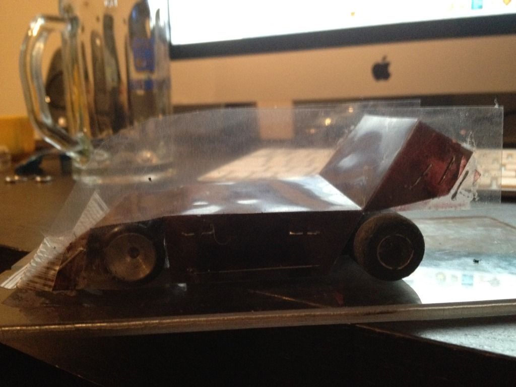

heres my massacred womp
can you believe i won a race with this thing?

Nice design. I can believe you won. The front must felx a bit and stay down in the slot well.

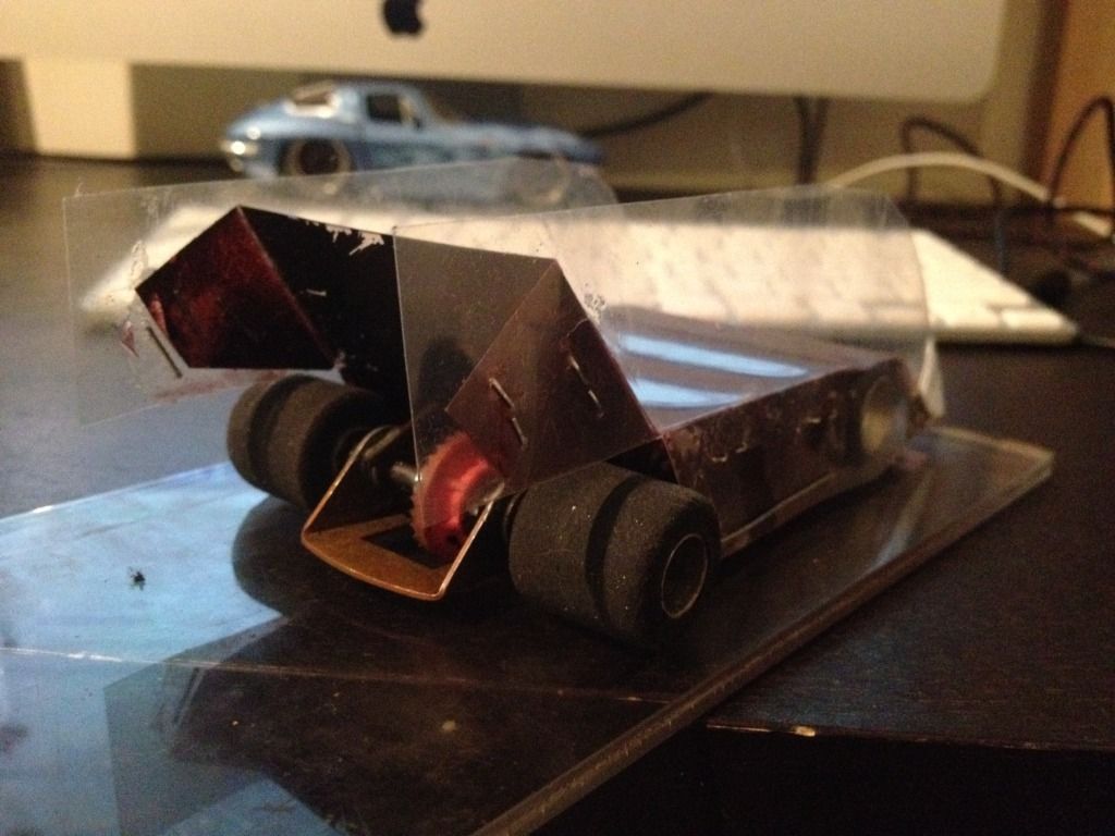

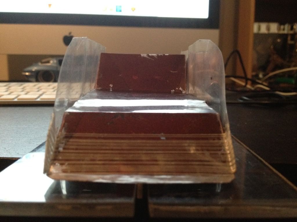

Posted 22 August 2012 - 05:30 AM
my womp runs great with my custom 1/32 wing car body i made from laminating sheets :). it can easily keep up with a flexi chassis running a 16d around a figure 8 course. once the tires have warmed up.

Simmo, can you show us a photo of your wing body? I'm sure there are others, besides me, who would like to see what you created. :)
