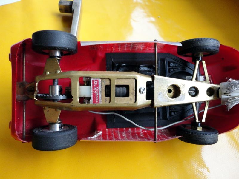

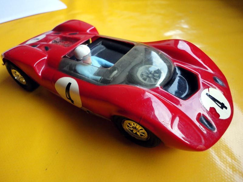

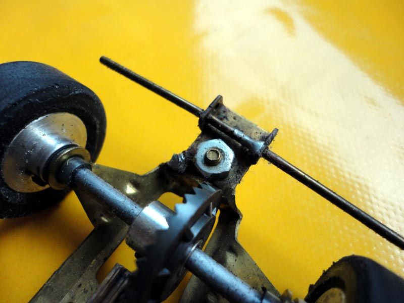

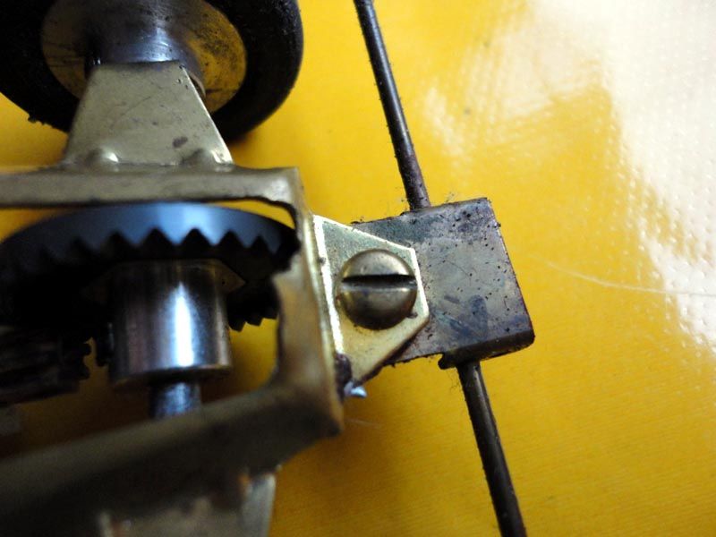

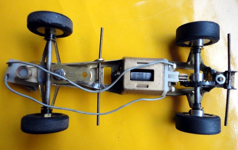

As promised, Steve. Car is as found a few years ago on eBay (I didn't really know what it was!), and it's been through a few races since then! I've lent it out a few times because it's a very easy car to drive. Very decent speed and handling, but not as quick around corners as the Carrera cars.... Actually finished fourth in my first race with this (I brought about six cars, but it was the one that ran best!), mostly because it survived, and a lot of the others didn't.
The dirt is all authentic, 21st century, and I do have the intakes...
RusskitSuperSpyderMcLaren5_zpsb7aa3ab3.j
RusskitSuperSpyderMcLaren4_zpsdb9e93f3.j
RusskitSuperSpyderMcLaren3_zps1be7431c.j
RusskitSuperSpyderMcLaren2_zps3f65d8e4.j
RusskitSuperSpyderMcLaren1_zps74c3f5fb.j
So, turns out it is a specific part on the back (nut and bolt not authentic!), but would be easy to work up something else...

This is version #2. There is an earlier version of this without the fabricated rear mount.
Also do you need a set of the missing intake stacks and the correct wire-wheel inserts for your car? :)

There was a Version 2 of a car that was already very obscure in Version 1? Amazin'! If you have a photo of a version 1, I'd like to see that... did they just solder the tube to the rear of the chassis, or ???
I do have the intake stacks, Philippe (faut tout lire, comme on dit sur FOLM....), they just fell off at some point. If the wire wheel inserts are the correct ones, then I don't have those - I thought these were the ones the car came with! At least mine did, and I think the Carrera version of the McLaren has these inserts as well...
Very strange about these inserts, intakes, etc. About fifteen years ago, I got my first Russkit, an assembled Lotus 40 with its box, that had never or barely been run - and it came with these intakes, not the correct Lotus 40 ones! Hard to figure out how they could have been replaced in such a new car... Could Russkit have erroneously put the wrong ones in the box?

Yes, the first version had a tubing soldered directly on the chassis if I recall, we have some, I will take a pic next time at the LASCM.
The intakes for the McLaren-Elva are the "Weber" carbs also used on the McLaren MK2. If you have a Lotus that came with these, it was obviously an error from the factory. The Chaparral 2 and the Lotus had the tall intakes from the Lucas injection system. The Porsche came with sets of "carbs" (three on each side) while the Eagle and Honda F1s had two sets of six, each with the same design.
The wheel inserts you show on the Elva do not look like Russkit items; could you post a picture showing them from the sides?
Correct Russkit inserts:
1) Wire, used on the Ferrari F1, Chaparrals, McLaren-Elva, Iso Grifo
2) Cooper "round" spokes, used on the Cooper F1 and Spyder
3) "Eagle", a mess of flat spokes used on the Eagle and Honda F1 as well as the "Hustler"
4) Lotus, four-spoke inserts used on the Lotus 40 and McLaren MK2
5) Iso, a sunburst design not used on any Russkit car including the Iso (!) but available separately
All these were also available separately, offered in large vac-formed black trays at the raceways.

Thanks, Don, for the pics. I can fabricate that. It was only when reviewing this thread that I noticed that the whole chassis is different on the later version with the bolt-on pan. The rear of the chassis isn't cut out, but has a pressing to accomodate the gear.
Anyway, this'll let me make runners out of some of my spare Russkit bodies.
Doc, I'm also interested in pics of the early version of the chassis with the soldered-on pin tube when you have time.

Good point, Steve. I always tend to forget about that! Don't think there are any other differences however.
As you can see, I also had to cut out the earlier chassis to get a larger Cox gear in there...

Yep, looks like those rear tires ran into a little global warming (or global glue...) as well...
Not to mention that sometimes the export products (like those Italian Russkit F1 cars) could be very different from what was available in the States.
I asked Fred if he thought the shop owner could have added that mount himself, but he said not, the guy was not at all interested in slot cars, and just had a few for sale...

And we have evidence that the Porsche was issued that way inside the standard cardboard box, so why not the McLaren? Probably only a few were done that way before business ground to a complete halt...
