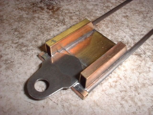

Mike Steube demonstrated a technique using lots of Stay-Clean flux and an Inland 100 watt iron which worked very well. He actually put solder on the top of the two pieces as well as mating surfaces to get the solder to flow evenly everywhere. After the joint was finished, he just cleaned the excess solder off with sandpaper and Scotchbrite pads.
If you tin both parts and hit it with the torch, you don't have to clean off the excess solder. And the solder get in every little crack and crevasse. Looky here:
