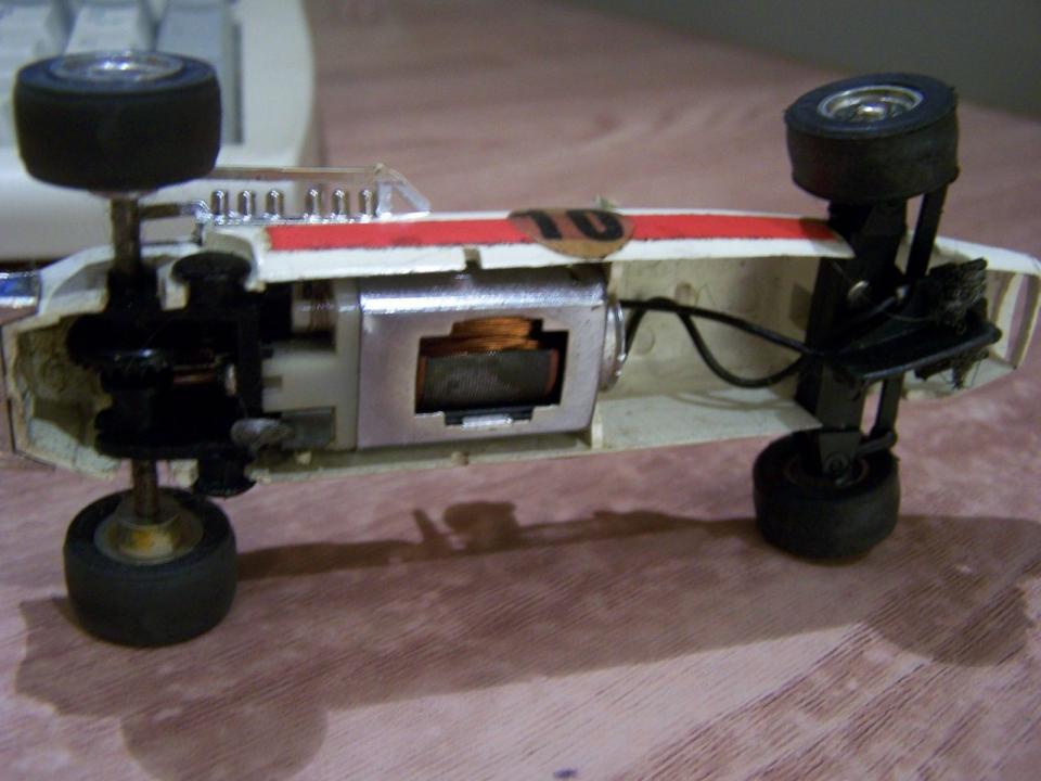

here's a pic of the Honda chassis....
Paul Quick
#6 TSR
Posted 09 January 2014 - 05:30 PM
Yes, I believe late 1990's Jersey production... still nice models!  :)
