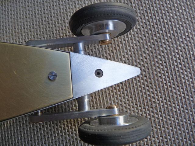

steering wheel, fuel cap and hand pump aluminum.

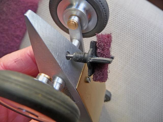

to complete the car, it remains to mount the motor, and position the other guide at the back.

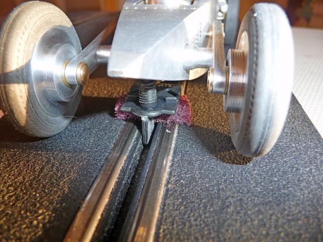

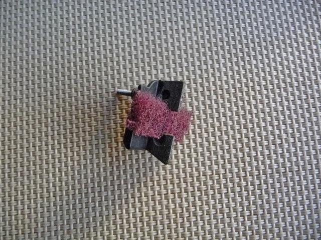

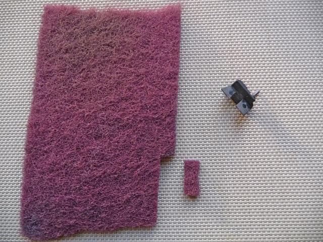

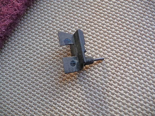

cleaning system simple, removable, discreet, and adjustable height
  • endbelldrive and slotbaker like this

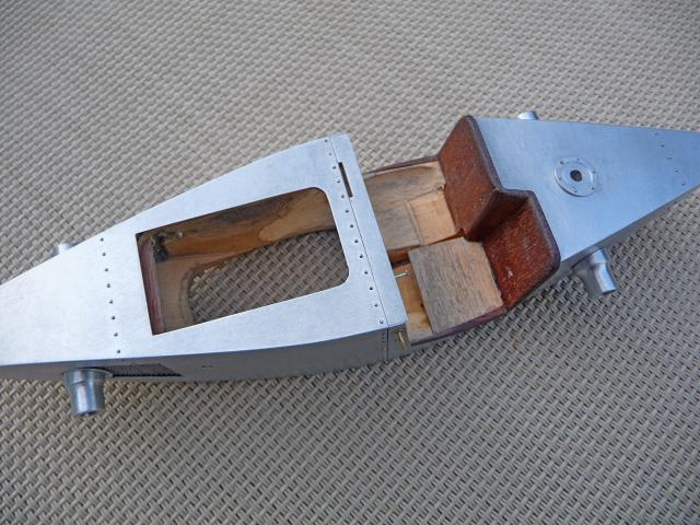

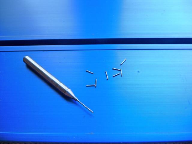

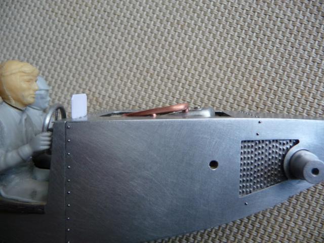

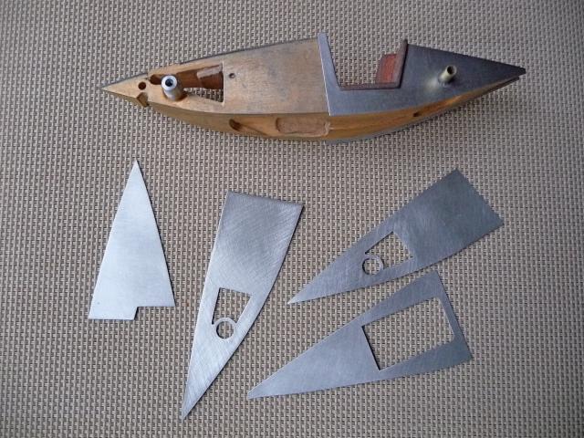

wrapping strange machine with sheet aluminum, it is 0.3mm thick and is glued to the Araldite on previously coated wood glue cyanoacrylate
game of patience.
drilling 63 holes Ø 0.4 mm and installation of a head rivets 0.5mm.
  • endbelldrive, slotbaker and Jocke P like this

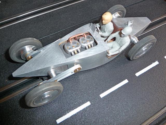

Posted 09 February 2014 - 06:22 AM
Thanks Bruce
Great time this weekend, the car made the first laps
it now remains to finishes, frame and painting, and this is not what takes the least time.
It was not easy to position the motor in the body, with this banana-shaped frame  :dash2:
The transmission shaft passes right between the two drivers.
the dashboard, I may add a speedometer

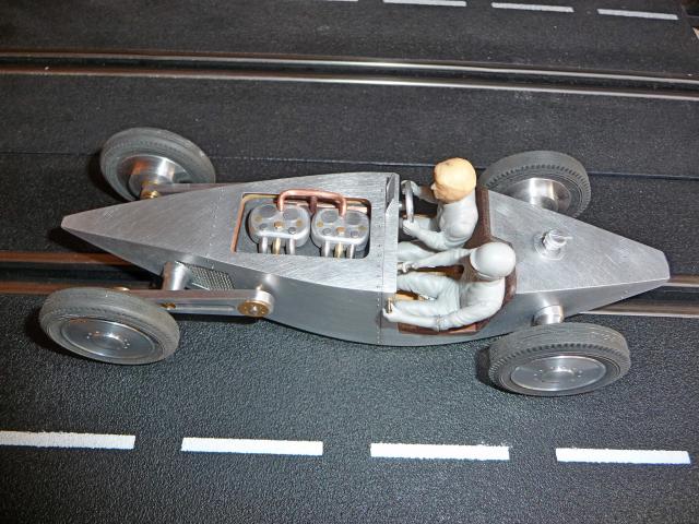

Here are pictures of the car over, I was forced to reduce the length of my two guides so she can take my Ninco tight radii.
