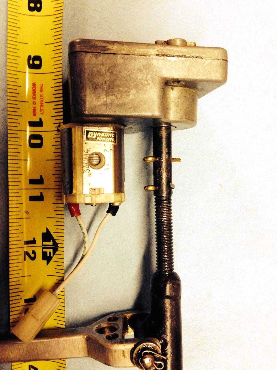

I’m looking for a GE 3ADM 12V motor. I found a GE 3ADM4 from Professor Motor (it looks the same) but it runs too fast for my application (not a slot car). I think the 3ADM motor might turn about 1,000 RPM and draw 3 amps under load. The motor is about 1.25" long and 1" in diameter. It has a 3/32" diameter shaft. I'm interested in a 3ADM in any condition but preferably still running. I'm attaching a picture of the motor I'm trying to replace.
Also, let me know if you have a lead on who I might contact to pursue getting one of these motors. Or is there somebody that could help me rewind my 3ADM4 to operate in my system (like a 3ADM).

The GE 3ADM 12V motor I want to replace is in a gear motor set.  The spec on the set says 60 RPM output at either 0.3 amp or 3 amp (hard to read), I assume under load.  I took the gearbox apart and calculated a overall ratio of 35:1 so I estimate the motor is turning 2,100 RPM under load.
I'm attaching a picture of the motor I removed from the gearbox.
I really appreciate the help.  I'm using the gear motor in my homebuilt airplane to drive the elevator trim tab.
Bob
