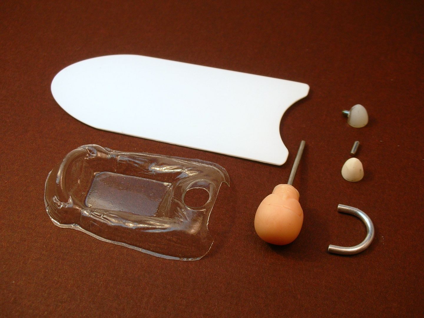

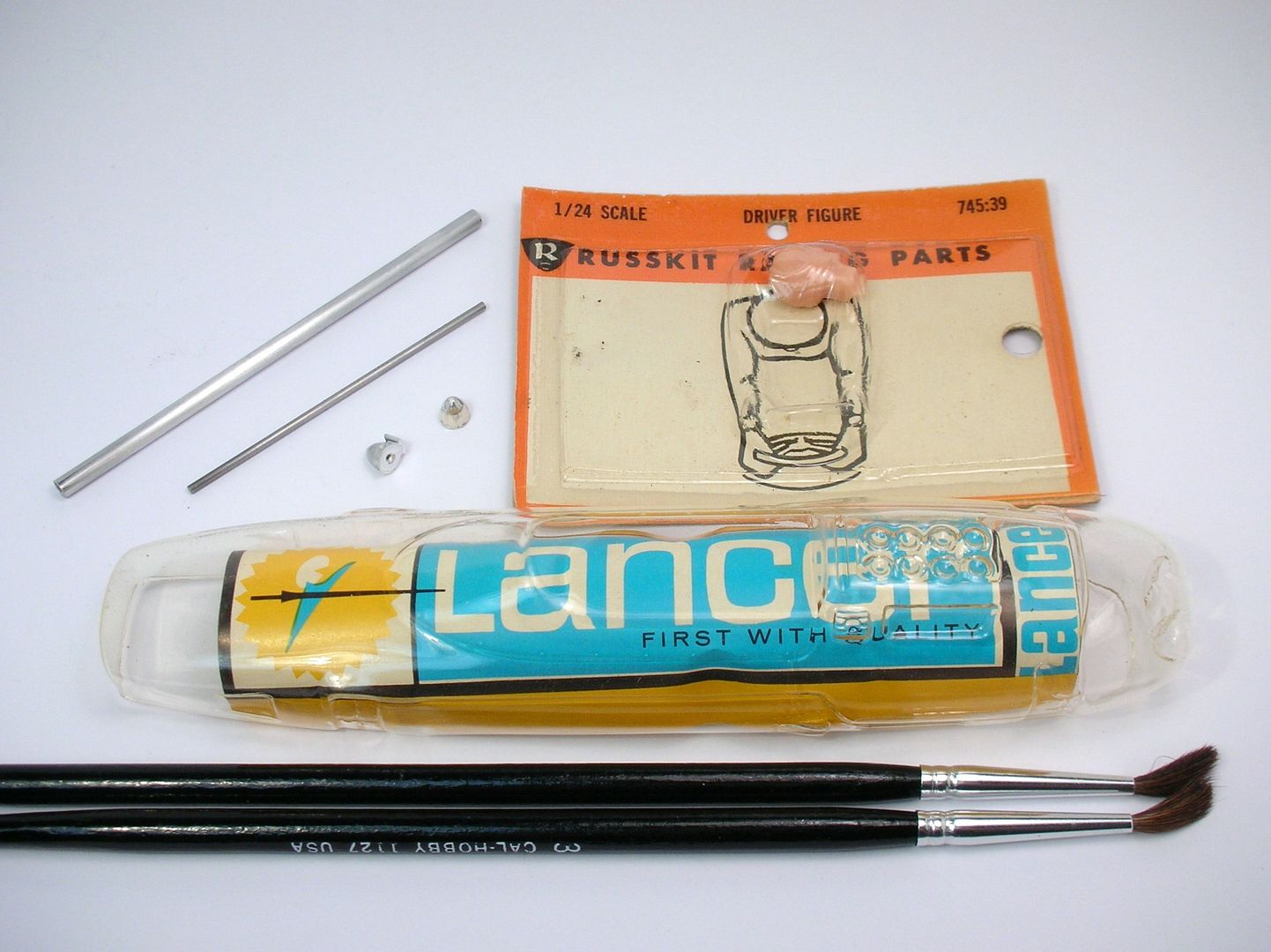

I'm using for the body build:
An original Lancer Lotus 25 body
Russkit "Praying Mantis" driver
Revell BRM mirrors
Paint brush ferrules for exhaust pipes
1/16" aluminum tube for the roll bar

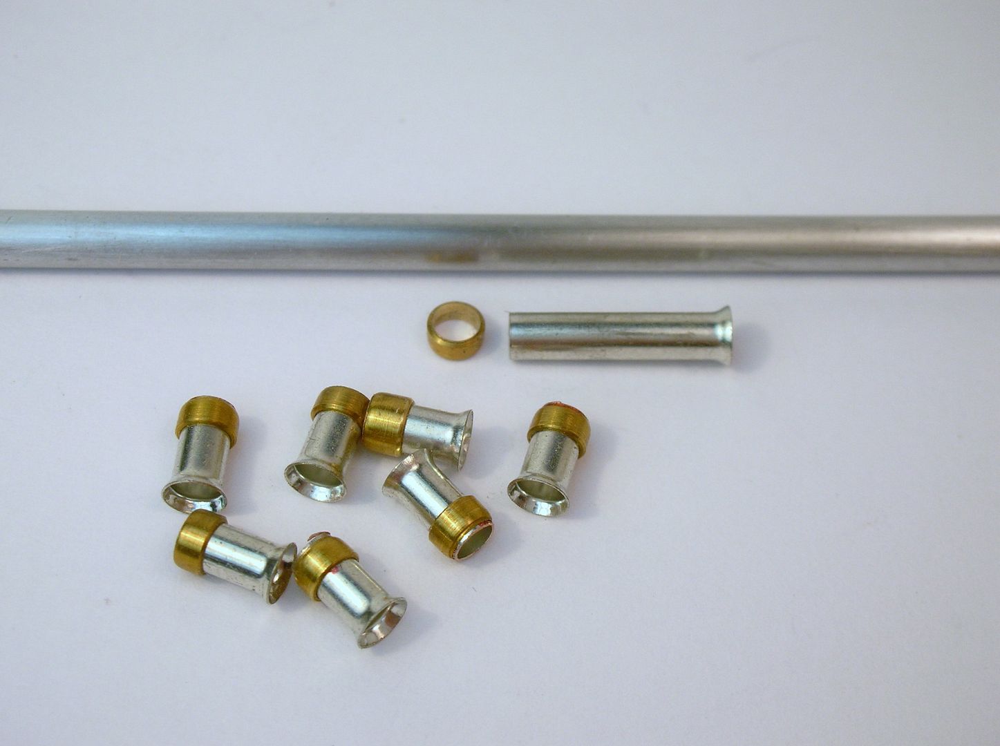

And I thought I was going to make the velocity stacks from 1/8" aluminum tube:
After I drilled 1/8" holes in the body I remembered I had 8 smaller diameter, pre-formed velocity stacks left over from a previous build. I came up with a "fix". I used brass axle spacers as a reducer for the smaller stacks:

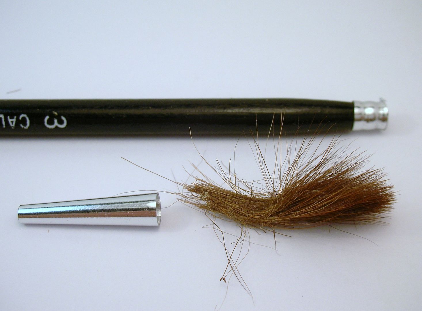

An exhaust "trumpet" made from the donor paint brush:
The driver's body and the interior base needed to be clearanced for the motor's brush spring. The mirrors were drilled and fitted with .047" wire mounts. I also inserted wire into the drivers head to hang onto while painting:
The body ready for paint:
