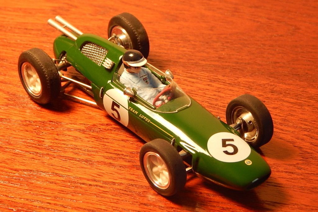

I've been building resin cars for years.
Scrub it with bathroom cleanser, rough the surface with fine sandpaper, wash again in soap and water, and prime with Tamiya white primer. Use Tamiya paints. See resin Lotus 24 below.
Rick, for you it should be simple!
And yes that's an Immense Miniatures Jimmy driving.
Easy peazy, and use Immense Miniatures drivers. Sorry, Niels, they're better.

I don't know if Tamiya will work on old clear bodies, but Tamiya Racing Green in their TS line of paints was specially formulated from a real Lotus 25 living in Japan, for their 1/20 kit of a Lotus 25.
Tamiya TS-43
Nice Lotus, by-the-way.
