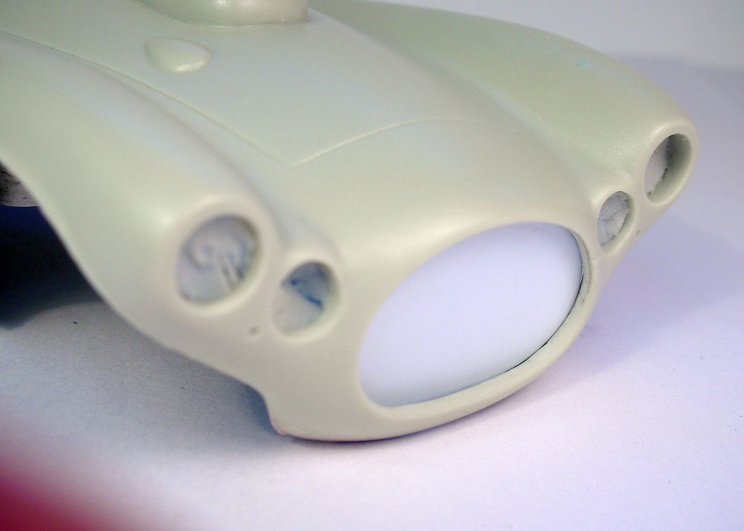

I fixated on making a more or less proper grill for my car that will also allow me to strengthen the front end. I showed earlier the styrene blank that will be backed as Chris described above to sturdy up the front:
Unfortunately, this looks like grunt. It needs to look more like the real car:
So, as an inexperienced modeler I tried the "shotgun" approach. I eBay'd a photo etch metal mesh decal material from China, a photo etch metal mesh from South Korea and 50 mesh brass brass screen wire from Baltimore.
Not surprisingly the brass screen showed up first and I put it to use with stuff shown below:
Here's a closeup of the brass screen:
I painted the screen and the plastic piece with Tamiya flat black, sprayed the back of the screen with the 3M adhesive and stuck the two together.......bingo!
It has some lint I need to blow off but overall I'm hopeful that this will work out..........
