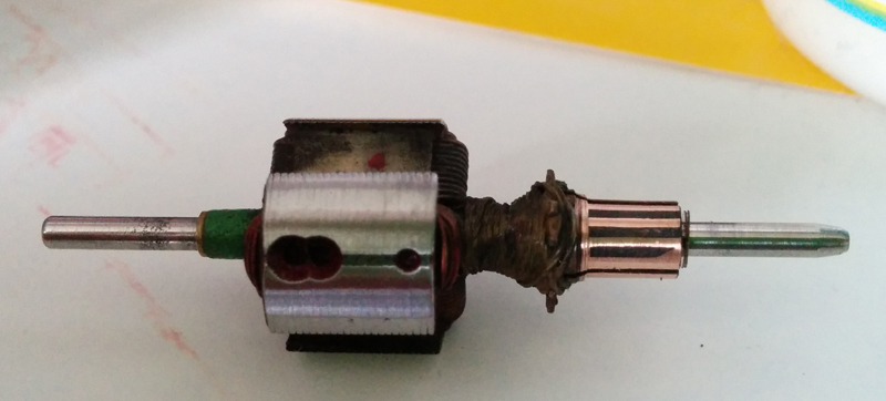

I have a BOW G12 armature that I would dearly love to save, but the comm is stuffed. :(
Can it be saved?

Well I have just placed this over sized armature into a setup and it is currently breaking-in smoothly at 4 volts.
Will drop it into a chassis within the next couple of days and take it for a test run :)

When The Spin Doctor was doing its armature servicing there was an exploration into a method of renewing commutators without replacing them. I was advised by a trusted chemical engineer about what it would take to do so in house. Let's say that it would have required dealing with some nasty chemicals and even though I had dealt with them in previous employment, it just wasn't going to be worth the time and the headaches to pursuit.
Yes, it can be done. Like everything else, how much do you love that arm? ($$$)

If the comm hadn't been tied and epoxied, it could probably be replaced. As it is, well, I think you're SOL.

It's a matter of whether to deal with some deadly toxic materials to make a few bucks. Now if the US gov'ment were to find that saving slot car arms would be worth $100/each (just some wild figure pulled from the air...) there might be someone already willing to do the work. But with many metal finishing plants closing down because of environmental/regulatory reasons, and also lots of this kind of work exported to China, India, and other places where "dirty" work has been encouraged to go, there's not many places left who'll even try... Me? My cyanide and heavy acid days are long passed by.
Again, it's a matter of money and there's no guarantee that the process would result in an armature that would be any good after processing (I left a lot out about the process in the previous post). It would have been a great experiment *but* I was highly encouraged NOT to go down that road by a chemical engineer I had worked with years before.

Alas the BOW is well and truly knackered. :(  :(
Dropped it into a BD3 chassis today and took it for a run test tonight. Slower than a house car.
Oh well. :)
That's only the half of it. The wire has been either welded or brazed to the comm tabs. If this weren't the case and it had been soldered, it might be at least "possible."
In any case, all the work involved and the most likely outcome being failure makes this a fool's errand.
