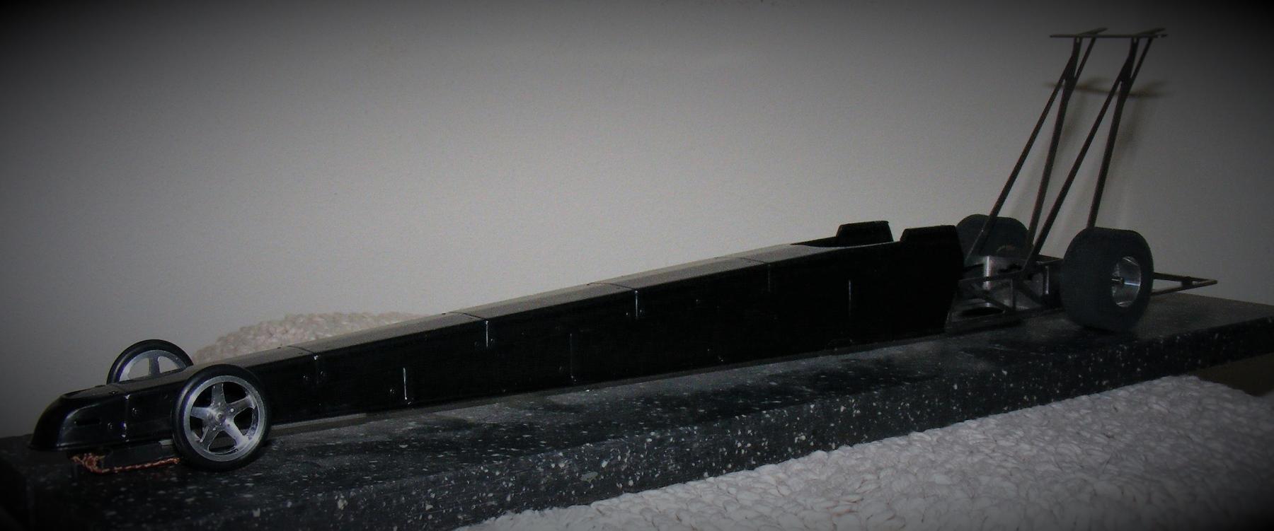

"Oh Black Betty"....goes the song. This Top Fuel Engineering scale rail I traded for. Don't remember exactly what it was I traded for it, but I'm pretty sure the other guy got the better end of the deal. She was totally knackered. Dropped in a bucket of acid and left to rot holding 20 grams of excess solder with more than a little crash damage and kids....that was just the chassis. I 86'ed the body in the ash can by my pit box as soon as the deal had a seal. Motor went right behind it. In fact I think the only thing I kept were the basic plates that make the kit up and the wire in between.
The solvent tank came first. Nothing looking like the bottom of the outhouse basement goes in my blast cabinet. Stripped of ick a torch removed the bits and pieces of scrap wire and excess solder to a point were the bead blaster could do some work but first..more heat and a hammer to get flat possible. Must have ran over it with a buss. Heat and temper then off to the surface grinder to make flat what was intended so. All said and done if I would have blued it...would have looked new. No need as it was headed to the paint booth. But not until the abrasive wheels got a shot at it. Burs and knife sharpe edges and a surface too smooth to solder needed some conditioning. Passing muster diamond files made each plate fit the next. A nip here and a tuck there. A hot iron, some acid and 6% silver solder were added in proportion to the four main rails that were laid in place. 2 of .062 tinned piano wire and two heavey wall .065 hypodermic needle tubing. The first nested in the slots assigned by the designer and two more inboard those tabs. Some bric-a-brac was removed that I had no intentions of using. The mounts were builders attach fake scale engines atop the electric motor benieth. I'm not that guy. The motor, mine anyway are pretty and it's MY slot car. Scale or not I don't want my work hidden buy someone elses idea of what it should be.
Betty has seen every power level from 7 flat in an eight mile to 6.80's in a quarter. Whatever I drop in it, it gets the best out of it. Weights run 110 to 115 grams and yes, those front tires roll with the flow sitting on the track if the braid of the track is flush. I have smaller rings for the quicker work.
This one car has won more individual races than anything in my box including multi-week points races. There are but a hand full of scratch built inline rails that can claim sub 7 times. This is the only Scale Rail kit type car I know of that has done so. Come to think of it. I sold an Xtreme Carbon rail at two thirds this cars weight that never cut the mustard after Betty strutting her stuff.
She is almost always in my box. I still don't know what her limit is. 195

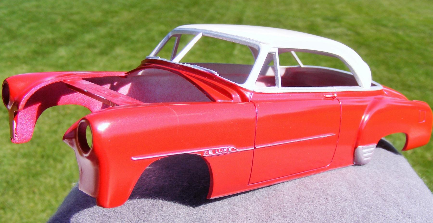

I have a few that never made it off the drawing board that might be worth a look like this 51 Chevy DeLuxe.
This car was an exercise in multi tone painting and I nearly pulled it off. Almost. Shooting the lightest color first over your primer the next area is masked. That same color is once again shot which seals the tapes edge to prevent bleed under of the second darker color. Wash, rinse and repeat until all your layers are down. That's what the model car rag said to do. It's the advice I got. It was good advice. Here's some additional information. I paint in rattle cans for the most part. For lacquers and acrylics, water or solvent this works pretty good. Not so much for enamels. It works better with an air brush than a rattle can. It works better with steady hands and sharp eyes and a sharp razor or allot of magnification.
Two things kept this car from completion. I didn't paint the hood at the same time thus the shade of red was impossible to match. Rookie mistake. Second was some thickness blister issues on the right rear fender. You have less control over the pattern and none over the dilution rate so build up is easy to botch in the three tone.
To get the sliver stripe and "Deluxe" I burn (rub) through the red to the underlying silver base. Door handles and brica-braca ditto. This was the most aggressive paint project I've ever tried. If you look back on the previous two tones you see steady improvement in the sharpness of the paint line. That first 66 NOVA is crude compared to this. That fender panel was too large an area to rub threw and I brushed that with allot of thinner to hold back the brush marks but eh, not everything works.
I have a 50 Olds and an 61 Cad to do in this method as statics for my wife and I need to perfect it. May need to break a few more eggs. 464
