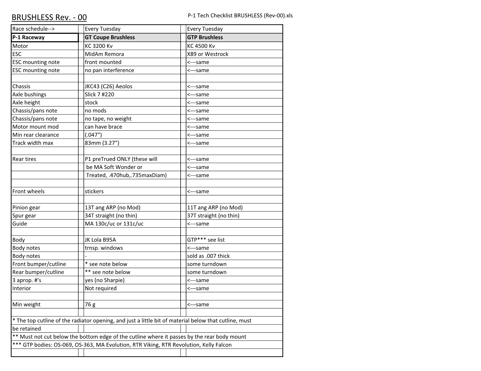

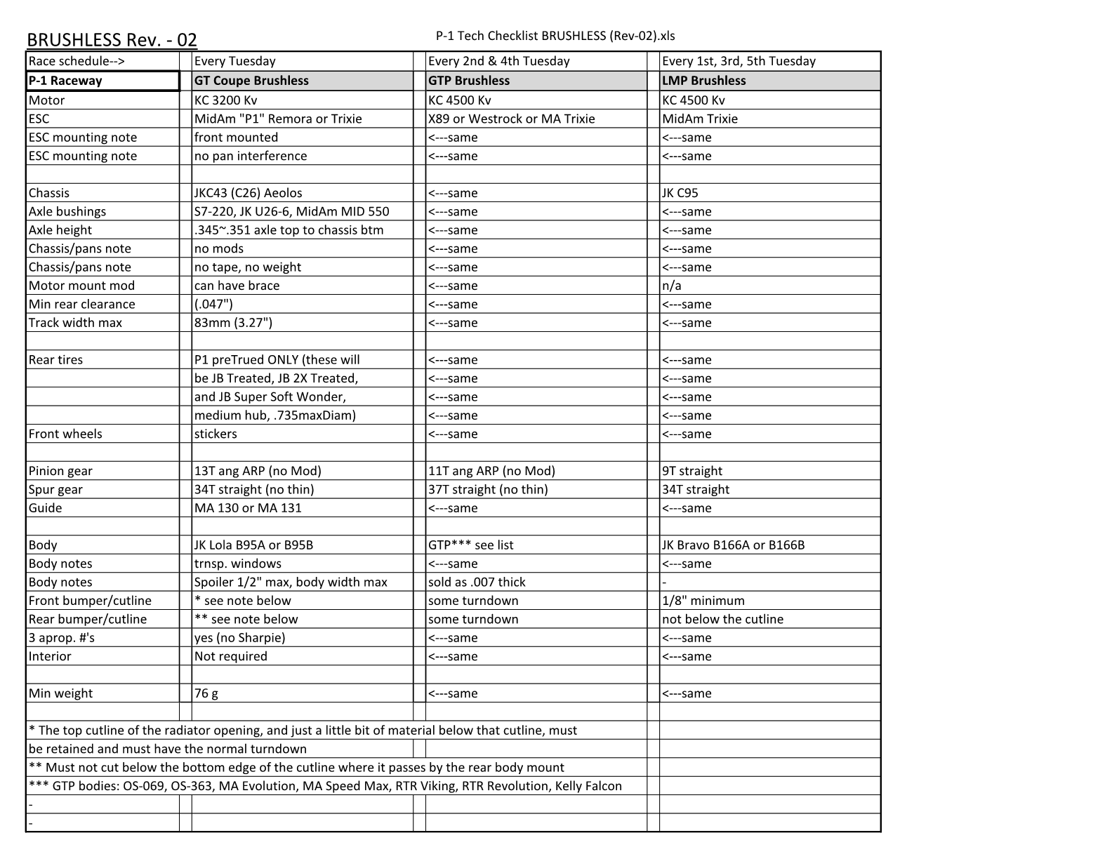

#12 dalek
dalek
  • 859 posts
  • Joined: 25-October 11
  • Location:Central FL
Posted 01 April 2024 - 08:12 PM
The P-1 Slot Car Raceway rules (written as a tech checklist) have been updated to Rev-19.
The differences from Rev-18 are highlighted in yellow (see second image below).
Motors highlighted and having strike-through text, have been dropped for the class indicated.
All other highlighted cells indicate items that have been added.
The right-hand column contains the specs for the Brushless GTP class that is raced on Tuesday nights.
Note: As in previous versions, the top row contains the monthly race night scheduled for each class.
Attached File  P-1 Tech Checklist (Rev-19).pdf   444.61KB   14 downloads

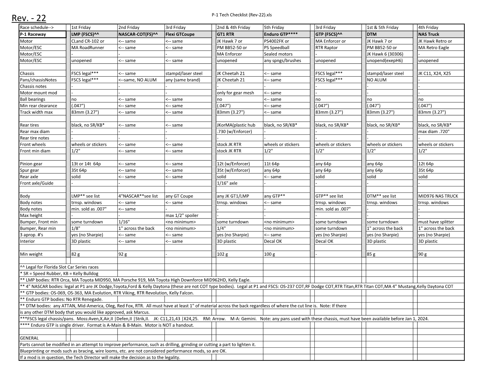

Posted 11 April 2024 - 11:08 AM
The P-1 Slot Car Raceway rules (written as a tech checklist) have been updated to Rev-20.
The only change from Rev-19 is a correction regarding the pinion gears that are legal for the CR-102 and Road Runner motors (in Rev-19, the spec implied that only a 13t pinion would be legal if using a Road Runner motor).
THE CORRECT SPEC IS:
Both 13t and 14t pinions are legal for CR-102 and Road Runner motors.
Attached File  P-1 Tech Checklist (Rev-20).pdf   444.6KB   3 downloads
