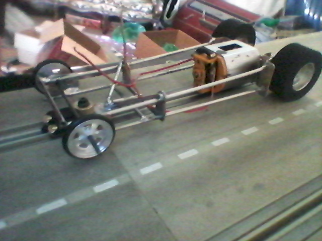

I have started putting together a frame for the Arco 9/4 motor John H put together for me towards the end of last year.
The frame is made from 2mm .2 mm wall thickness stainless tube with a WRP inline can drive bracket and .025" brass sheet.
Tires are JD's .500 Cragar s/s out back and the same brand O-rings up front.
Body is the Shinoda P from Gene's World.
I'm planning on running a Weldun 16t 64p pinion and maybe a Sonic 48t 64p crown. The car still needs a little work; it still needs some wheelie bars and maybe an interior. The motor in the pics is one I just had laying around and I will do most of my testing with it.

I never saw a 'Noda dragster. This should be interesting! :) :good:

Nice job, Tom! It should run as good as it looks.
Keep us informed of the results when the car is completed and tested. :)

Thanks, guys.
I will post more pics when the car is finished and let you all know what it ends up running but we don't have a strip here currently and we may have to wait til the Rods & Rails event.

Those Cragars look nice!

Thanks, John. I like them, too; they are nice wheels.

An elegant brute.
