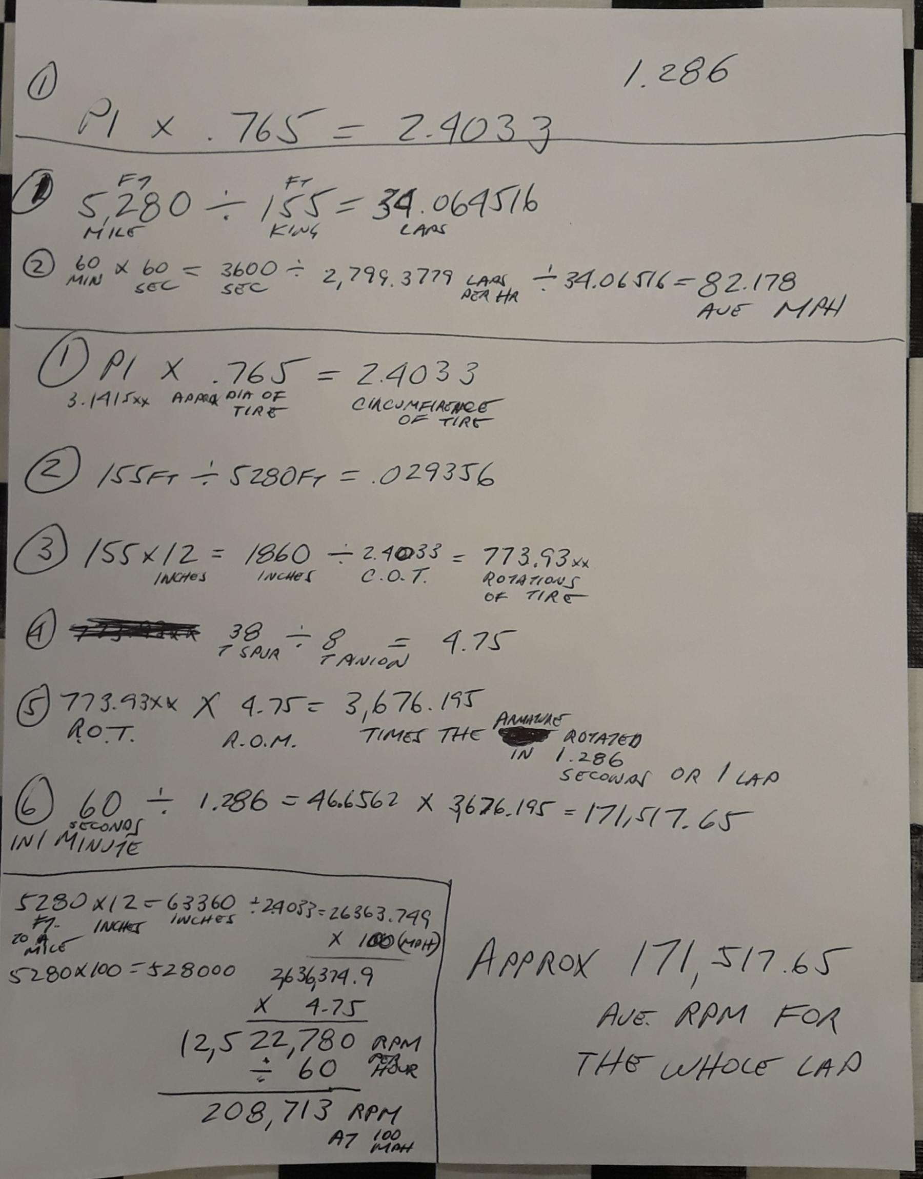

A friend of mine keeps asking me questions about the motors. How many RPM's are these motors turning and how are they geared? How many magnets and what kind? Who makes the motors and how much do they cost?
Approx. ave RPM in Brad's lap 171,500.
He averaged 81+ mph, so it's reasonable to assume his car hit 100 mph (I remember a guy hitting 90 on the radar gun on a 2.1 second lap, back in 1992.
At 100 mph, approx. 208,700 RPM.
20-30 mags is common.
Here's a pretty standard RTR G7 motor, from Koford(probably the only one a raceway can purchase through a distributor;
M196-20-G7
20 mag CNC open motor with billet retainer
ball bearings and .490 84 SAW arm.
$438.86 ea.
I'm guessing one from someone like Beuford, might be $500.
  • Pappy and NSwanberg like this

Thanks Mike.
I heard a few years back that they turned 180,000 rpm's but didn't know for sure. 208,000 rpm's is uncanny and almost sounds impossible. But then again, light traveling 186,000 miles per second sounds impossible to too but it does.
