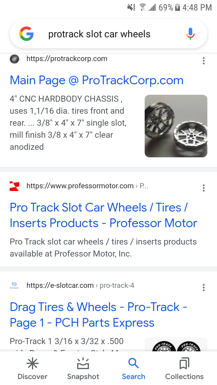

Where can I get wheels and tires for the 1/32 for drag racing?

These are available through pro slot corp.

Protrack sorry

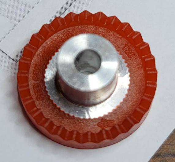

What's the crown?

The large gear on the rear axle that allows the motor shaft to be at right angles to the axle. Shown is the Red Fox 48 pitch crown.
[attachment=213156:RF Crown.jpg
It is called a crown gear because the teeth make it look like a crown.
