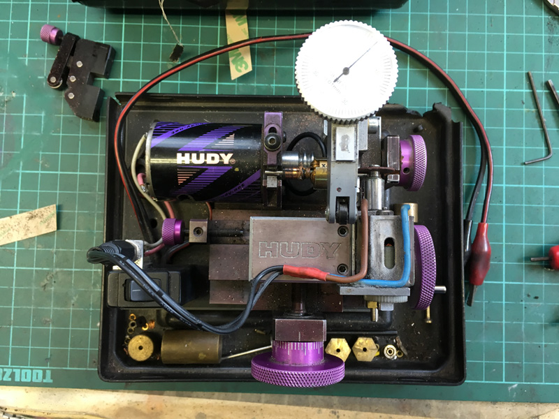

I modified my Hudy comm lathe by machining up a new ballraced support. The armature is rotated 180 degrees. A Falcon-powered mandrel mounts in the Hudy toolholder and uses a reduced-diameter Dremel cut-off disk to grind the shaft. Dial gauge shows how it's going.
It took me three different versions to get to this one, and it works perfectly. If you want to post them to the UK, I can grind them for you but it's a long way... :)
  • MSwiss, havlicek, Samiam and 4 others like this

Thanks, Wink, that’s good thinking...

The Hackman Hudy "Hobby shaft grinding rig" looks sort of interesting. With care and patience it may possibly come fairly close. Send your arms to Wink, including a gift card, for a six pack of Boddington's and a few pounds. He will sit down, taking it easy, while knocking off the six of Boddington's and then tackle your armatures.

It certainly takes care and patience. I've been using and perfecting the homemade rig for about 10 years. In that time I've ground many shafts for other racers and never had one returned.  I trashed a few of my own test pieces though. For sure a commercial concern with a centerless grinder should do better.
If you do it yourself you need to support the shaft as rigidly as possible, as close to the end as possible, and in a way that minimises runout - i.e. in v-blocks or a ballrace. V-blocks should be best but you have to consider the cutting force trying to push the shaft up the slope of the block, so I went with a ballrace at the business end. It has to be changed every 10 armatures or so.
The toolpost grinder rig in the picture above is probably good enough for truing tyres, but not for armatures - it's only as accurate as the runout on the collet chuck. Sadly, in my experience they're not as good as you'd like – if you get them down to 0.02mm you're doing well, and that's not good enough.
  • Cheater likes this

Wink,
Nice job on the arm shaft grinder.
Interesting way to do it, and probably the best way, on a compact machine.
Do you think steel disc, a bit smaller in diameter than the abrasive disc, between the screw head and disc, would add any worthwhile stiffness?

Yes. Also the abrasive dust must cause havoc.

My bad re. centerless grinding, I stand corrected.
Mike, at first I did back the cutoff disc with a steel disc exactly as you suggested, but I found that it made no difference provided I used the heavy duty Dremel cutoff disc.  Incidentally, the disc is pulled backwards onto the shaft – that way you can see what's happening.
The cutoff discs do clog with use though, so now I'm beginning to think of a Mk4 version using an axial CBN grinding wheel...
