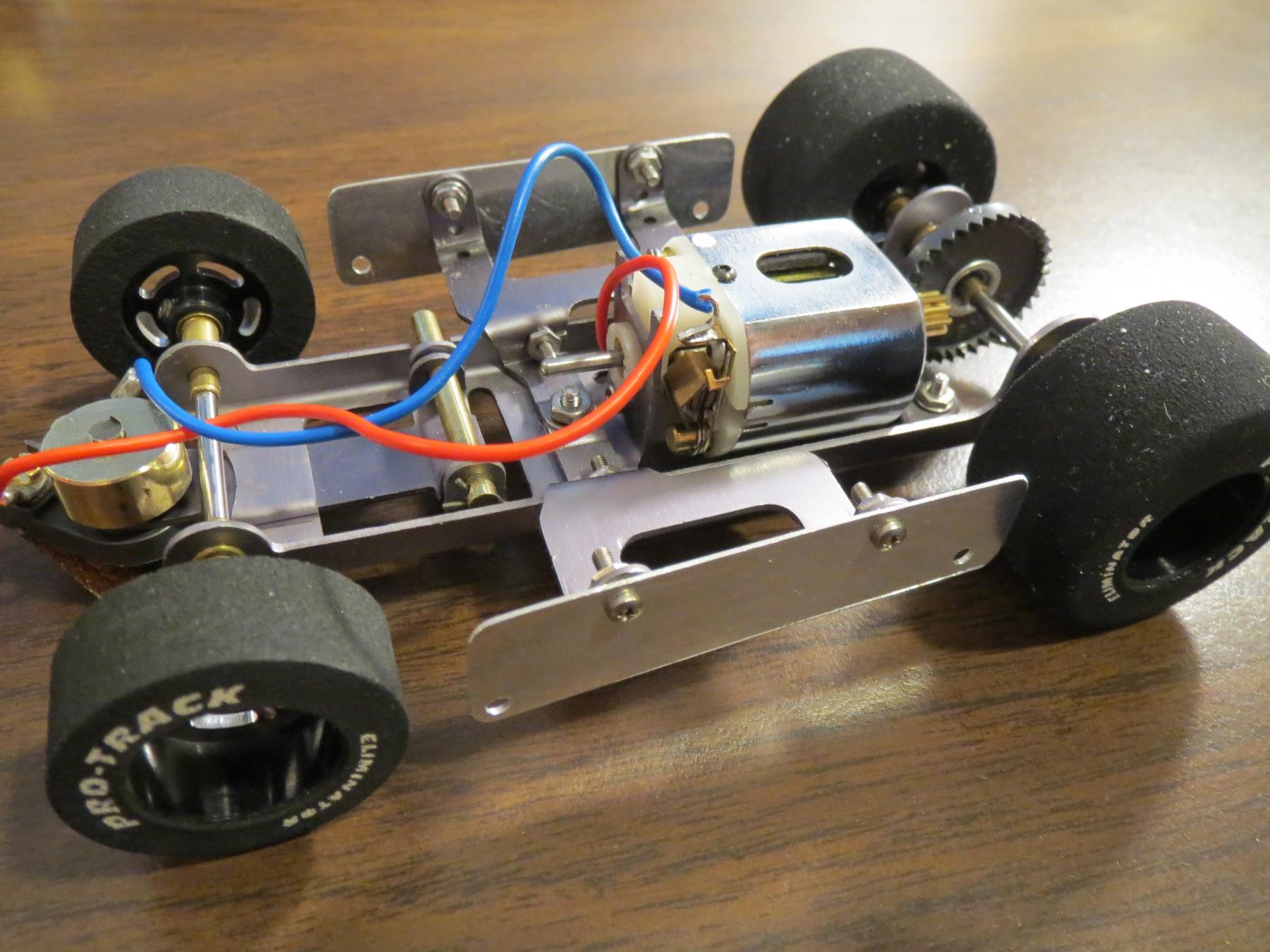

The Dubro bodied car got a bit more custom stuff. Along with just a standard Classic drop arm chassis,I added the Pro Track wheels with 3/32 hardened axles ,custom spacers,and shimmed the gear to 3/32.The tires are WAY big and just for looks. If I was to actually run it,These would need down sized. This one got a Havlicek HOTTER 26D with a custom wound arm. (It dynoed out at 950 HP/600 ft lbs of torq @ 120,000RPM .... naturally aspirated  :laugh2: ) I had a bit of a mishap pressing the pionion and busted the end bell :/  Got it replaced and all is well. ;) I added the plates to the body mounting on this one as well.That Classic body mount is just not all that great as far as keeping the body side from distorting.Also helps to lower the outer body mounting screws to the lower rocker area.  :( Since I didnt have a drop arm hinge pin tube come with this when I bought it, I used a piece of brass rod and drilled it for a retainer clip.Just standard assembly checking and all brass polished up nice.

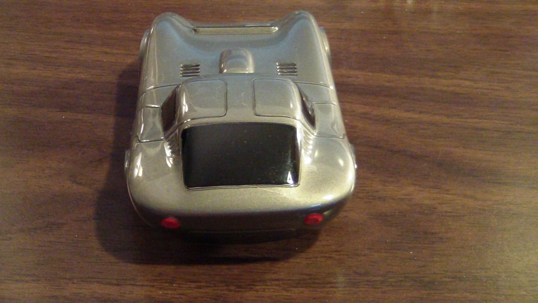

Ok, Since I have already fitted and painted the Classic body awhile back,I will now do the wheel wells on the DuBro body and shoot it..I am NOT really all that proficient with body masking or painting.With coaching from Pros like Mr. Pablo and Mr. Noose,I seem to get by some what.I wanted a fairly cool color,so I mixed some flat and gloss black with some metallic silver.(about a 1/3 each) I came up with what I think is a pretty good looking gun metal metallic color.After drying it each time between about 5 coats. I decided to "tint" all of the windows. This is something I LOVED that Noose originally did to my Cyclone Avenger. and I decided to try it on  the Dubro body.
What do you think?
Something else I have been doing quite often is adding body armor tape to the places the painted body contacts the body mounts. REALLY good about keeping paint from getting scraped off when mounting/unmounting.
