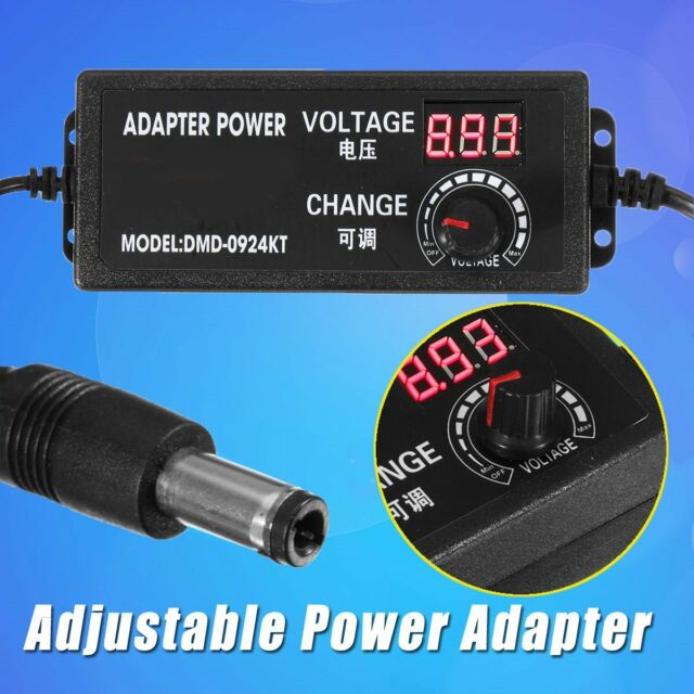

I like the idea of no gears. The track hire will be looked after by staff that have no clue for repairs / maintenance. That will be me, no doubt with several call-outs a week!

As Mike says, motor size is not that important when you can simply change track voltage.
I used to stick a whole lot of diodes in the rental cars to slow them down but now power supplies are getting so  much cheaper. I bought eight of these... I tried it on my Hudy and it works a treat.  Puts out 5 amps, is self-regulating. and only costs about $10 US. Available from HERE.
I just updated above seller information. Has power suppliers in various voltages and plugs. See post below.
  • MSwiss, Tim Neja and NSwanberg like this

Downunder do you run at 110v or 220v?
I cannot find the input voltage requirements?
SUPPORT YOUR LOCAL RACEWAY!!

Posted 03 June 2019 - 05:54 AM
220 volts.

Posted 03 June 2019 - 07:02 AM
Self regulates; there is no switching required. It operates on both voltages. You can order it with a 2 pin USA plug or Euro round pin.
There are a few on eBay selling the same item. That seller has change his product slightly.
Check out THIS ONE.
