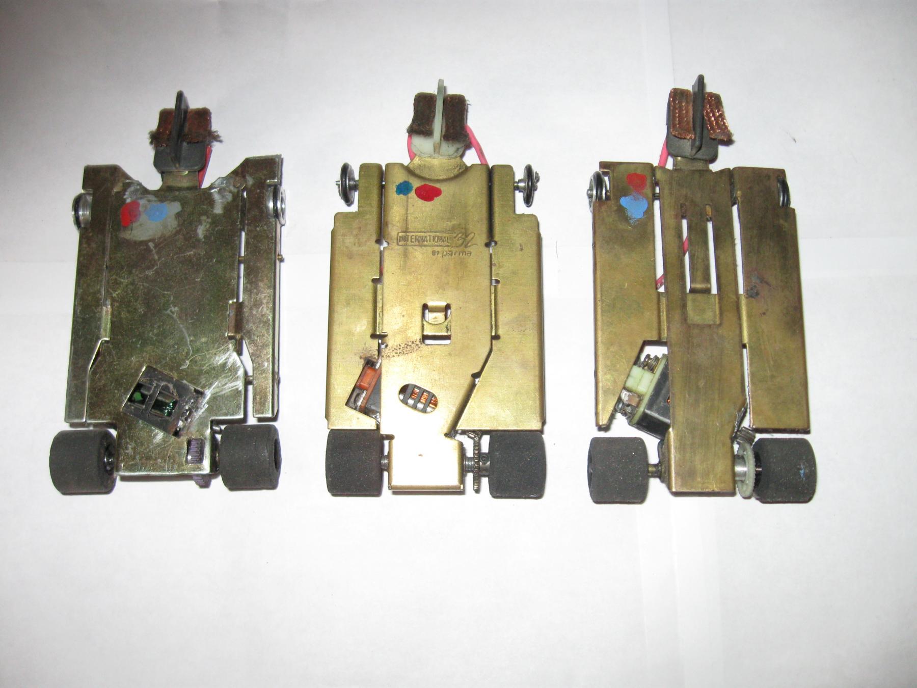

Here are the three types of chassis we ran in IMCA, just as I ran them.
The Eurotoy is on the left. i did not add reinforcement to this steel chassis. The Parma International 32 is in
the center. What you can't see is the piece of 3/32nds brass tubing soldered next to the motor that connects
the motor to the chassis center section, making the motor can the reinforcing member. Never found the need
to put a crossmember joining the rear axle uprights. The Pro-Slot Demon is on the right. The reinforcing
piece, 1/16th piano wire, can be seen joining the motor and the two uprights. The Demon had the most
incidents of center section bending at the narrow area behind the motor of the three. Using the motor can
as the strengthening point seemed to work just fine on the Parma. Otherwise use of lead where you see it
worked fine for me. All motors are GP-12.
- MSwiss, Pete L. and Geary Carrier like this
