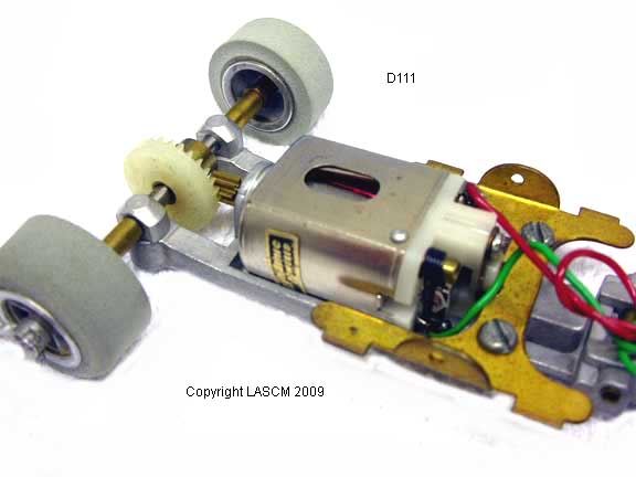

I was entrusted in restoring one for a friend, and happily, the body survived quite well, virtually intact. It was very dirty and had hardened grease on its motor bearings and axles, requiring a solvent bath to loosen the solidified lubricant. This is what it looked after disassembly and superficial cleaning:
Originality is most critical to me in restoring real cars, real motorcycles or slot cars, so it was important that the job be done right. On this example, both front and rear original wheels had been lost, replaced by substandard items.  I was able to trace and obtain the correct front wheels and tires, beautifully cast “American Mags” so popular on hot rods in the 1960s and… today. But I could not find the correct rears, so I temporarily reconditioned the rears that came with the car, hoping to find the real thing soon.
The aluminum chassis, the brass body mount, tiny 5-50 brass jam nuts and axle spacers were corroded, so they were tumbled to bring them back to their correct finish. The body was washed with soap and water to remove a layer of built-up grime and rubber debris. The original stickers were not damaged in the process.
The motor was cleaned, lubricated with synthetic (won’t harden again!) and its lead wires cleaned from accumulated grime and oil deposits. NOS braided contacts were fitted. The crown gear was also cleaned from hardened greased and its brass hub polished.
The owner has the original box, but the printed insert is gone and the foam on which the car was standing has rotted.  I will make a new foam insert for his box and print a replacement insert. This is what it will look like when completed:

The entire car was priced at $16.95, a fortune at the time! Here are pictures of the "Green Hornet II" motor, that came in a few variations over its 2-year life:
All had red wire, # 28 AWG, about 60 turns. All were made from the stock purple AMT/Dynamic "Hornet" motor, opened, their can repainted in light metallic green right over the purple paint, the armature stripped, a better commutator fitted, then rewound and dynamically balanced on the Tradeship dynamic balancer.
The first were clear varnished, then balanced.
The second had their stack sanded-polished.
The third had their stack machine-polished.
Last issues had a Kirkwood commutator.
Within all these, some could have fat screws retaining the endbell after the tabs broke, the later used push tabs.  All receive a gold and black Dynamic sticker.
In 1967, the very last (and rather rare) Super Bandit received a new motor, made from the updated Mabuchi FT16D with a ball bearing replacing the gimbal bearing in the can, a new nickel plated can with oval vent holes and a Mura armature.
