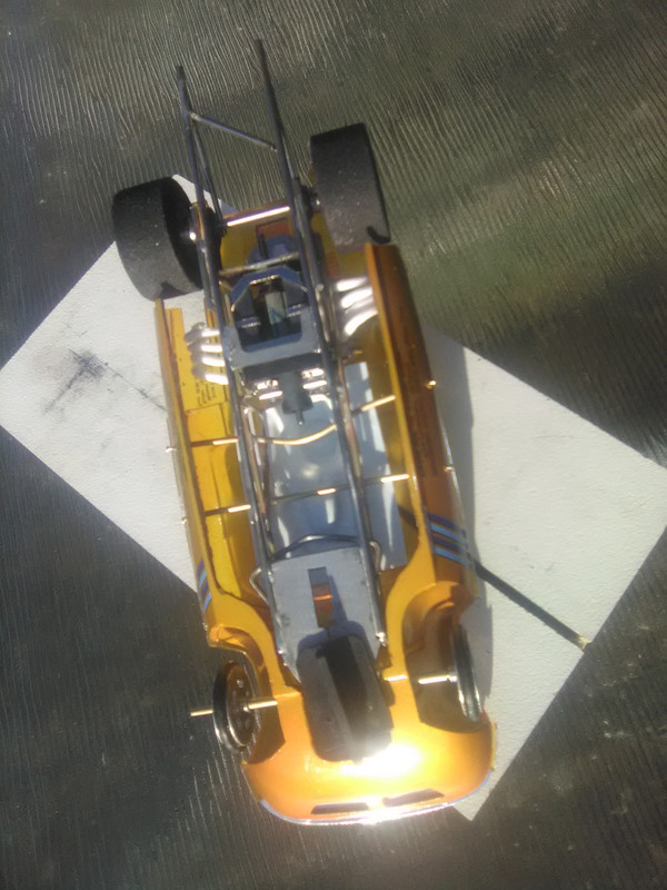

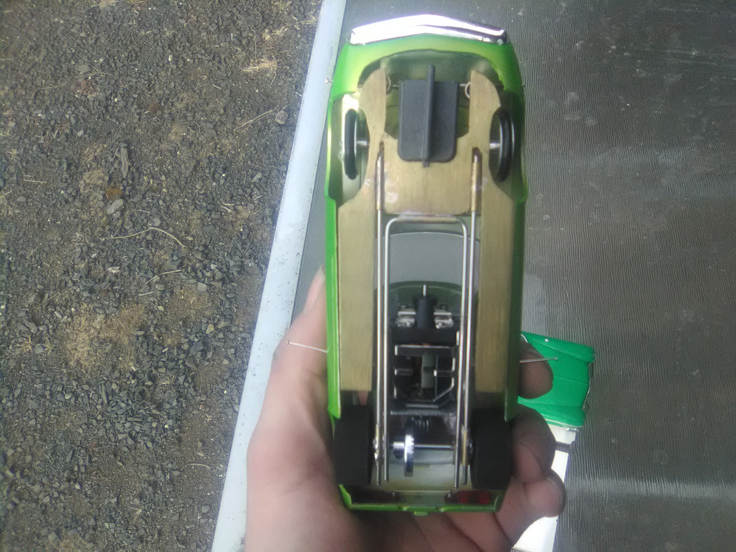

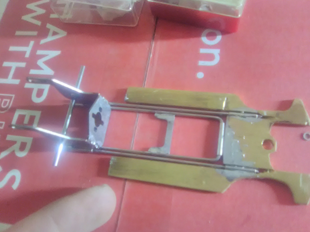

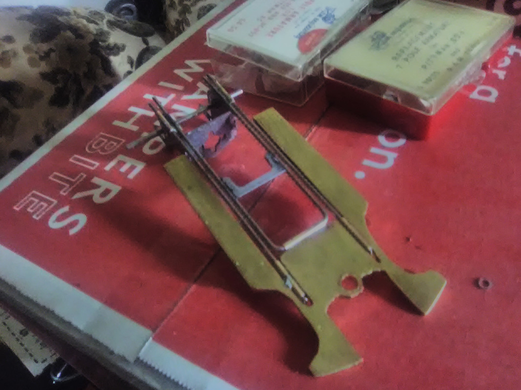

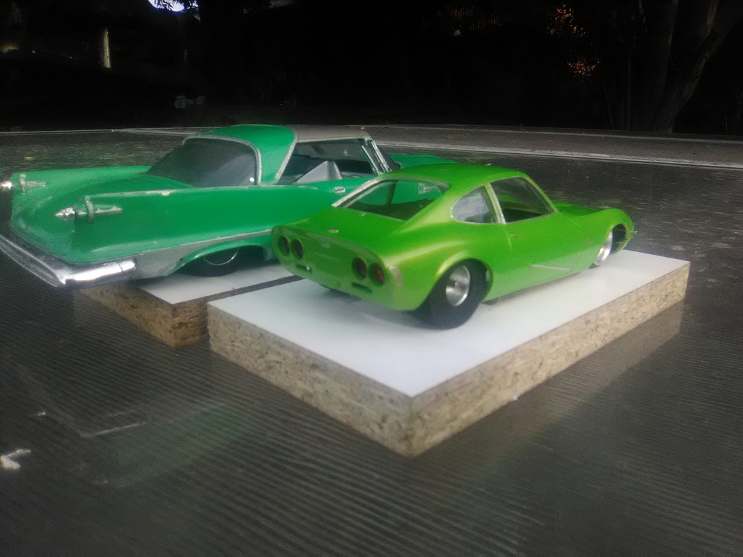

Just did a build on this '70 Opel. I made my own front section from 2 mm brass rails are 1/16" TIG wire. Rear bracket is locally made.
Gonna try a Pro Slot 'Crazy Horse' in it. Total weight is around 160 grams.

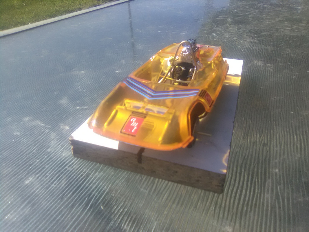

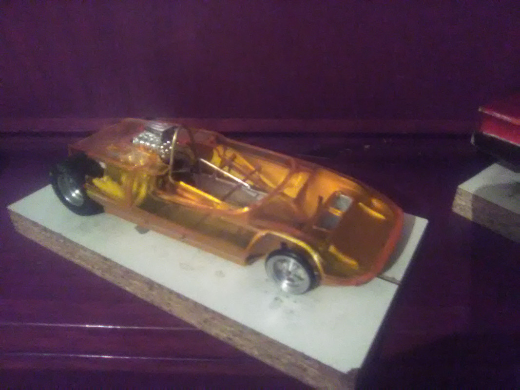

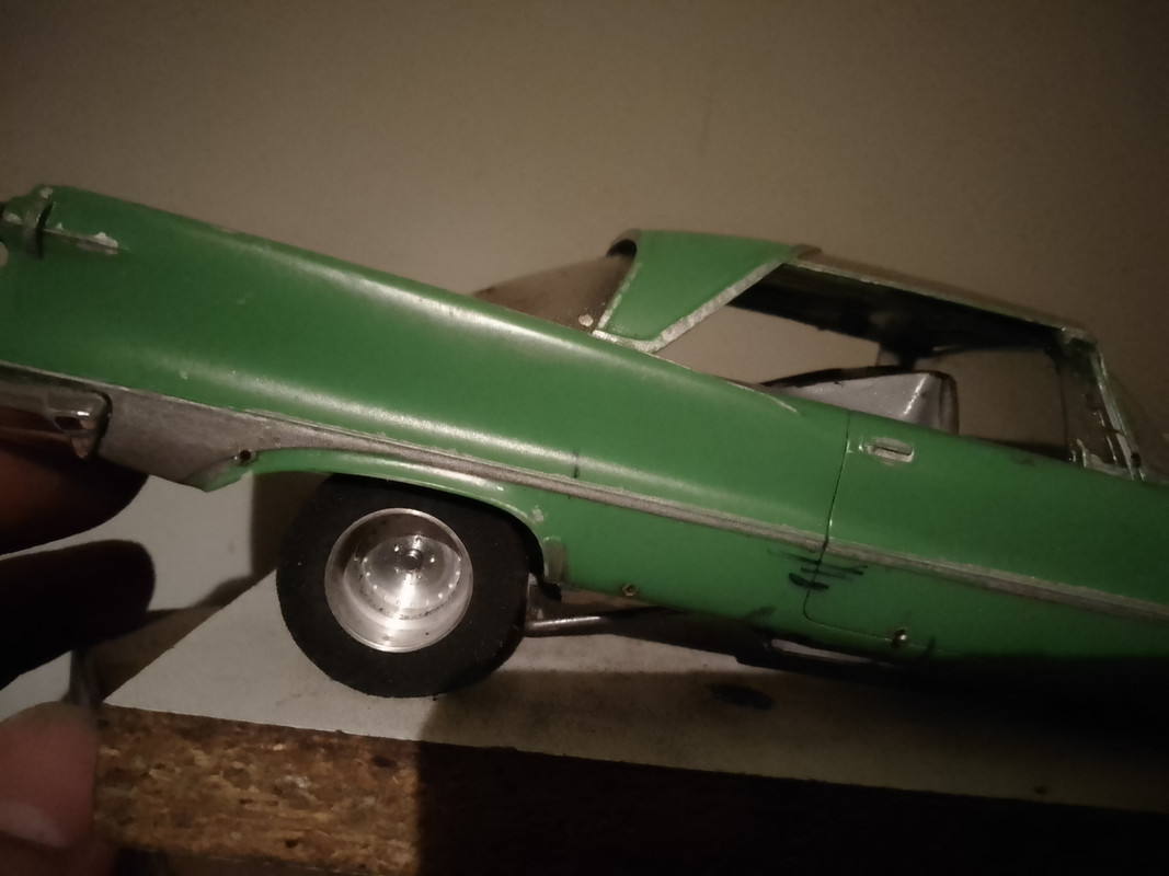

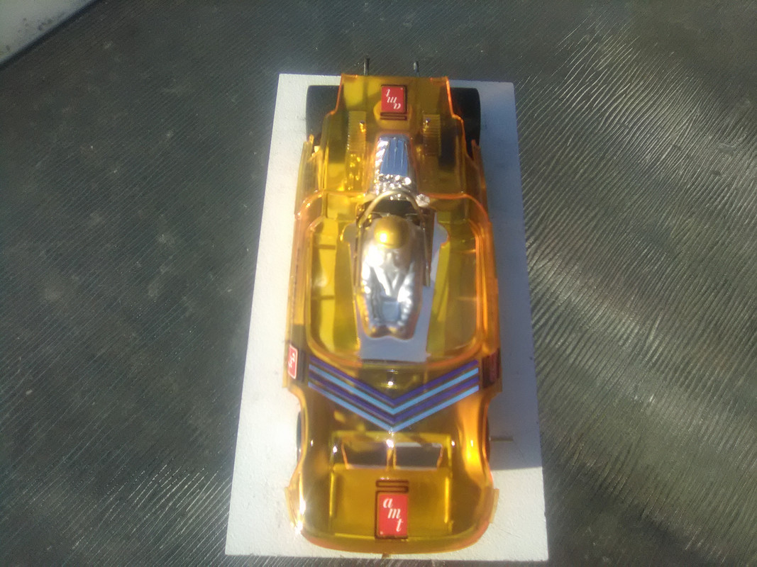

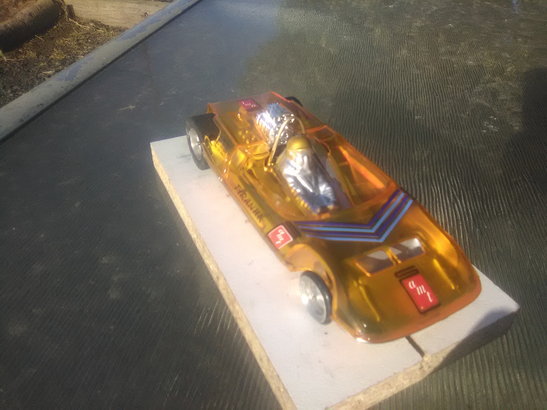

Another recent build of AMT's Piranha Funny car.

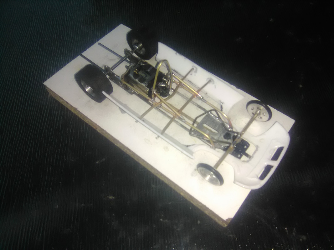

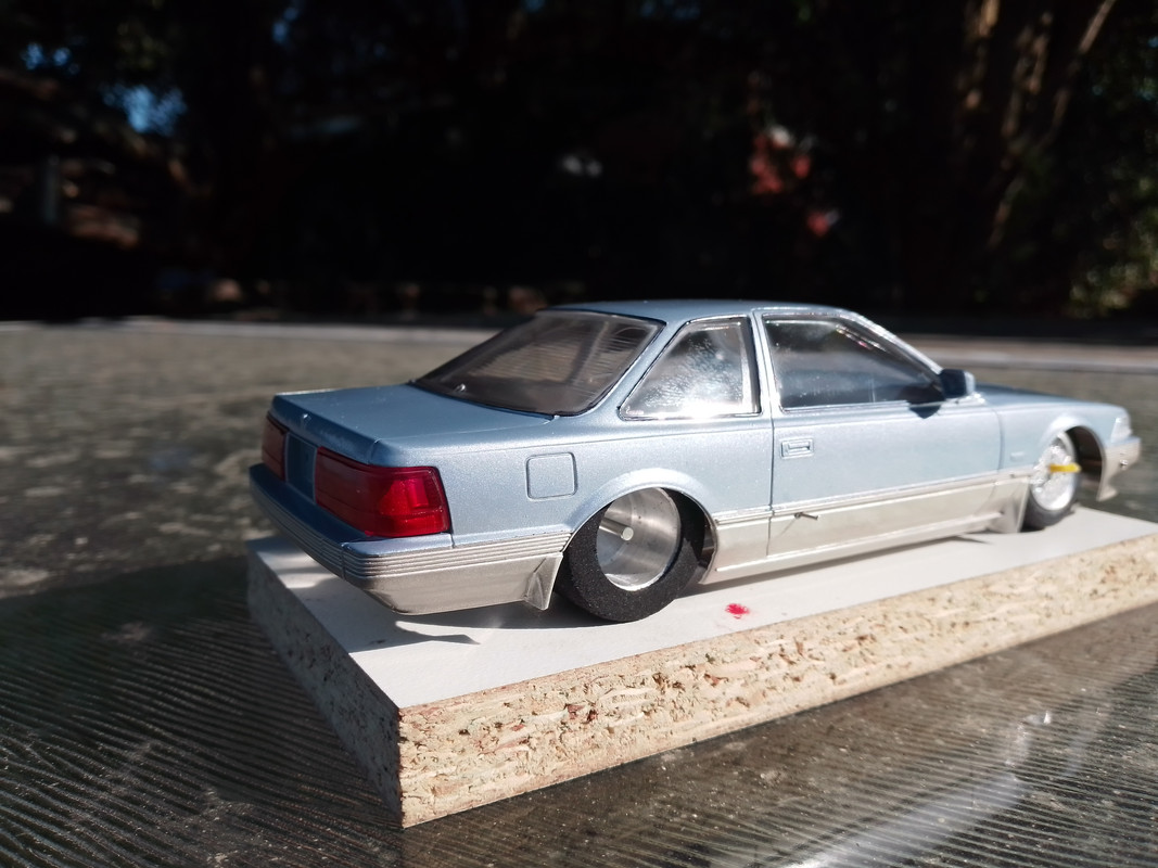

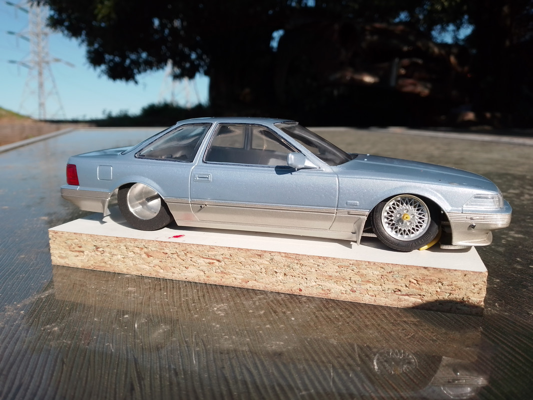

Another no bar car with a home made slip joint chassis.
This one is based on Tamiya's 1989 Toyota Soarer front section was laser cut to my design motor is a Pro slot boss .490.
  • Phil Smith and Slot Car Rod like this

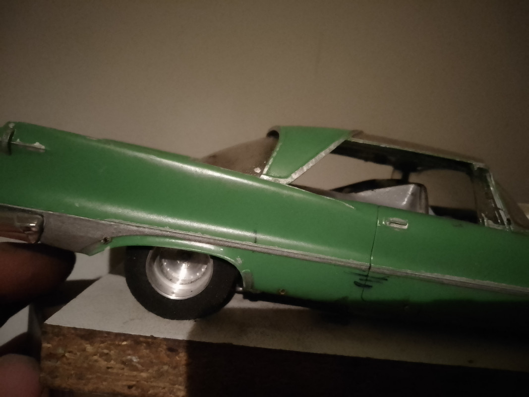

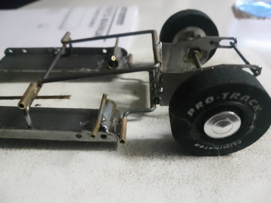

Been playing with a 4 link setup on a couple of cars so far they seem to be handling alright & have been consistent.
