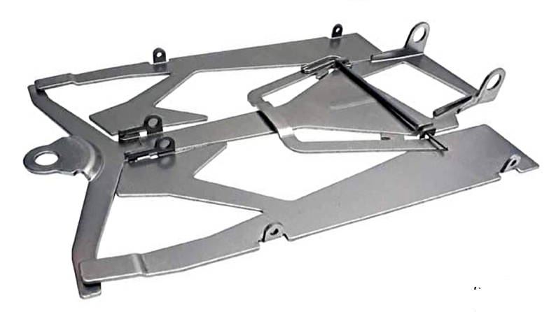

So there’s a new flexi chassis out, the first new stamped steel chassis since the C43 in 2016(?)
When you get one (mine is stuck somewhere in the Pacific Ocean) please share your thoughts and reports.
I expect it will be submitted to ISRA and USRA.

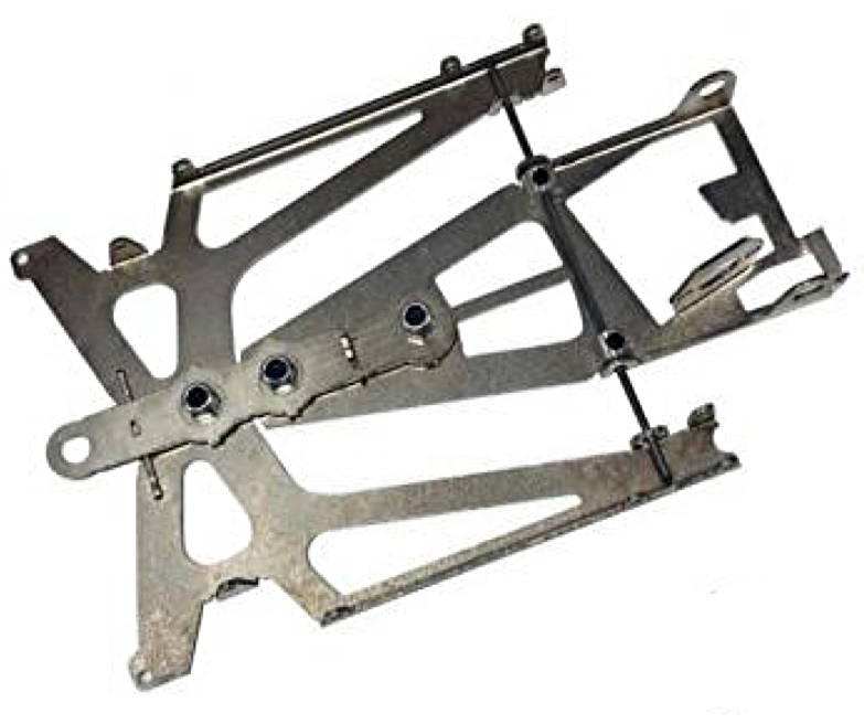

There are actually two since the X43 chassis - both by Mid-America. Here is the first one called the Mercury:

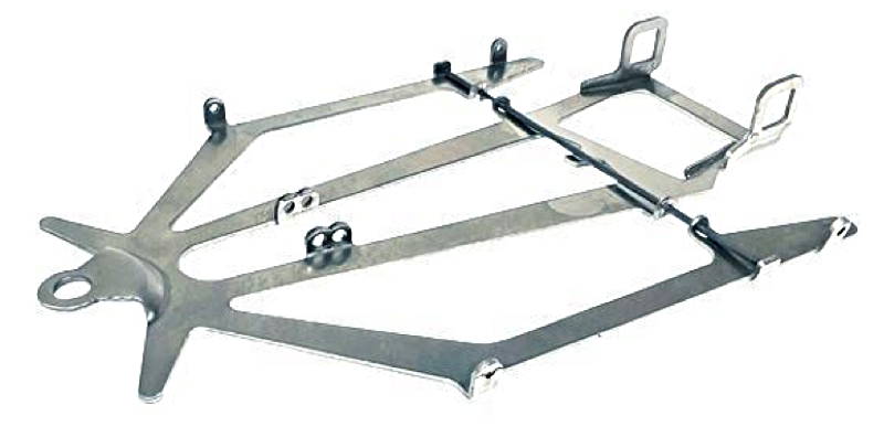

Mid-America also had the Salvator stamped chassis:

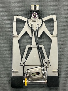

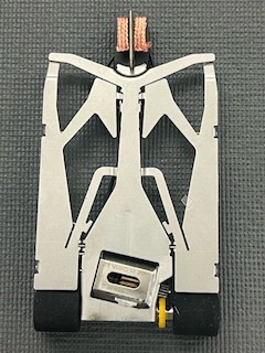

Before and after flattening
It was quite easy to flatten and the back end is now perfect - no tape required at all to stop pans hanging down below centre section
I tumbled both pieces to remove all the sharp burred edges which are on the underside of this chassis
Excluding tumbling, it took me about an hour and a half start to finish, which isn’t bad considering first time with this one

Looks like it flattened out nicely.
How thick is the material?
What does it weigh as it sits on your block?

That pic you reposted is before I flattened it
45.77grams

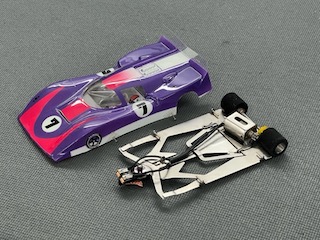

I built a couple this weekend. The center section is a breeze and the rear motor box and uprights are well done. I maybe had 15 minutes into the center section to get it perfectly flat. No forming bulges on the bottom is a really nice surprise. In front of the motor box required the most amount of work, no differently than Mossetti or JK. It is an important area I feel as it dictates J bar movement. It was really easy to manipulate it flat quickly. The pan however has a lot going on and many areas to deflect during the stamping process. It took almost 2 hours to get what i felt to be a national level of flattening. THe rear of the pans took the longest. One thing that I really liked is how easy it was to adjust the rear pan crossover bar. This design is superior to the JK in that it allows you to manipulate it without throwing off all your prior work. there are relief cuts next to it which i believe to be the difference maker. The spy vs. spy weighted section at the front of the pan were wonky, but flattened as they should with the process. Weight wise Aeleos vs. Gemini was 94.4 vs 94.2 with same options. The Gemini came in a touch lighter due to a little less lead wire required.
On our hillclimb the Gemini was very smooth. I am going to go out on a limb and say the smoothest flexi i have driven. It really transitions well from the donut to the lead on and I imagine that this is going to make it great on flat tracks. Initially it was 1-2 tenths off my best equipment. I attributed that to a new motor that I just threw in the car without any break in. Yesterday after Leslie raced it Saturday we had it at 1/2 a tenth off my best car and lap time. There are moments to where I felt like it wouldn't come out and i found myself over driving the dog leg which is not uncommon for me, just that this time the car stuck. Rigidity testing was not really tested as leslie never really had any hard shots. Post race the car was still flat with very little massaging required. Only tape tuning that i did was at the front of the pan to the center section whiskers. I shimmed under the front tabs to whiskers .007", under the crossover bar .010" and under the J bar .007" Will try limiting the rear of the pans this weekend.
My only negative (which really isn't) would be that it may not always be the best choice for a high speed king or similar style track The car is a tad slower through the bank as the spine of the center section will at times make contact with the track. The opposite of that is that it is crazy good on transitions and tight 180 turns. Trade offs for everything. This weekend I am going to add some support to the spine and am expecting substantial gains for banked tracks.
I like options and i think it is worthwhile to keep a couple in your arsenal.

PS: nice paint Matt
