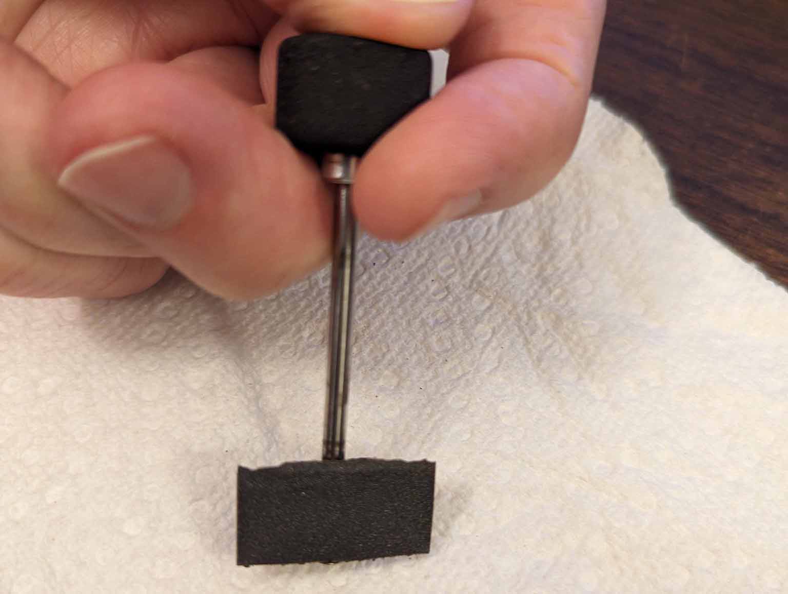

As DZ said in post #10, "Make sure you log a lot of laps when scuffing in wonder rubber.".
FWIW, there are three things I do to reduce the time it takes to run tires in (scuff them).
1) I sand the tires with a grit that is finer than my truer's drum.  I use 220 grit sandpaper stuck to my sanding tool with double-sided tape (see sanding tool below).
2) I give the tires a little bit of "cone" shape when sanding them (smaller diameter at the outside than at the inside, which is how they naturally wear).  I do this by holding my sanding tool offset towards the outside of the tire.
3) I sometimes put a high-downforce body (such as a GTP body) on the car for the initial laps.
Note:  I use Dritz Adhesive Res Q double-sided tape found in sewing departments, to attach the sandpaper to my sanding tool.  The Dritz tape is thin and very sticky.
The sanding tool I made
The sanding block on my sanding tool pivots freely, removing the possibility of a tire ending up with an irregular shape
