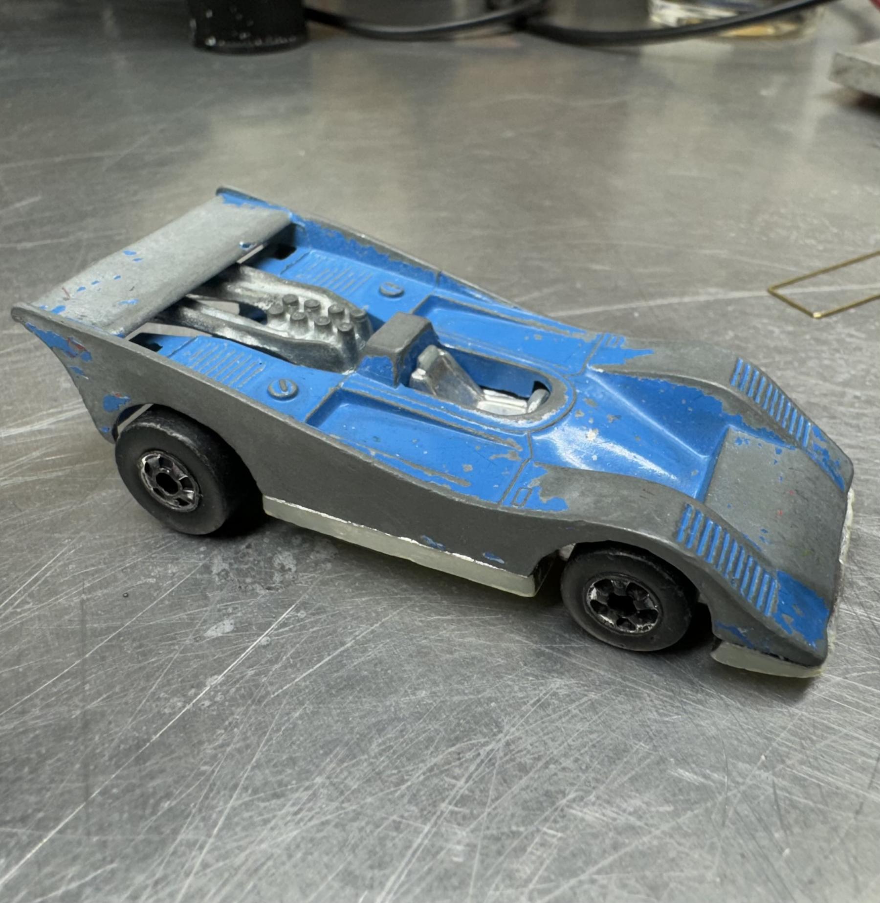

for some reason out of nowhere I started getting more interested in old hotwheels. Ive always thought the redlines where cool but never went out of my to collect besides always keeping eyes peeled for them at thrifts stores. got some black walls at the thrift for fun ad thought Id practice a resto.
this was an American victory? I think its called? super beat up base is bent and front chipped chrome missing. front of body is bent down and rough so wasnt worried about ruining it.

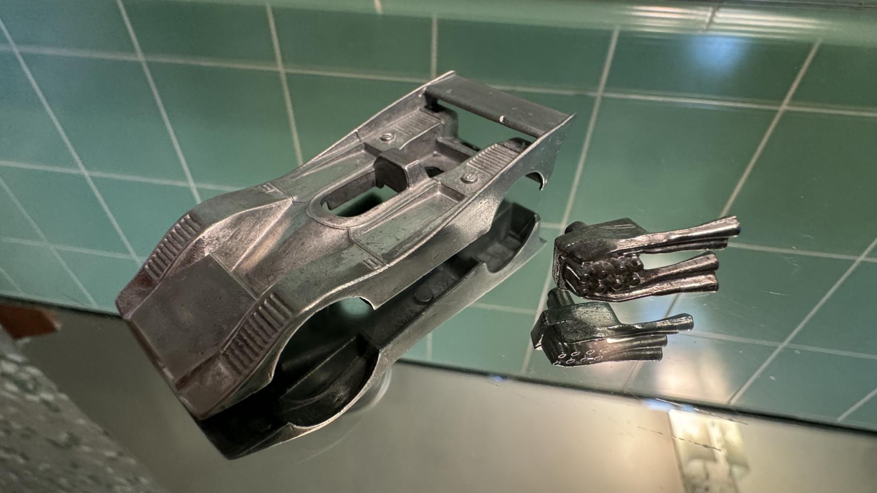

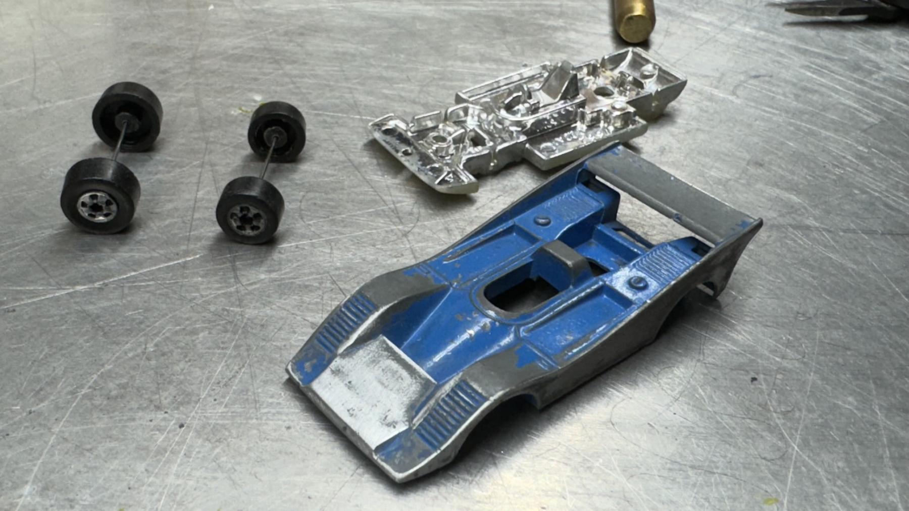

Some filling and bending got the nose better. also removed the rear wheels as one had a big melted spot on it.
after paint stripping and more sanding and some polishing. I know you need these to be like a chrome if you want a spectraflame type paint job which I sorta want to do:

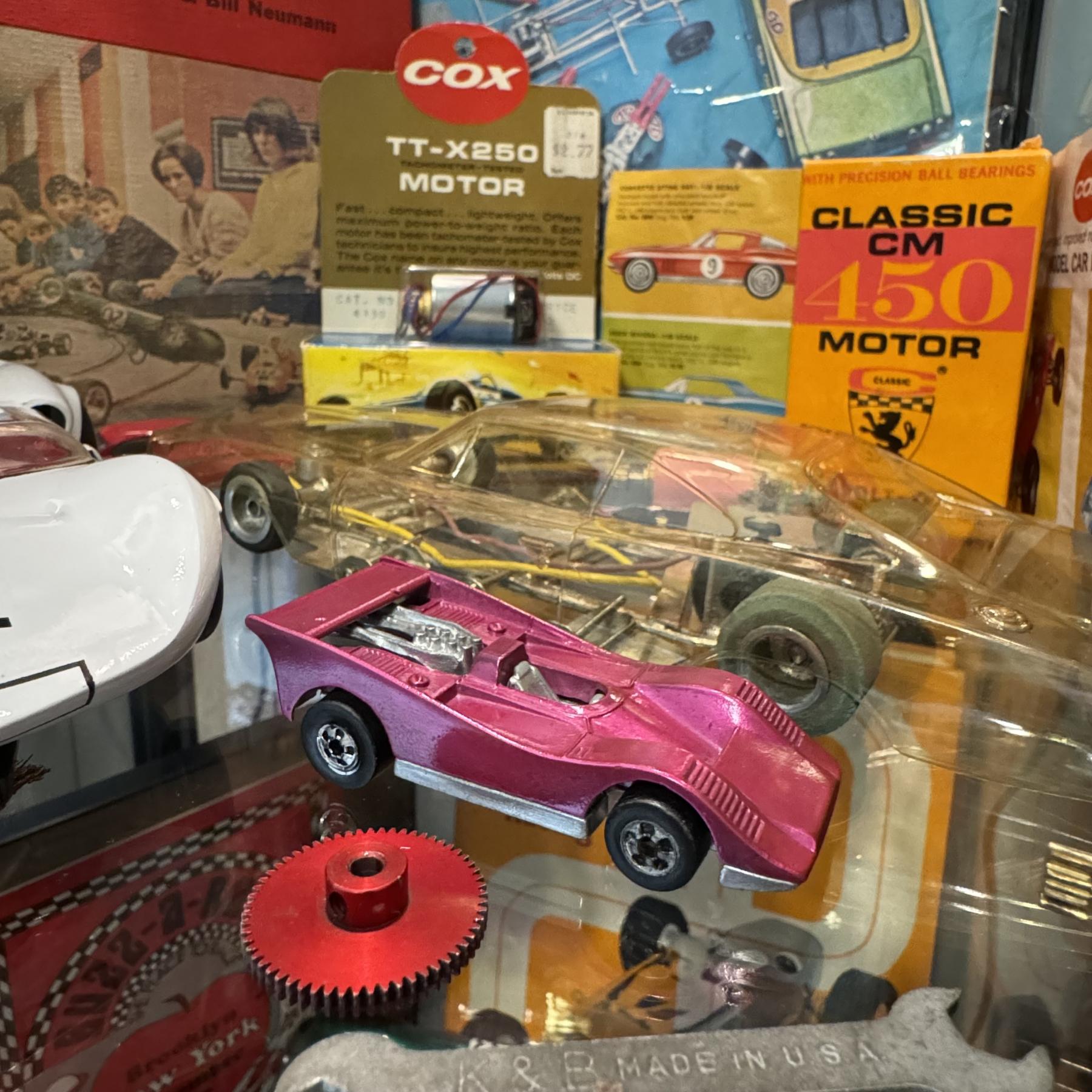

no other pictures in between but this is what I ended up with. I airbrushed some neon pinkish looking nailpolish that is pretty translucent and clear coated with spray max 1k. give a somewhat spectraflame appearance. I also heated and reshaped the base and molotow touched up the missing chrome and touched up the chrome on the wheels.
The front post kinda press fits and hold on the base but the engine on this double as a body post for the year so I tried to drill and tap that and lets just say it didnt work out. broke a drill bit off in the post. so I had to dremel a slit in the post to get the bit out. then I broke my tap off in the post so at that point I gave up and just glued it all together in the back haha.
Still looks better than what I started with might be worth a $1.50 instead of 50 cents now haha

Yours looks great. It is a prime example of how much the proper prep influences the finished product.

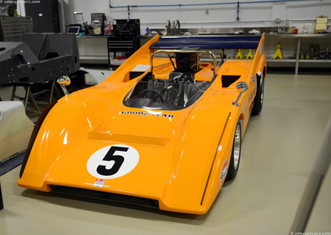

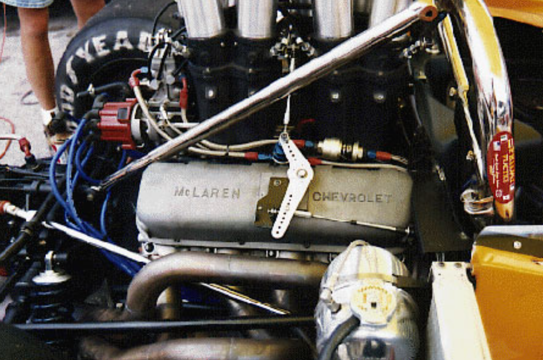

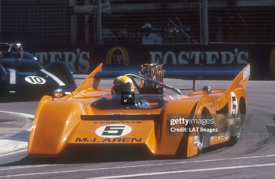

It is closest to a McLaren M-8D, but there are a lot of differences. On the real car the location of the louvers are behind the front fenders, not in front. The air intakes on top of the body are NACA ducts. And, of course, the exhaust exits under the rear of the car, not over the top.
You can see the headers running under the car.
The M-8F rear wing is similar, but some details are quite a bit different.
Chances are Mattel changed details on the models to get away from licensing issues. And to appeal to the younger kids.

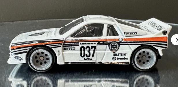

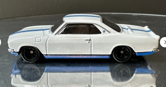

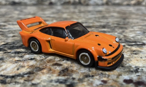

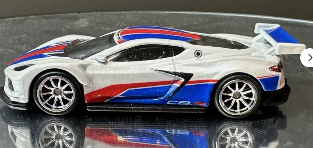

Looking around, I found that Hot Wheels has a "premium" line that are actually pretty good models.

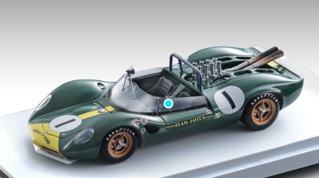

Not at the level of detail found on the much more expensive die cast models;
But certainly I can see the interest in restoring, or even upgrading, the older, "well played with", Hot Wheels.

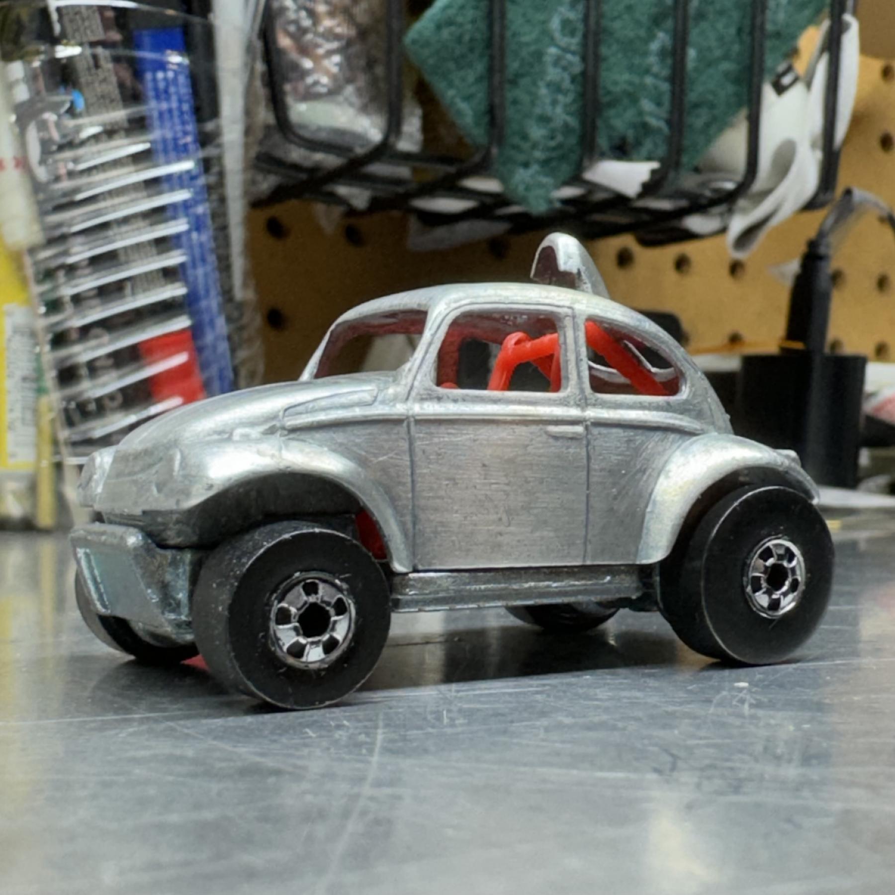

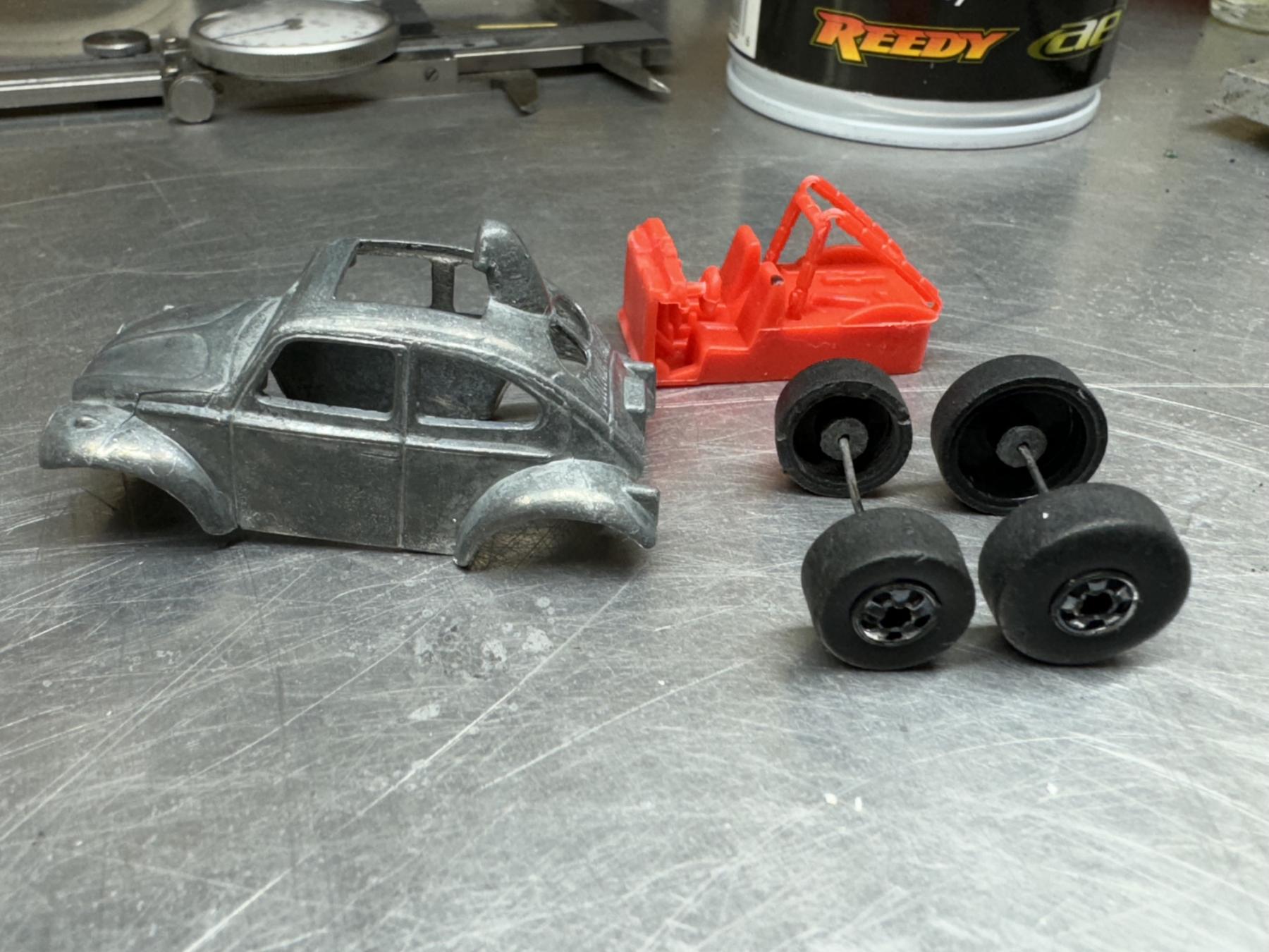

Didnt get a before picture but looked like it should have been tossed.
I must have really liked this one and played with it outside on the concrete with how tore up these wheels are!

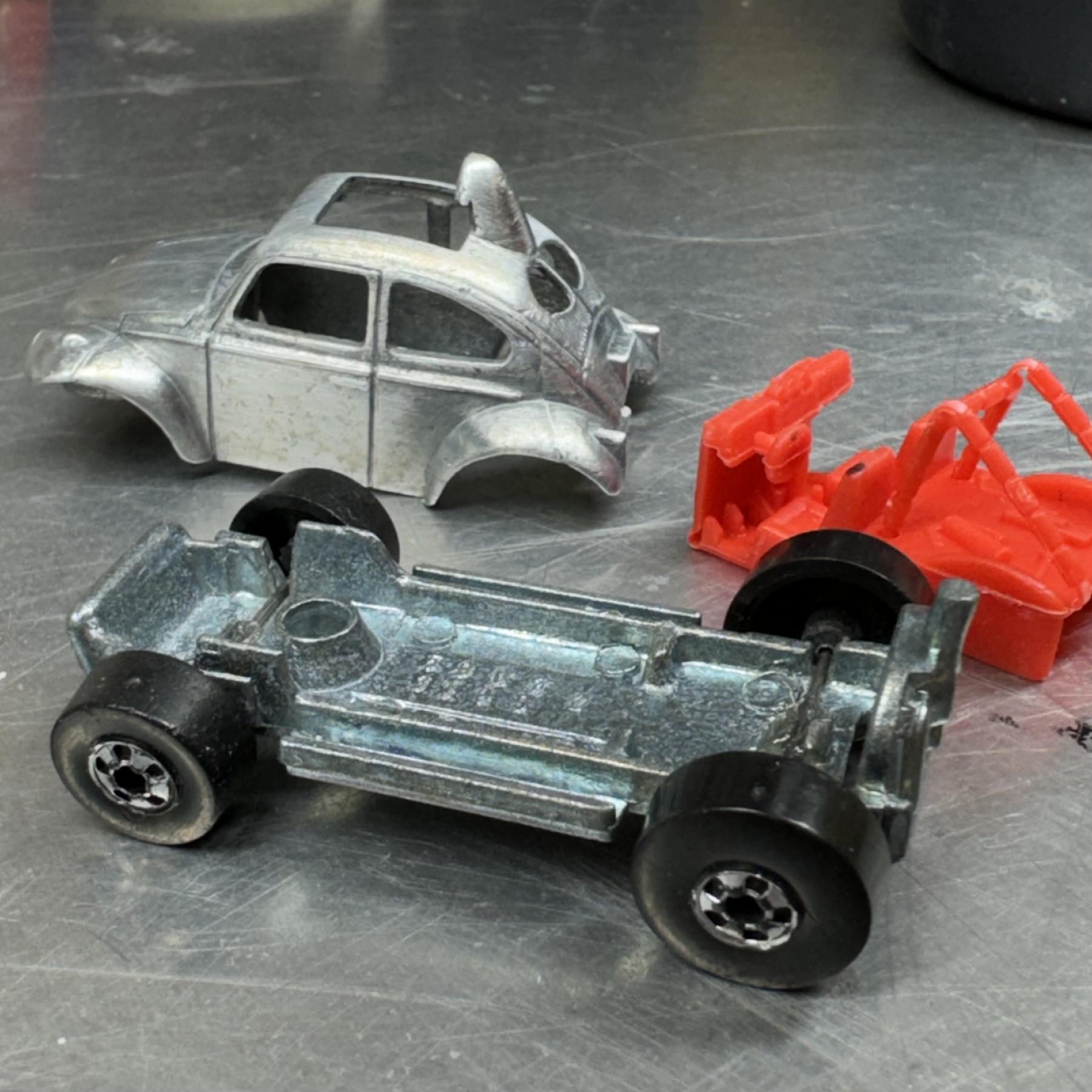

I stole some nice wheels off another car and swapped them out along with straight axles.
the casting on this is really rough. I didnt want to get crazy sanding mold lines so I just tried to get the metal shiny for another attempt at a spectraflame paint job. mostly doing this to try and fix up a actual redline at some point.

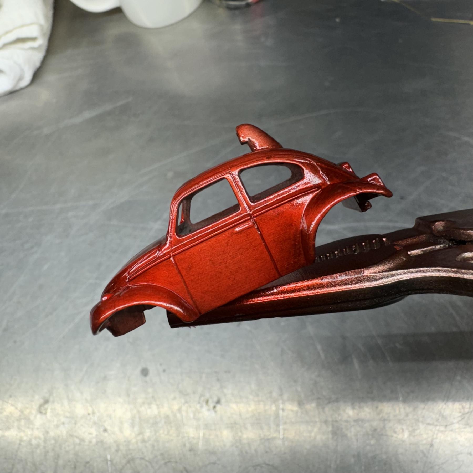

Tamiya transparent red acrylic with a minwax polyurethane clear. Guess I need to figure out how to galvanize coat these to get them to really shiny so they extra pop.

At home nickel plating is pretty easy and should provide a high shine prep.   It would benefit the chassis too in future builds.
