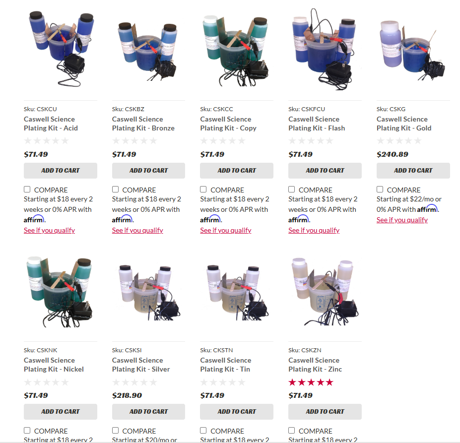

A light dusting of silver or gold will even out the translucent red and get rid of the blotchiness. One thing I would definitely do is to spend a little time with a jewelers file and smooth out the witness lines from the die casting mold.
Home plating is pretty easy. A bit dangerous because of the chemicals involved. Here's a fun video on how to do it;
https://youtu.be/G-P...ySbNviit02pvt9Z
If you are not quite that adventurous, Caswell sells plating kits that are very easy to use. At All Star we used them to plate pre-production samples of metal parts the customer wanted plated, as they would be when finished and ready for use.
These kits will do a lot of Hot Wheels bodies. Think about 75 cents to a buck per piece. The gold and silver kits are naturally more expensive. And if you want the paint job to last for ever, they have black anodizing kits as well. Black anodizing is far better than any primer on the market. Neither zinc nor nickel plating will improve surface adhesion of the paint. But there are model railroad paints that you bake in the oven at 1250 for a couple hours, that will adhere to the zinc bodies very well. Paint doesn't stick to brass very well either, so I have been using Scalecoat paint for going on to 60 years on my model locomotives.

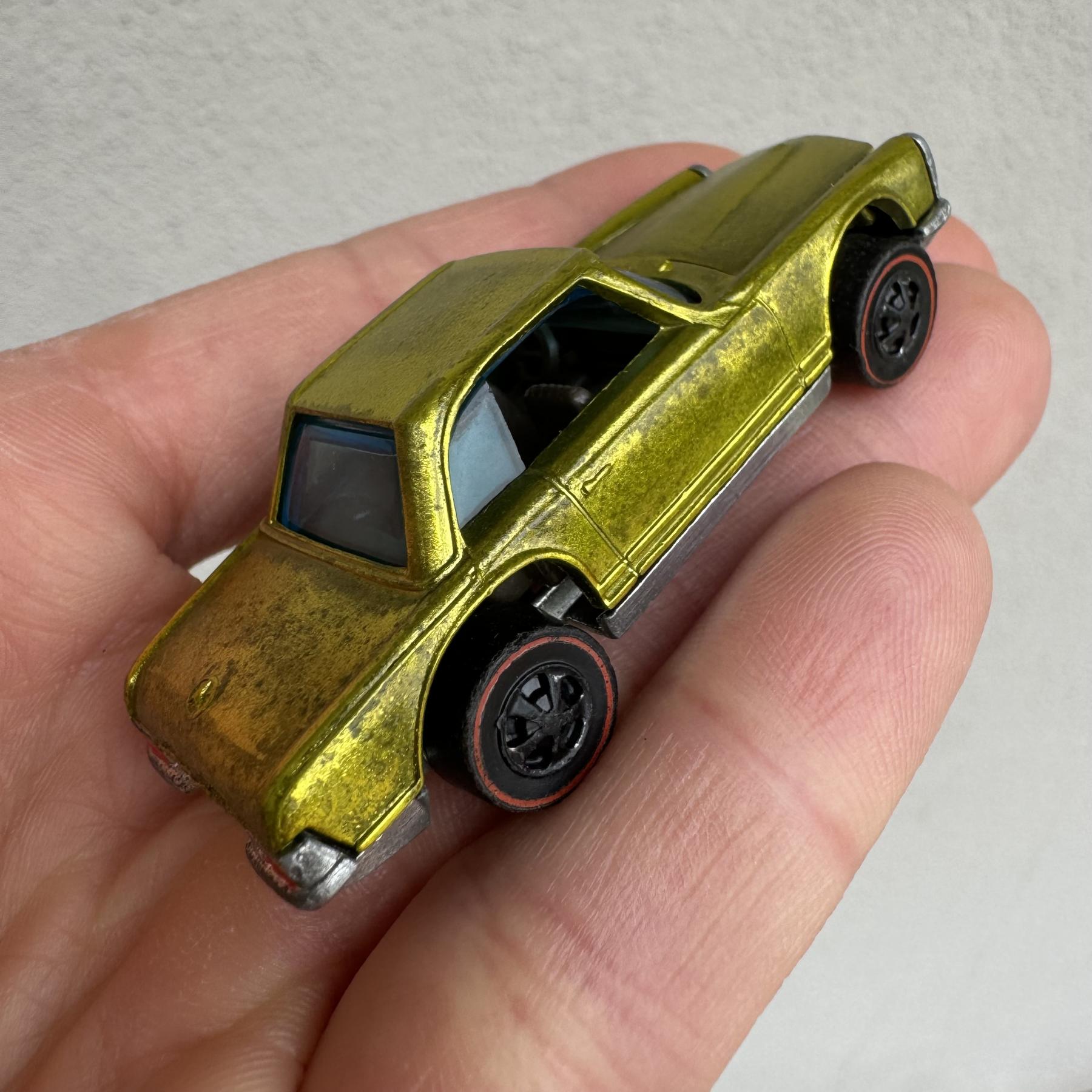

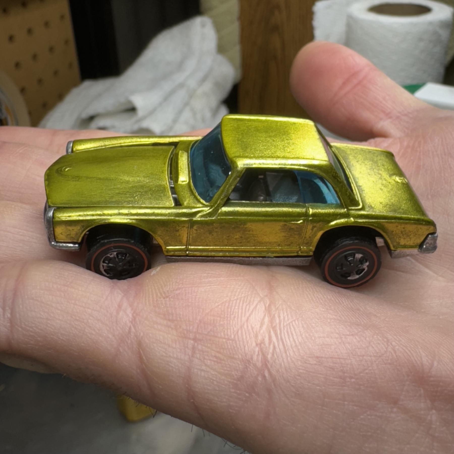

Ok tried on a redline. Only polished casting no replating or sanding. I only cleaned up the leading edge of the hood.
Before:
After:
doesnt look brand new like some people make them with the toning. but it sorta looks like an actual original car which is kinda cool. I polished the windows also.

The blotchiness was caused by surface contamination. Before you plate anything, the surface has to be polished to a mirror quality. The easiest way is to use electrolysis.
https://youtu.be/MG3...AA24mA5z1FzEtyF
The downside is that this method uncovers the pits in the zinc that developed from oxidation over time. The only way to get rid of those is to mechanically polish them out. It's at this point you have to decide if you really want that plated finish, of if painting will suffice. The pits can be easily filled with a good primer. Here's a video on prepping the zinc die casting for plating;
https://youtu.be/EQF...q-GoCvD_5XEGhJH

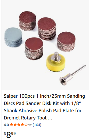

Some of the pits can be polished out with a rotary tool like a Dremel or a Fordom flex shaft. A soft pad sanding disc arbor works good with a fine (320 grit) disc to start, then a very fine (400 grit) disc to finish up. Practice makes perfect if you haven't done this before. I also like to use the Diprofil with the sanding pad attachment for doing flat areas that are near a raised edge. I like this sanding disc set from Amazon. Since I ended up with extra mandrels, I trimmed the velcro area off by spinning it in a Dremel and carefully trimming it with a #11 X-acto. This left a flat contact face I could use the self-stick Artco discs with.
Once you are done with all the polishing, a good cleaning like in the video, and washing in water with a small amount of dish soap added. At this point you don't want to touch the part with your bare hands. Use a pair of white cotton gloves to handle the part after washing because the plating won't take to any fingerprints.
thanks for all the info. The roof and hood was surprisingly shiny and polished. apparently still not enough to get a good finish. transparent yellow is also a bad color to try and hide imperfections I’d imagine. I’ll do a bit more on the next one to get it shiny.
