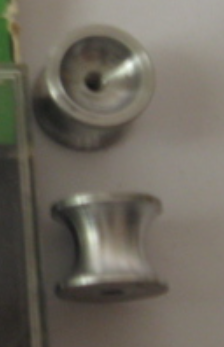

#18 Dave Crevie
  • 4,878 posts
Posted 11 August 2025 - 09:13 AM
These are the wheels I was referring to. The German rubber is stiffer, but we used them because the softer tires tended to explode. The natural JK donuts are what I use for all my old timey restorations. Work perfectly by my judgement.
