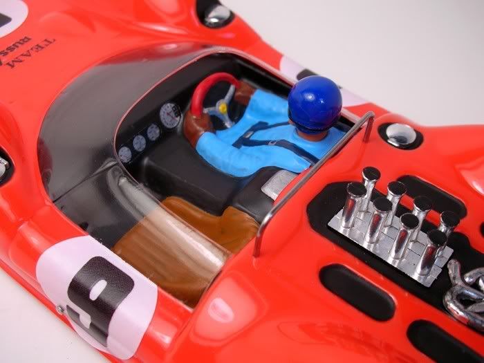

Here's the finished Mike Morrissey - Rod & Custom Series tribute car:
Mike told me he often painted his cars orange so orange it is:
I love wheel inserts :wub: :
Russkit's chrome bits just make there bodies pop:
Can't wait to try it at Eddie's ;)
Onward...........
