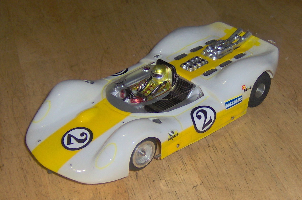

Posted 01 March 2009 - 07:34 AM
Many thanks to Mr. Mike Boemker for the Lotus body, & to Mr. Barney Poynor for his excellent painting effort... :)
Track-testing on the MTT "flat track" & the Gearding King confirms... it's runs great!... ;) ... Easy to drive, & very predictable...
Looking forward to our next Jaildoor demo, during the Convention ...
Thanks, everyone! ... & good racing !! ;)

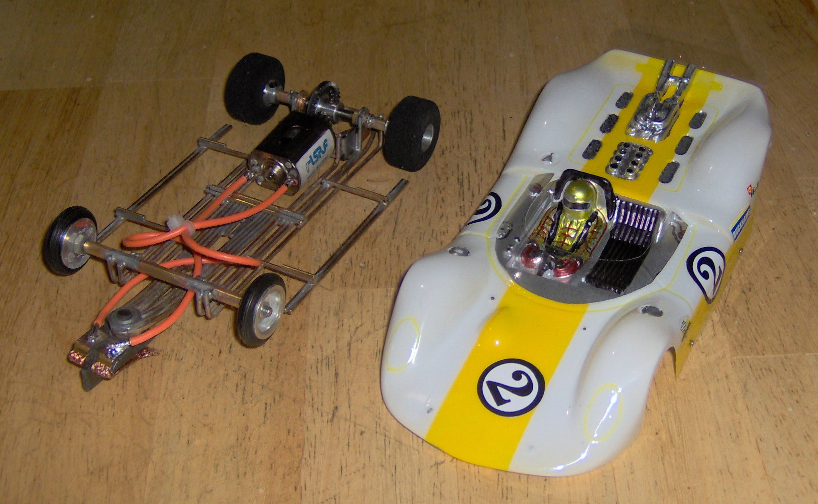

Posted 05 June 2009 - 04:32 PM
Well, here's what I've been workin' on, lately....
Two people who I've known forever ( identity kept secret, to insure they won't get harassed by chassis-hungry thieves...) specifically requested that I build them two ( 2 ) jaildoor chassis, EACH !!
:shok:
So, I sat at my workbench, & built these...
I did learn a few interesting things about building, too....
1) If you want the phone to ring, apply soldering acid to ANY part of the chassis, & it'll ring... :rolleyes:
2) 5th-grade homework becomes interesting only if you're forced to "help" someone...
3) Building chassis is still a better way to entertain yourself, rather than watch the one-eyed liar...
Take care, everyone.... & good racing :good:
